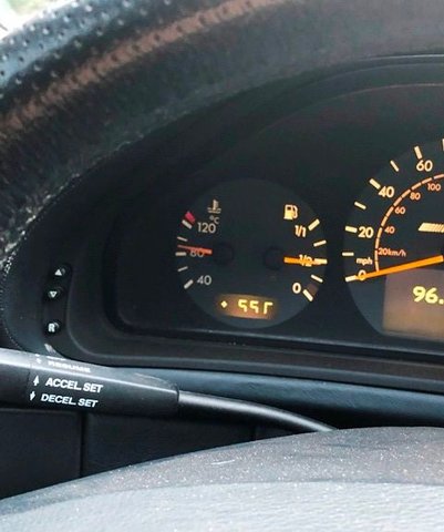

Hi, lately the bottom of the digits on my thermometer (outside) have been cut off. The thermometer is still accurate but I am only getting the top 3/4 of the digits. This is in my '02 CLK55. has anyone else had this problem?

This is a common problem with clusters having the tiptronic display.
You have to replace or re-iron the flat ribbon conductor strap behind display?
Take out the cluster and go to a shop who's specialized in fixing car electronics.
