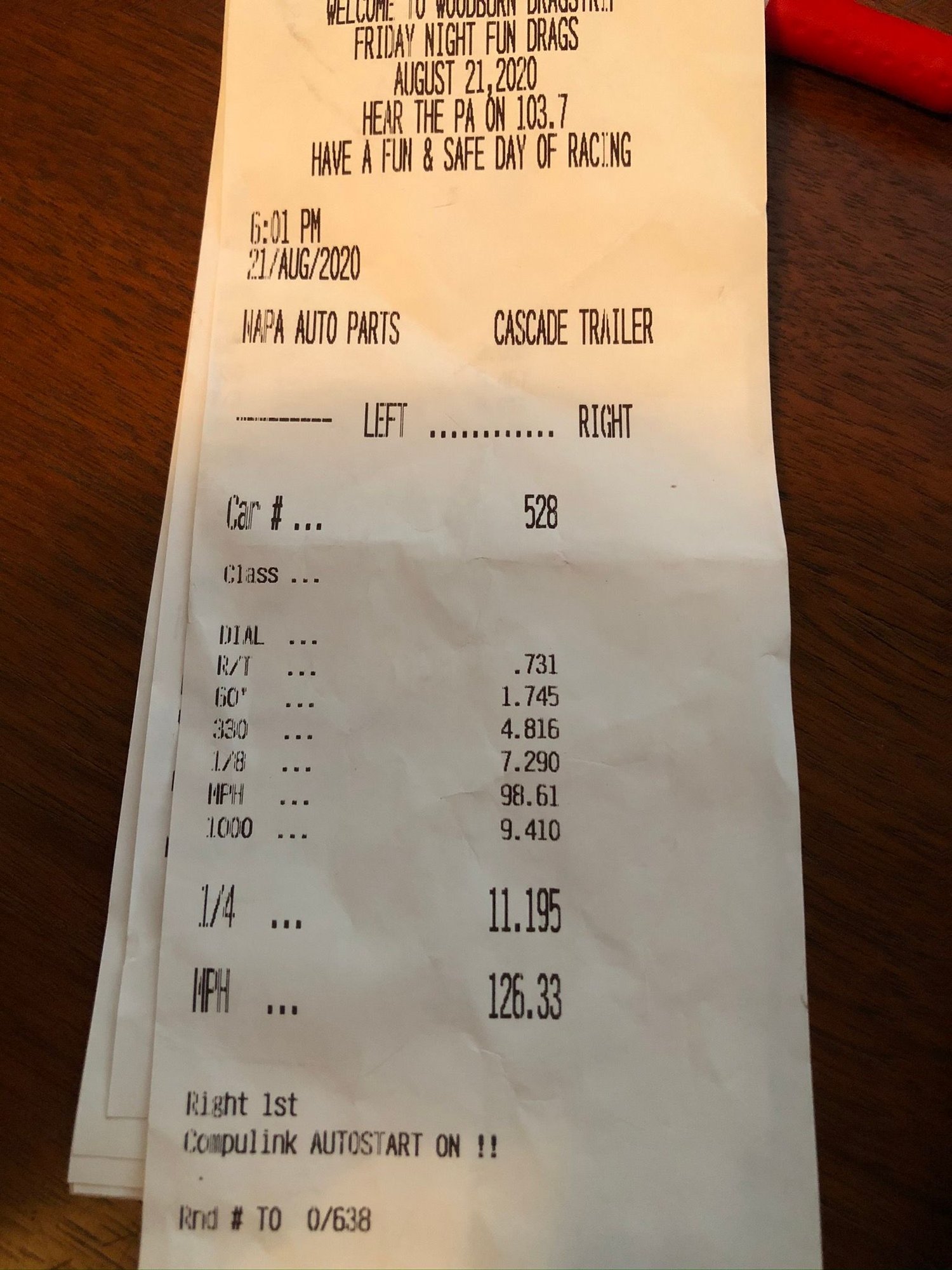

I totally forgot about this thread! The car is running and so far I've made one complete 1/4 mile pass. It did 11.19 @ 126 spinning badly through 1st gear. I've got it setup to launch in 2nd now, but there's no test-n-tune this weekend due to the fires in Oregon. I'll have to wait at least another week to go for that 10-second pass.

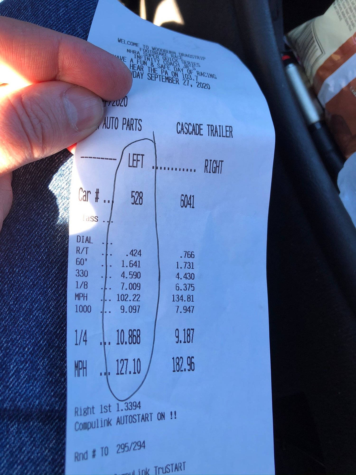

I broke into the 10's today! There's still more on the table; next Saturday may be my last chance to race it this season, so I'll do a little more tweaking this week and try for something closer to 10.50.

Got to get that 1.45 60ft

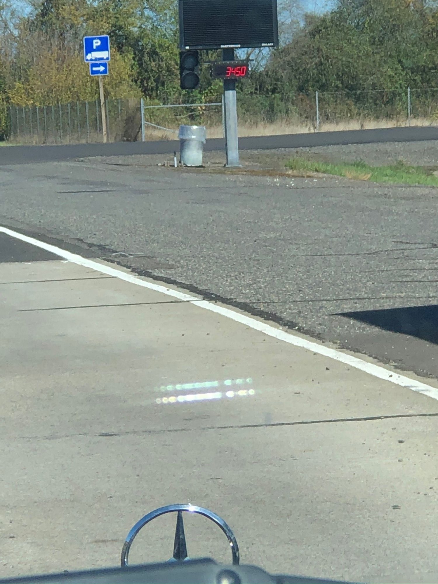

Have you weighed your car? makes 580whp??

Yes, I actually weighed it on the way home from the track yesterday. The truck scale said 3450 with me (200lb) in the driver's seat.

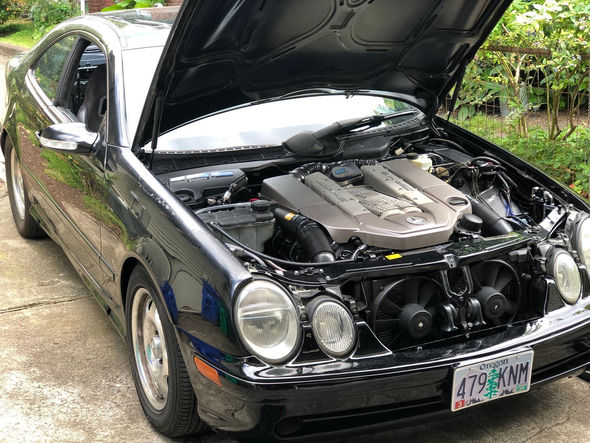

Nice Joe! I didn’t know that you had gotten the 113k installed already.
