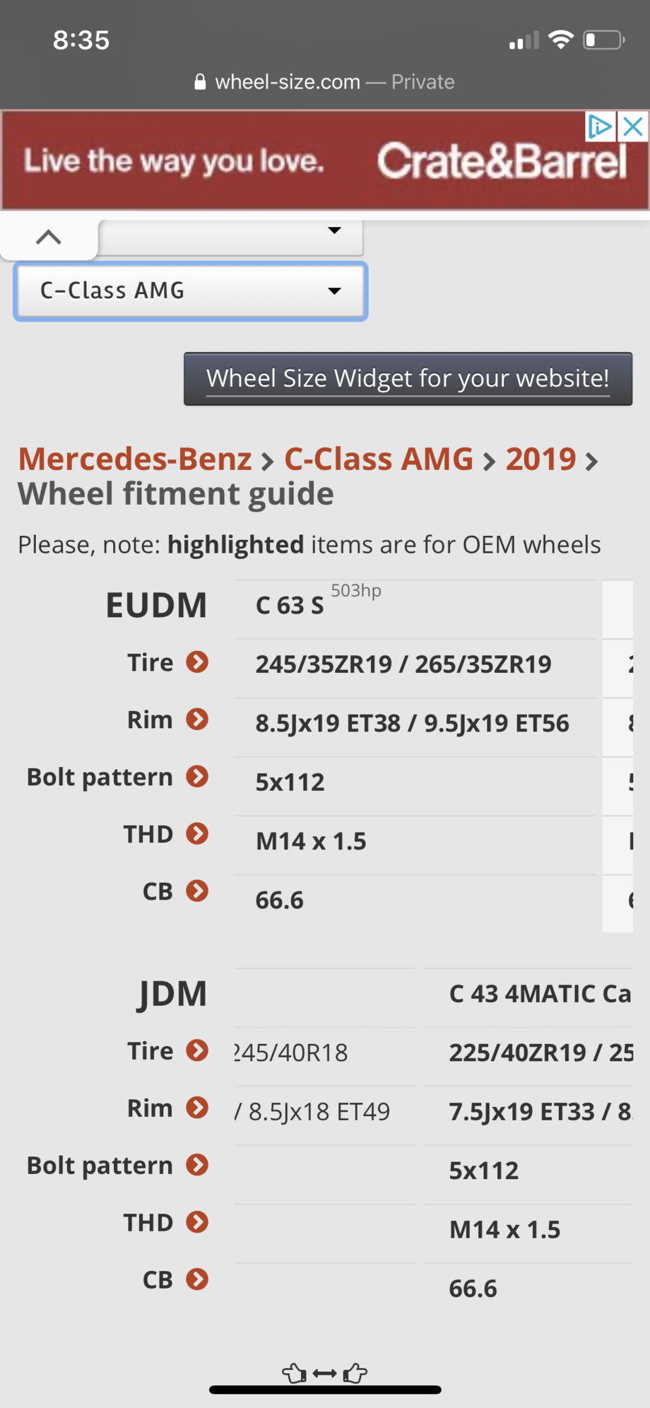

considering increasing wheel size as well. More than anything I'd like to reduce weight. I recall you saying you run a square setup. What is your size?
I'd really like some c63s AMG 19" wheels I wonder if that is possible

no i run 245/265 tires, the wheels are 18x8 et 30 front and 18x9 et 35 rear. what are specs on the c63 wheels? they might have too high offset.

I think you might be right

rear will not work, offset too high. generally, you want stay around 7.5-8.5 front and rear between 8.5-9.5 w/ offset 30-35.
