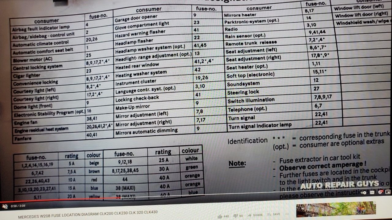

I bought and replaced what I thought to be the proper fuses but still no AC blower or horn. Image of replaced fuses attached are circled.
Any help would be appreciated.

Also, here's the Fuse designations
