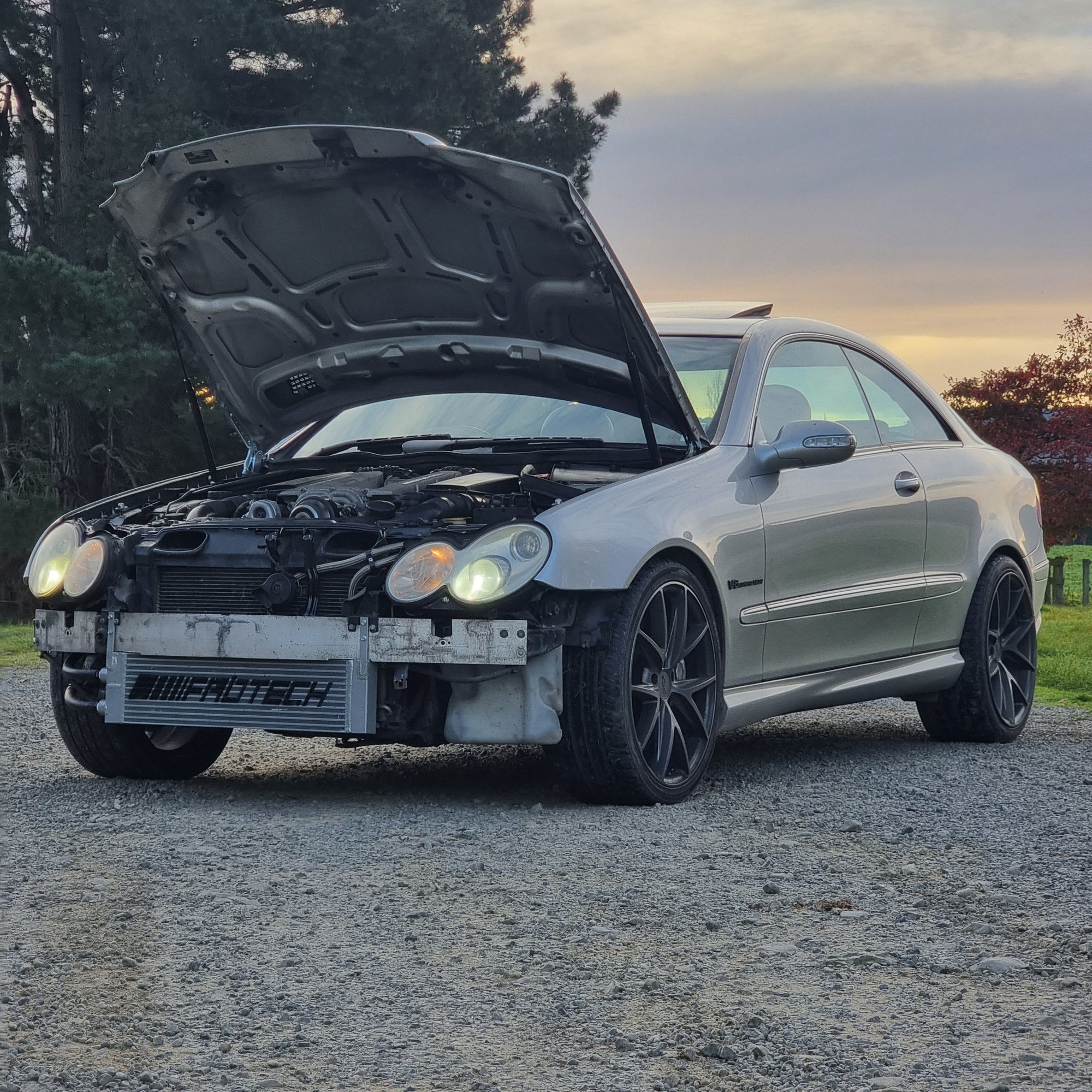

Hey, long time reader, first time poster so I'll do a wee intro
I have owned this car for a few years and it actually used to be @NardoNZ car when it was first brought into nz. In the time I've owned it I have supercharged it with a full m113k motor and box out of a s55 I picked up cheap and the car has spent most of the time on jack stands between the conversion and blowing the diff and redoing the whole rear end while I am there
Anyways, Quickly ended up destroying my diff spider gears and damaging everything else inside. I have ordered a HAG215 wavetrac lsd and have been told by my diff builder that it is the wrong centre even though from everything I have read it should fit the diff!
Not to sure if it would matter but the car is a 2003 and the early run model of the 209 clk55. He also had a look at the c32 amg rear diff which I have and it is identical to my 55s diff
Not sure what to do now as I can't find any info saying the hag215 wavetrac won't fit my car but my builder is saying the complete opposite......
