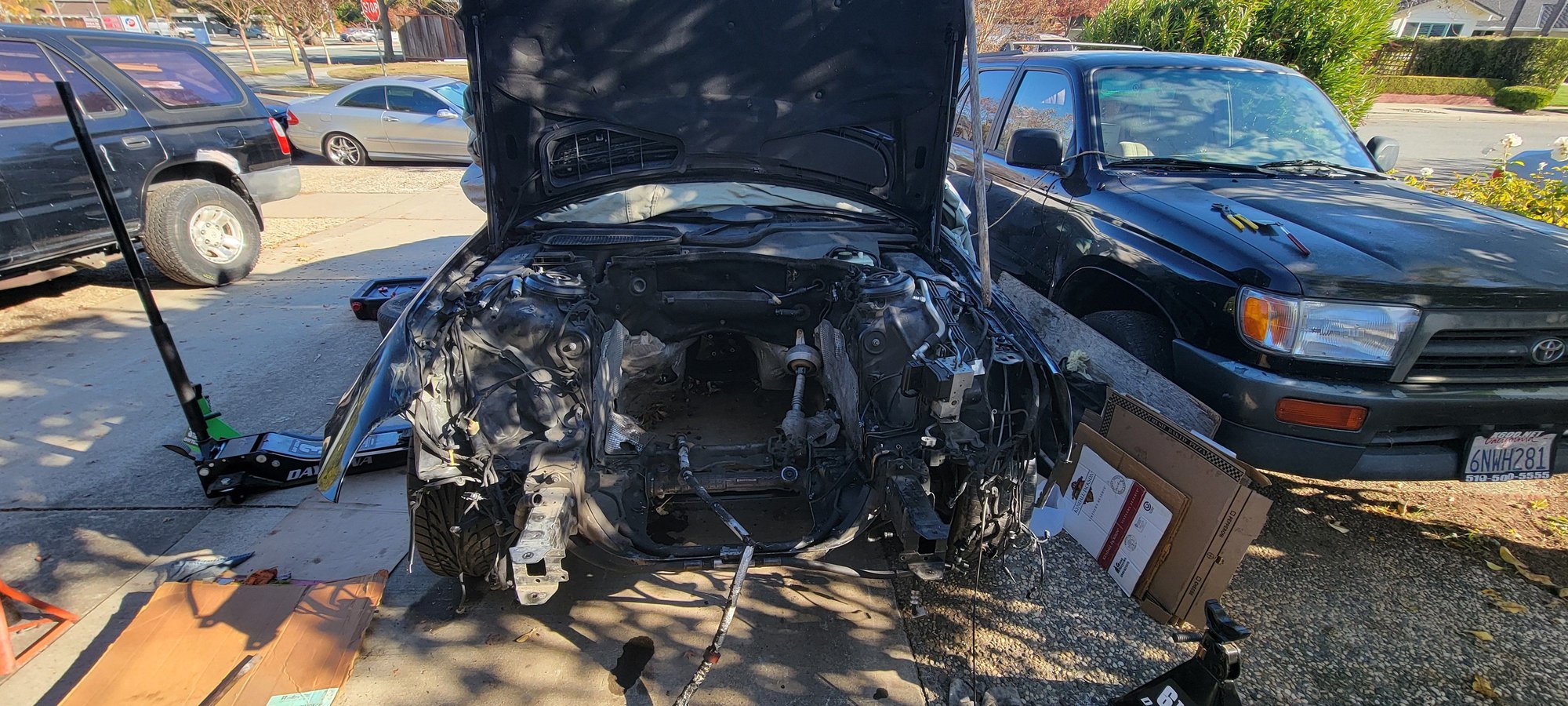

Hello everyone. I have a 2005 clk55 coupe that I am currently in the process of swapping an m113k into. Goal is fastest clk in the world, eventually. Wanted to start this thread to log my process in case anyone does something similar, and to keep track of my process. Currently have done some maintenance on it but besides that it is bone stock. I have an Instagram set up for my build as well. Project_.55

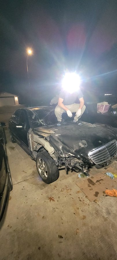

Pulling the m113k from a doner crashed s55 I bought.

Thank you! Just finished building a work table, finishing up a gasket list then the tear down process starts on the m113k

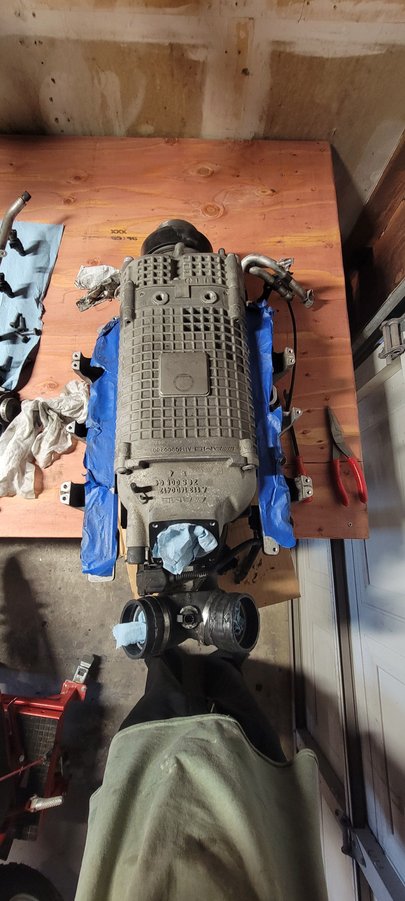

Finally pulled the supercharger, labeled the wiring harness and cleaned up the block a bit.
