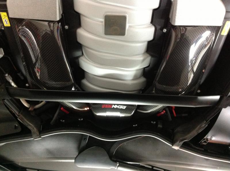

Renntech sound pipes and CF air box with BMC filters
Had the sound pipes installed and I installed the Renntech air box. After having seen and installed the carbonio CF air box, I can tell you IMO the quality of the Renntech is far superior to the carbonio. However, the install requires a little more me mechanical skills. I can't believe how MB had what is essentially two filters on each intake. It must really choke the air intake.
I also purchased the Renntech ECU and will be removing tomorrow and shipping it for he flash. Can't wait to feel the difference. In power after its installed.

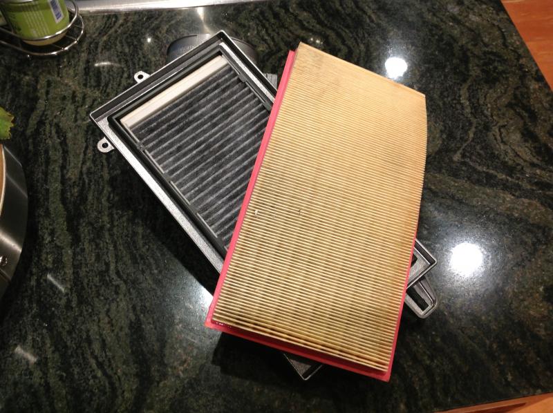

OEM filters
Forgot to include the before shot
Attached Thumbnails Renntech sound pipes and CF air box with BMC filters-image.jpg
