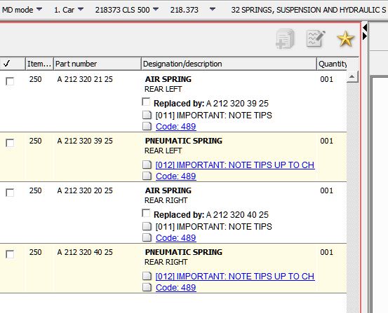

Confirm they installed new OEM air spring, current part # 2123204025 - see attachment. They need to pull fault codes using MB STAR (diagnostics). No codes, next step check for leaks.

Thanks! I've just checked the invoice and they've put an OEM part on.
I've just found out that they replaced the driver side so it's not the part they replaced that's failed, my memory isn't what it used to be!
