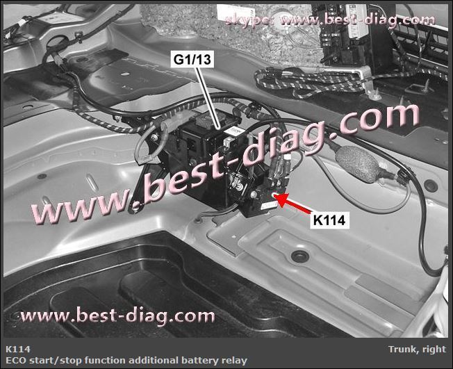

ECO battery in trunk may need replacement if fine, have someone pull/erase codes (battery relay could be failing) and check for COMAND CU (head unit) software update using Xentry (MB diagnostics).
