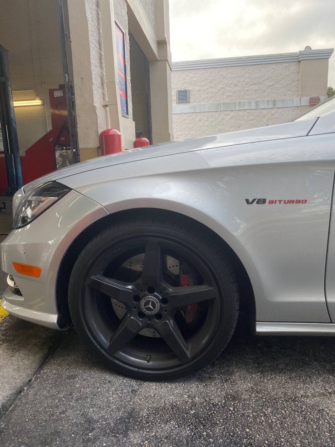

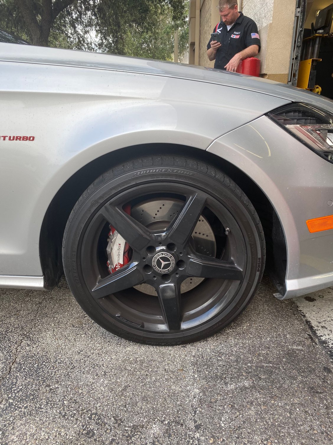

Just got back from place and they blamed it on the pads and my parts of course I knew they were going to do that, now I still think they were either installed wrong or I was sent two of the same side. I took pictures to show that the holes in rotors on both sides are going in opposite directions don’t mind the ugly calipers lol getting resprayed as soon as I fix this brake issue lol
Front left
Front right

Think the cross drill pattern in your front rotors looks just like mine. I have Brembo rotors too. I had big problems with vibration after first install. Was given a replacement set by online seller and no probs after that.

I don't know anything about the squeaky brakes but yours looks the same as mine (the rotor direction, not the calipers :p )

Those calipers are killing me lol I’m going to get those and my one scratched wheel finished at the same time here soon but the brakes and the way they sound right now are even worse. So your rotor direction is to the back on the left and to the front on the right ? Just looks off to me but I’ve never really paid attention.

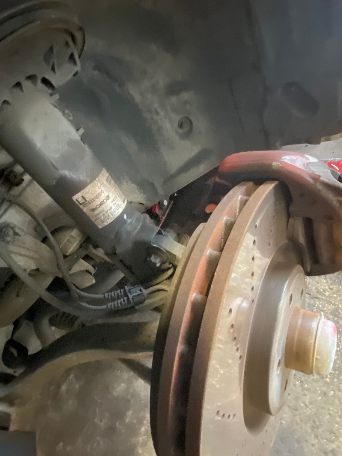

I
These look a lot older than 2 months
these are only 2 months old apparently I feel like they never changed the rotor when I checked the backs they still have some shine, no rust like the fronts and they were done a week apart, I’m hoping they didn’t just charge me and not change it all. I’m going to drop off at my Mercedes mechanic Friday for a trans flush so I will ask if those are the oem rotors bc if they aren’t the brembo ones I gave them to install we have a big problem but once again I don’t know if that’s normal rust for two month old rotors. Thank for input guys

It that a lip on the inside diameter of the rotor? In 2 months you shouldnt have that. Is there brake grease on the back side of the pads?

looks to be a lip there and that’s exactly what a local mechanic said, he stated should not see that after two months. The place that did it claims the pads are bad? And that’s not grease it’s actually brake dust.
