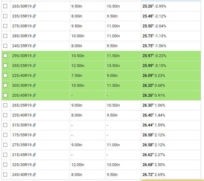

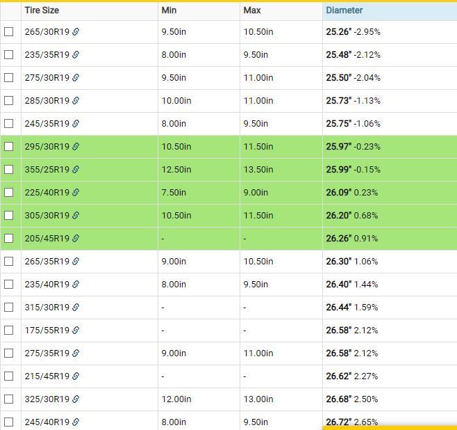

Also it seems to me that you've measured a bit wrong the overall tire size. Any way around, use the site above and you'll get all the information you want, besides the actual fitment. For that you might need to research separately, on site below, they show a pretty good chart with all sizes that fit your car. Enter on the left all the information about your car:
https://www.1010tires.com/Tools/Tire-Size-Calculator
Here what it shows for front:
and rear:
Regards.
