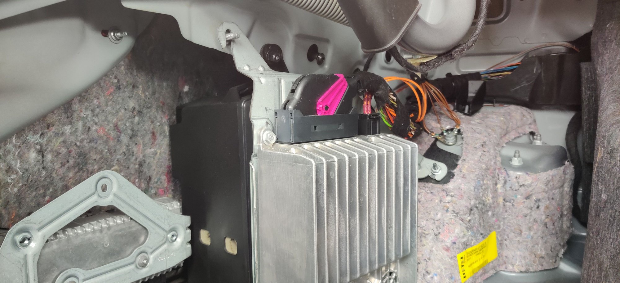

So my active multi has not worked in a while! So I decided yesterday to Snoop around and try to figure out what's going on with it. I started in the trunk and checked the airpump, air hoses and connection. Everything seems to be working, the pump is is working and pushing air. If the air reserve tank, pressure valves and hose connection and everything was fine. I also checked the fuse box and again everything is good. Next step is to check the seat connections ( I don't know where to start with the seat ) check the control unit and the switch it self. Yes I have lights on the switch but it dose nothing! None of the functions works.
PS: the passenger side seat working fine ( there is air going there somehow. I took many random pics if you guys wanna have an idea of what is there 😉

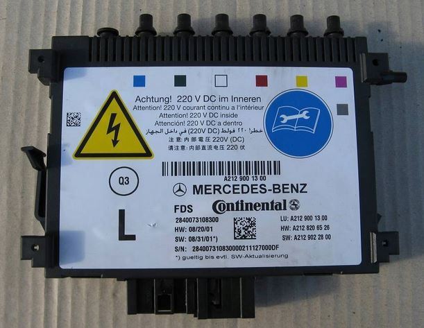

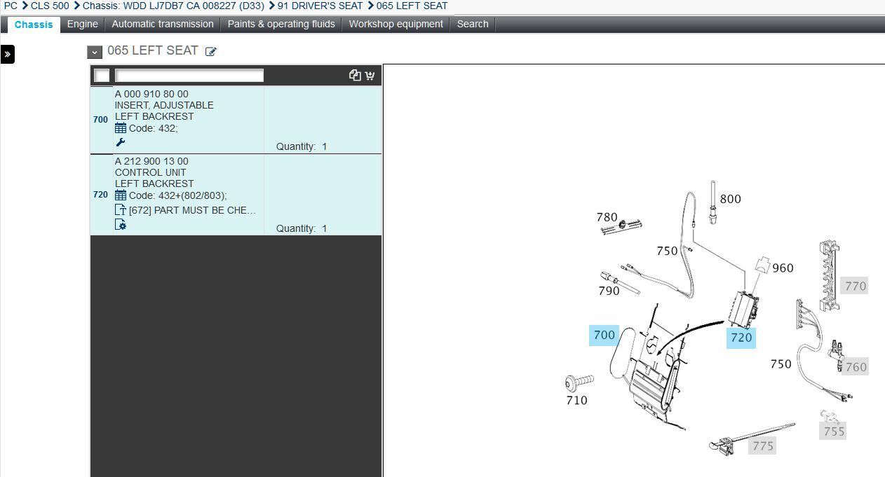

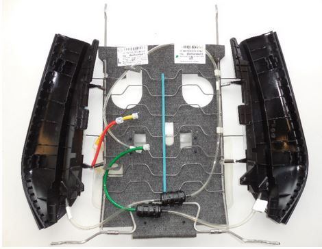

Check connections @ seat control valve all fine, need to access/check lines & control unit.
Thank you so much for this! It will make my life so much easier when. I pull the seat off. Also, so you have another PDF on seat removal? Much more where do you download or get the pretty installation PDF guide?

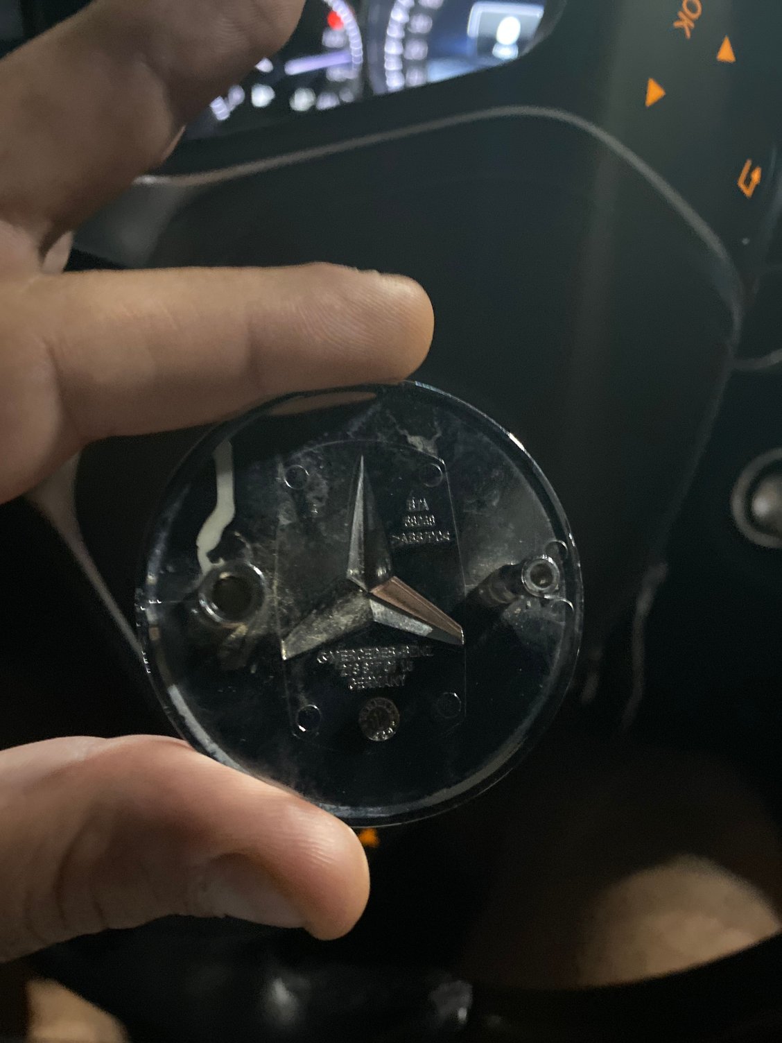

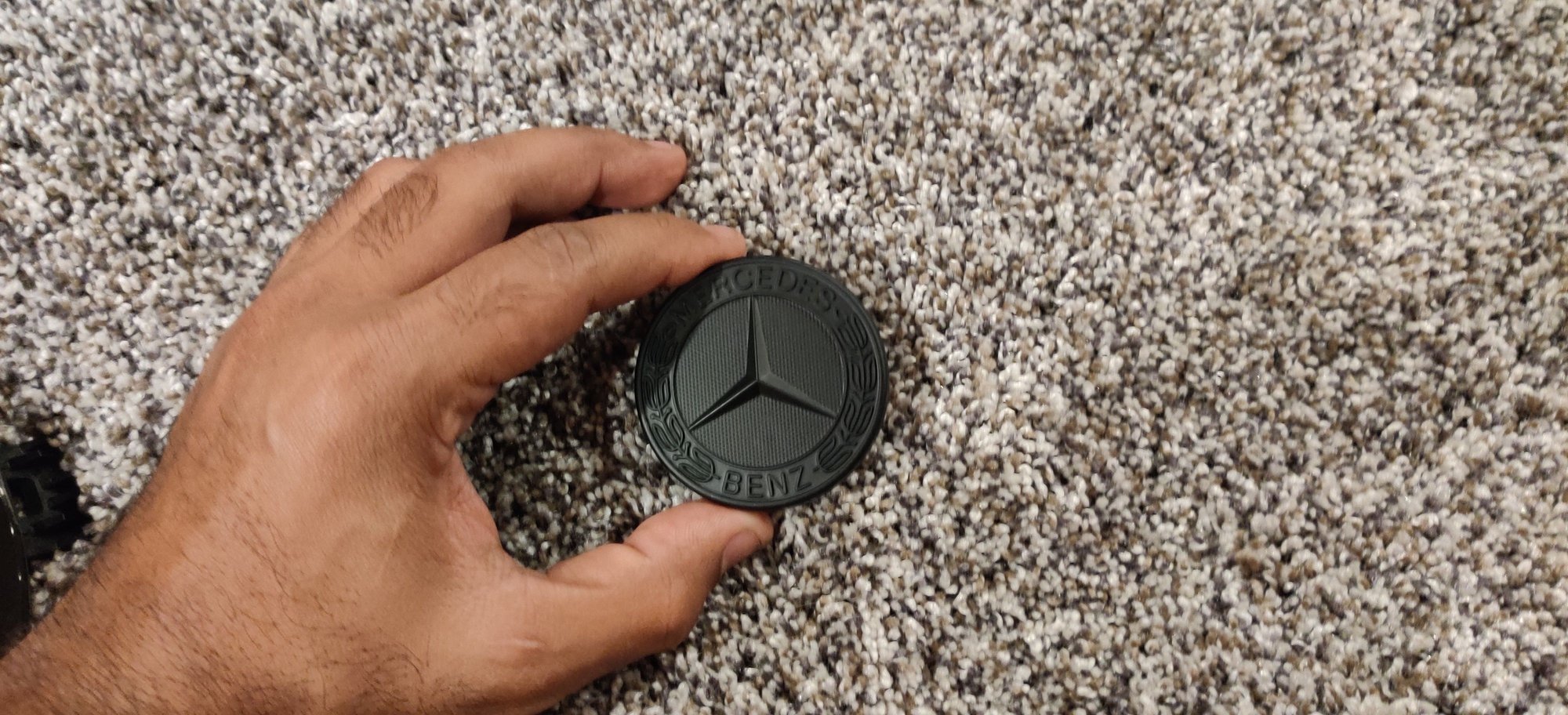

no distronic issues. I have a black hood emblem that im trying to install to replace the original one. Behind the star is the access to that
on my 2014 I just popped off the hood emblem with this auto trim kit https://www.amazon.com/dp/B07R44VJHN/ref=cm_sw_r_cp_api_i_BV-bEbQ9PZ4PK
without doing anything through the grill even though that’s what I was told to do at first but I did replace my grill emblem as well and that was just push in and turn counter clock like Marv was saying

@Tbbt CLS so it's not a twist and turn it clipped and will need to be pooped out. It might be different in another another car but in mine with distronic plus that's how it comes out lol 😂 now you know
@Dblok1113 I think we are talking about something different. I think I gave up on this since there is no access even from under the star. Everything blocked and there is no access 😡 I even removed the radiator cover
Don't let me get side tracked with star since I'm working on the seat
The back of mine is different as well I kept getting the ones like yours with the clip but when I actually popped the hood emblem off this is what it looked like

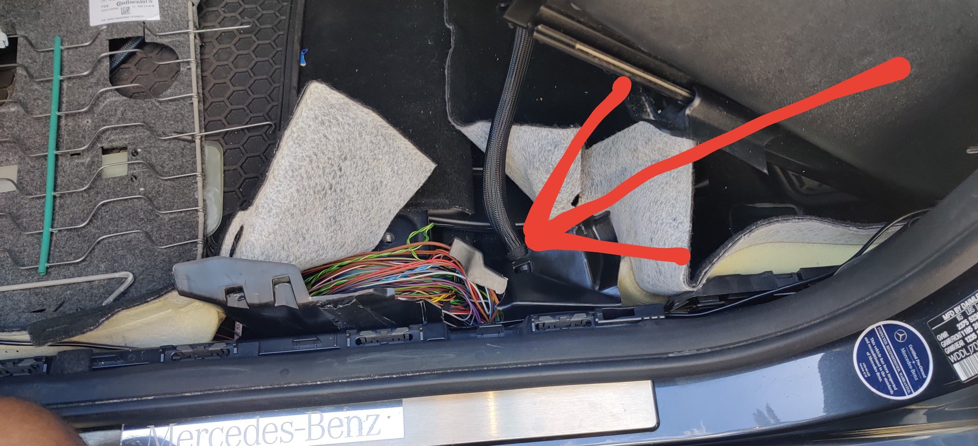

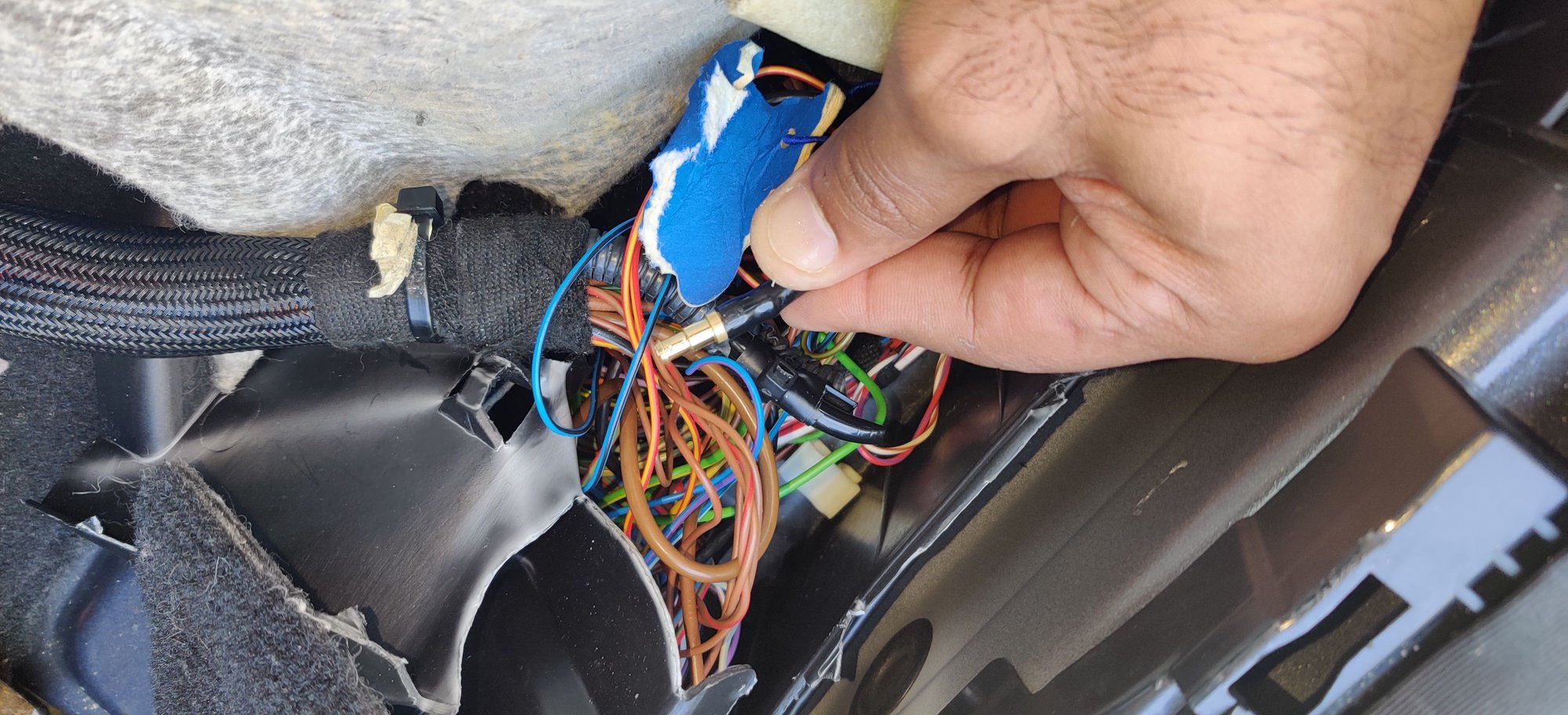

So finally got a chance to remove the back of the seat to inspect the connections module an electrical and socket connection. Everything looked just fine and there is air coming from the pump as I tested it using a glove as a balloon. In one of my test i kept the car on then unplugged the wires from the module and pluged it back in once it's plugged back in the pulse lights will come on and STAYED on for while AND heard the seat trying to use the massage option. It it sounded like vibration mix with air or something. I can't really explain it but I know it was trying to work. In my second test I asked my wife to sit on the seat and I conducted the unplug plug test and she claims at one point the bottom of the seat moved.
so now I assume it's either the seat control switch or the module itself that is defective. I wish if there is a way that my star diagnostic and tell me which one of the two is broken or need replacement. I'm gonna look in eBay and see what I can find
This is the wire I was talking about as far as plug unplug
Also an FYI for everyone since I didn't find any information on on backseat remover. Well it's as simple as yanking from the bottom then pulling down to free the middle and top hooks

Backrest cover.

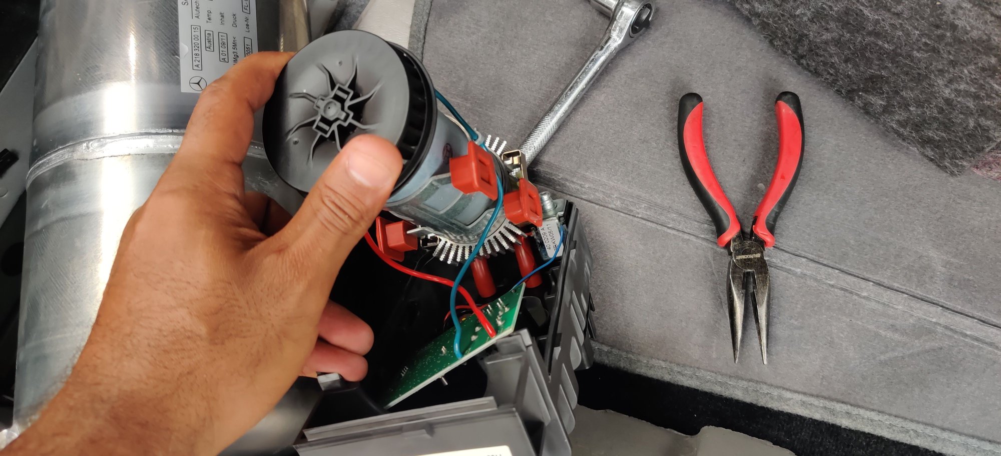

I found it I found it I found it 😁😁 finally and after so much time and 💰 I found the issue with my multi-contour seats option WELL I found half of the issues 😑 and I think I'm going to give up now.
So today I took everything out. I disconnected the pump again and replaced again it then Inspect it again. I know it was not the pump or the tank but I just did everything all over again to be sure. Also replaced the seat module on controller although I also knew it wasn't that because I've checked it before. So I finally went ham and followed the hose back from the trunk to the seat, which meant carpet out, side panels out ,and the front seat had to come out too. At first nothing looked out of place until I stared to look at the area where the hose and wires leave the harness and migrate to the seat as shown here with the red arrow.
In there the "black" hose from from the trunk pump turn in there and connect to the bottom of the seat. The hose is located inside a wire harness sleeve then it moves into the main harness sleeve going to the seat. WELL the hose was bent inside the sleeve so I decided to slice the sleeve open and look inside and tada!!!! Found it the hose is pinched big time.
So I slices it open and sure enough it was pinched and twisted.
So I tired to heat it up and smooth the hose which in return allowed the air to " temporarily" flow and there for it worked yes the seat function worked 👍 but the hose went back to the pinched form that was shaped by the twist and the seat stopped working again.
​​​​so I came up with a temporary fix to allow air to flow until I can think of something better. I used two zip ties to reshape the hose and it seems that it worked for a little bit but then it will stop working after the car is been on for about a minute. However when I turn the car off and back on it will work again. Its like it's trying to reset it self or something.
So as of right now I still need to find a permanent fix so any ideas you have please let me know. The other thing is why does the multi-contour options will working after a minute of the car being on? Thinking of cutting the hose and use something like a connector with an elbow to fix that area.

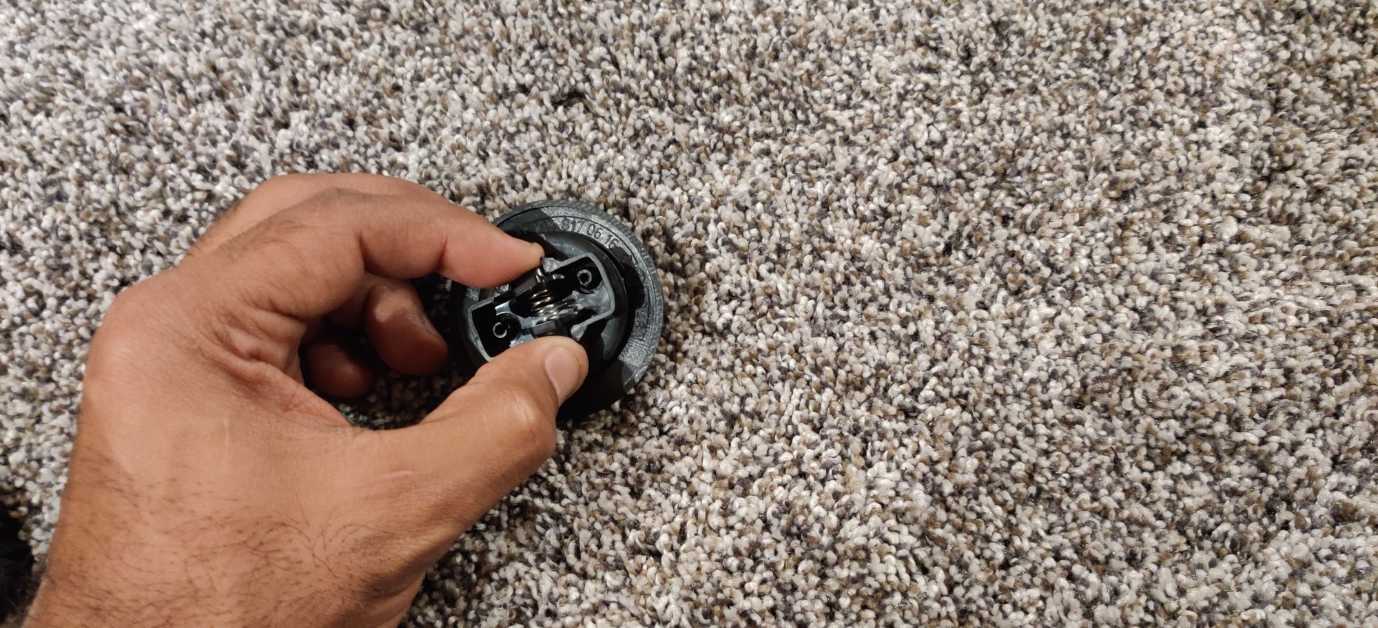

Well, I took another go at it but I hit a block again on this project. When I first started nothing worked at all not for one second not for 1 minute. I have found the problem underneath the carpet box below the driver seat with one of the air hoses being pinched so I tried to fix it temporarily as you guys can see above until I found a better solution which I did.
I bought this
Then I cut the hose where it was pinched and I inserted that piece of metal the connector to fix the pinch. This solved 50 % of the issue. Now I'm dealing with a the common issue that almost everyone else is having. The multi-contour option will work only at the beginning for about a minute when you first turn the car on or put the key in the on position but a min later the pluse light will turn off and ever6 stopes. Most people think that is because the car just started it's not I figured that out as well. It works because the pump at that time it's working and it's pumping air but as soon as the pump stops everything stops the pulse lights will turn off and everything will stop. I checked the connection all the way back to the pump and I really can't see anything else visibly wrong?
Why the pump comes on then off then nothing work after that? This is the question of the day? Can someone help please?

Snapped the hose in the at the pinched spot
Used the connector to link the hose back
Final results
My temporary fix with zip ties ( which worked btw)
The main connection
