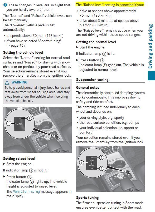

does anyone know if the system still adjusts for load and road uneveness when in the "raised" position ?
the lame system is always adjusting for height when in sport or comfort mode. What about at the "RAISED" mode ?

Raised position is only good for like 15-20 miles per hour, after that it defaults to either sport or normal, whichever you had previously.

I thought it was 60mph before it re-adjusts
