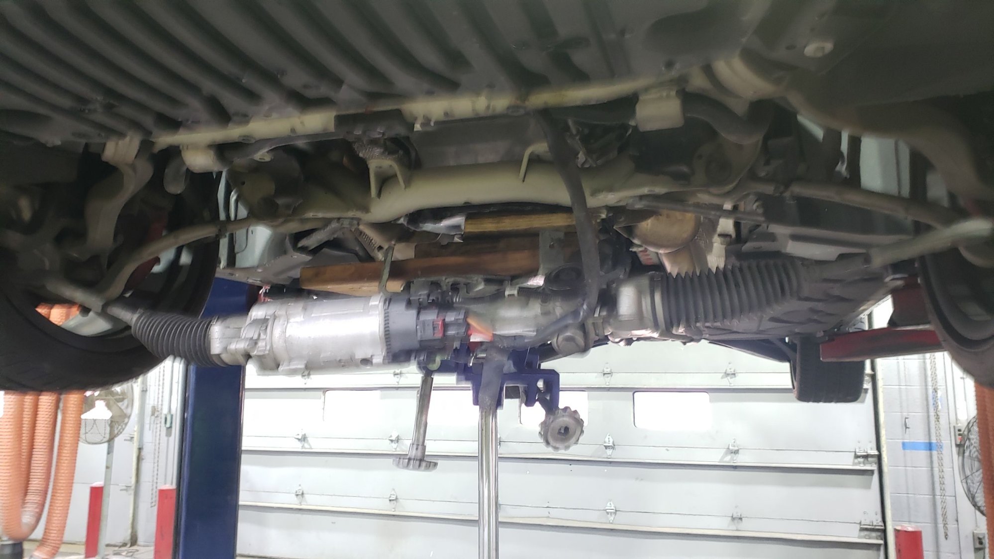

The passenger side was replaced in about 15 minutes by removing it to the rear. The drivers side required me to drop the steering rack. It's 4 bolts for the rack and 1 for the steering coupler. Then it comes out the front. I originally planned to drop the exhaust but this was much easier.

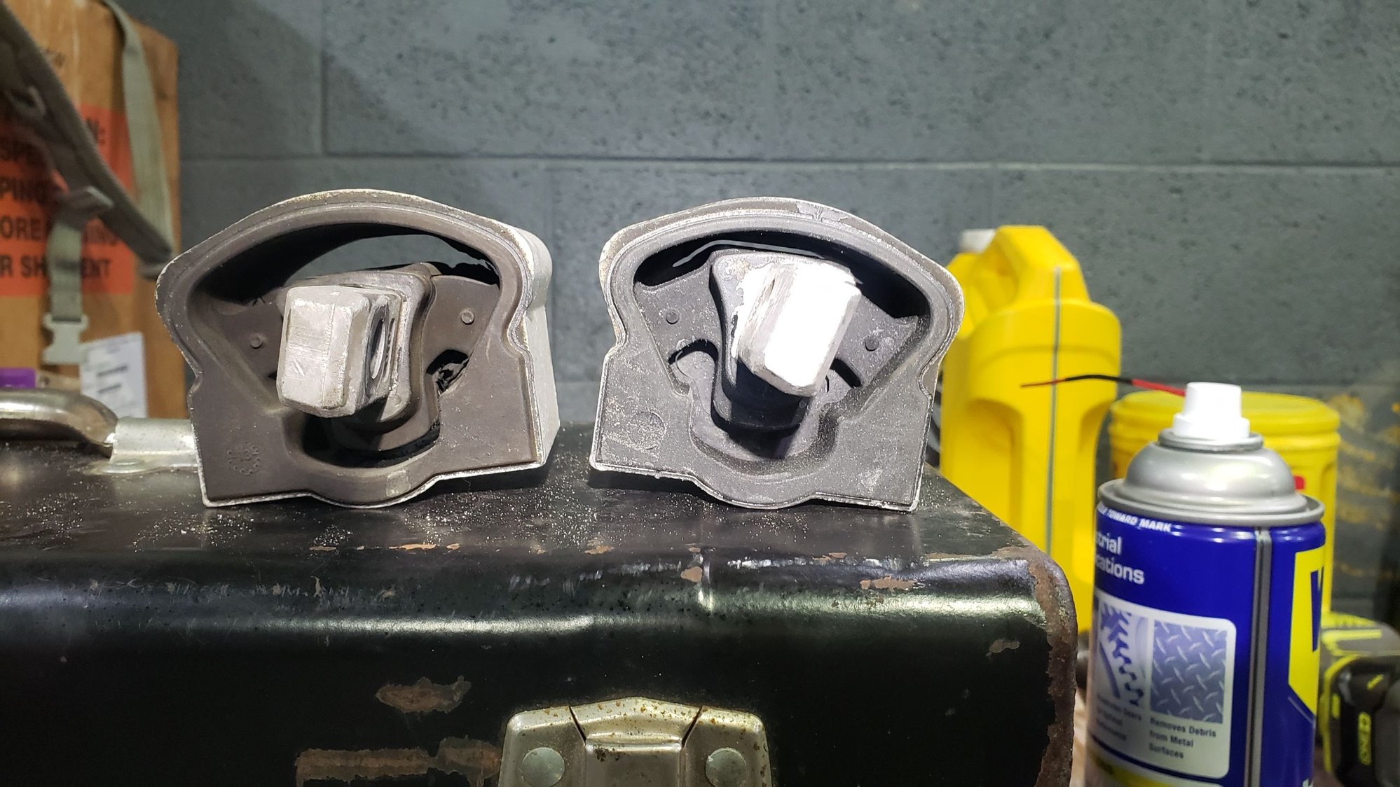

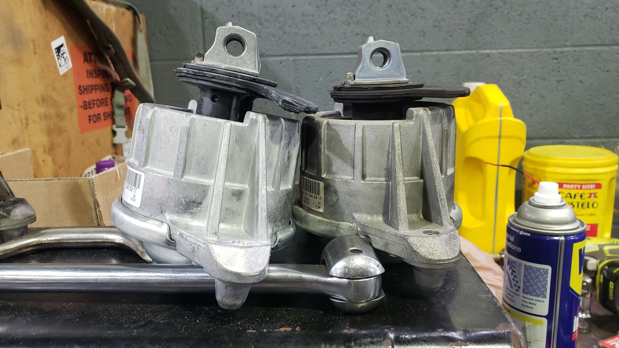

The difference is incredibly dramatic. It eliminated all drivetrain vibration, a small clunk over bumps in sport mode and a clunk when the transmission downshifts into 4th gear. I've done this on several vehicles and I'm always amazed how new the vehicle feels afterwards. The life expectancy of mounts is 5-7 years but replacement is never on any maintenance schedules. Check out the side by sides and how squashed these things are with 67k/8yrs on them: Now for side by side pictures:
New on left side
New on right side
Dropped steering rack
