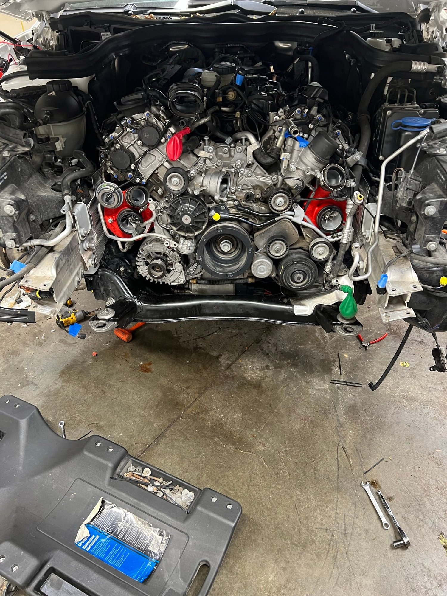

FUUUUUUUUUUUUUUUUUUUUUUUUUUUUUUK here is a bit of info for you.
THERE IS NO MANUAL WAY TO GET TRANSMISSION IN NEUTRAL TO SPIN DRIVESHAFT FOR BOLT REMOVAL lol I had to re hook up all electronics AND Reconnect all the brake lines and old calipers cause it wouldnt detect break pedal depress without pressure in the lines .****
Any way its handled the motor should be out by the weekend

It's your built but I have some proposal what to do when engine is out if u like. I think that HMS bridge pipes will fit also in 550 and I do regret I didnt get them when my engine was out. Second is that install that CWA100-2 pump and wiring adapter and extra HE on passenger side. Those will help a lot to get all power out later.

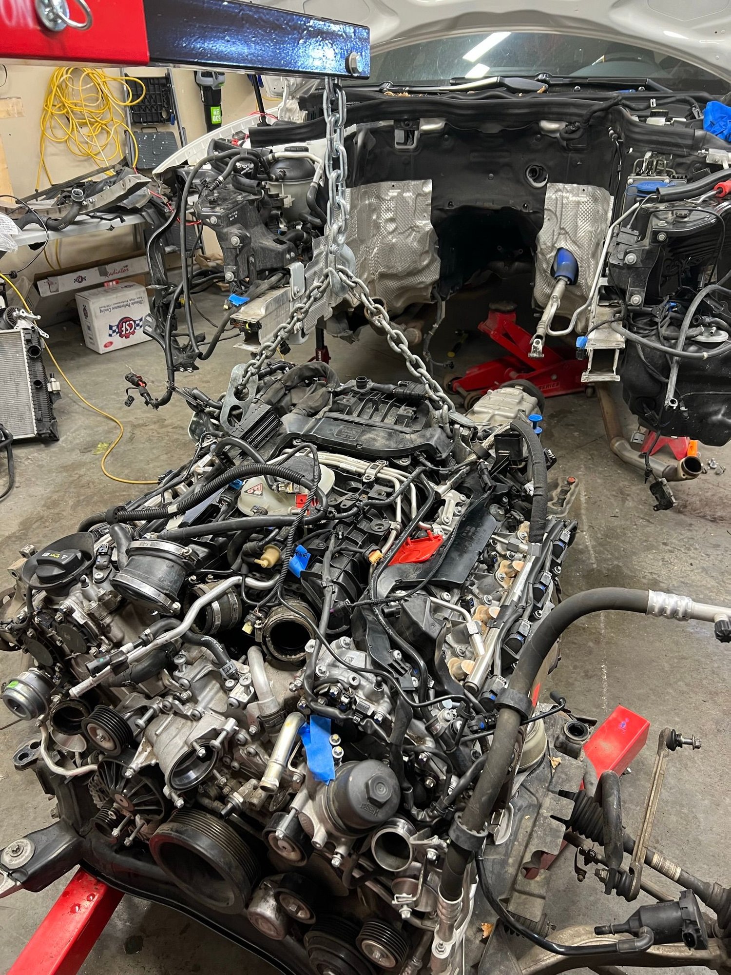

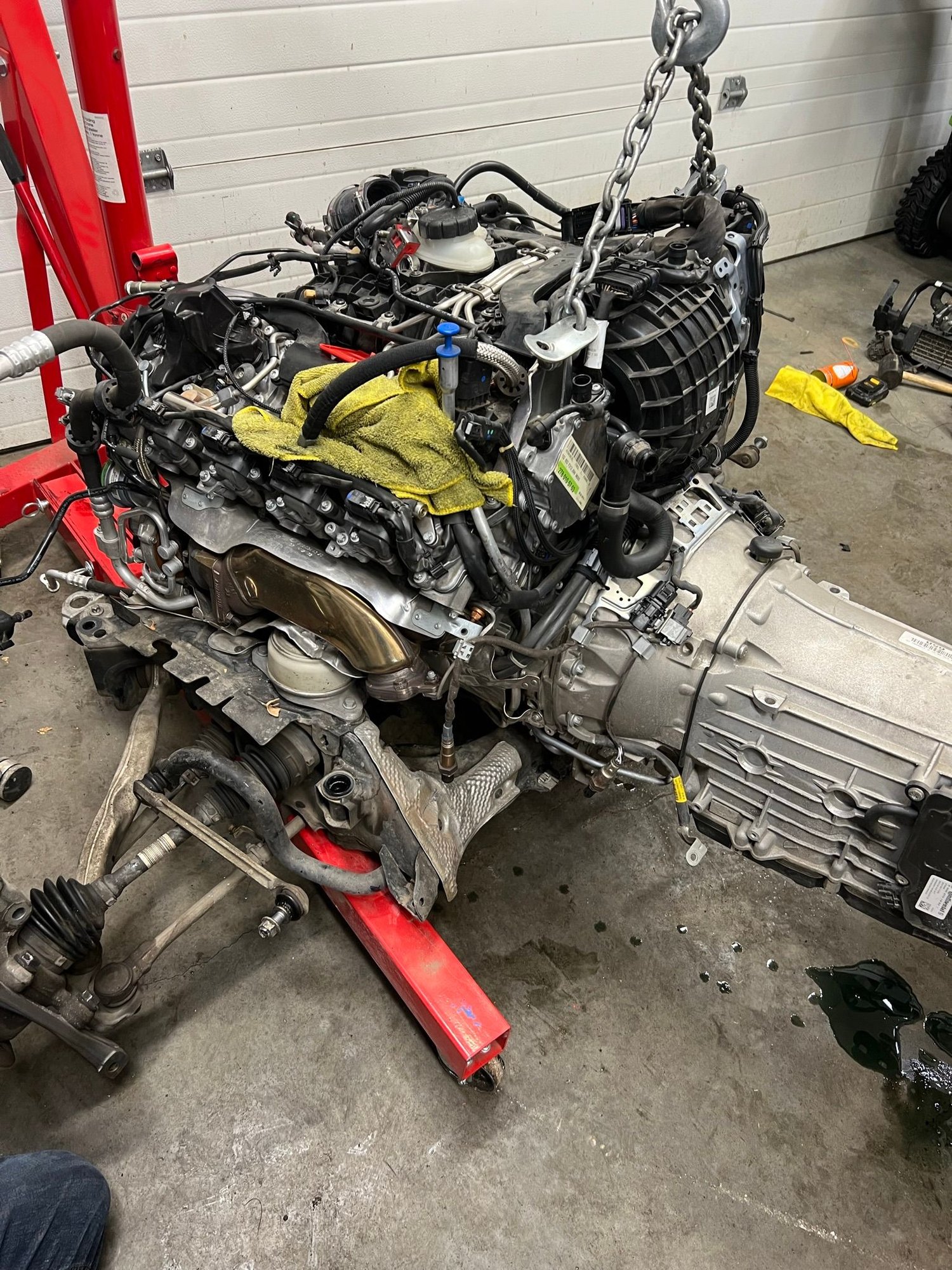

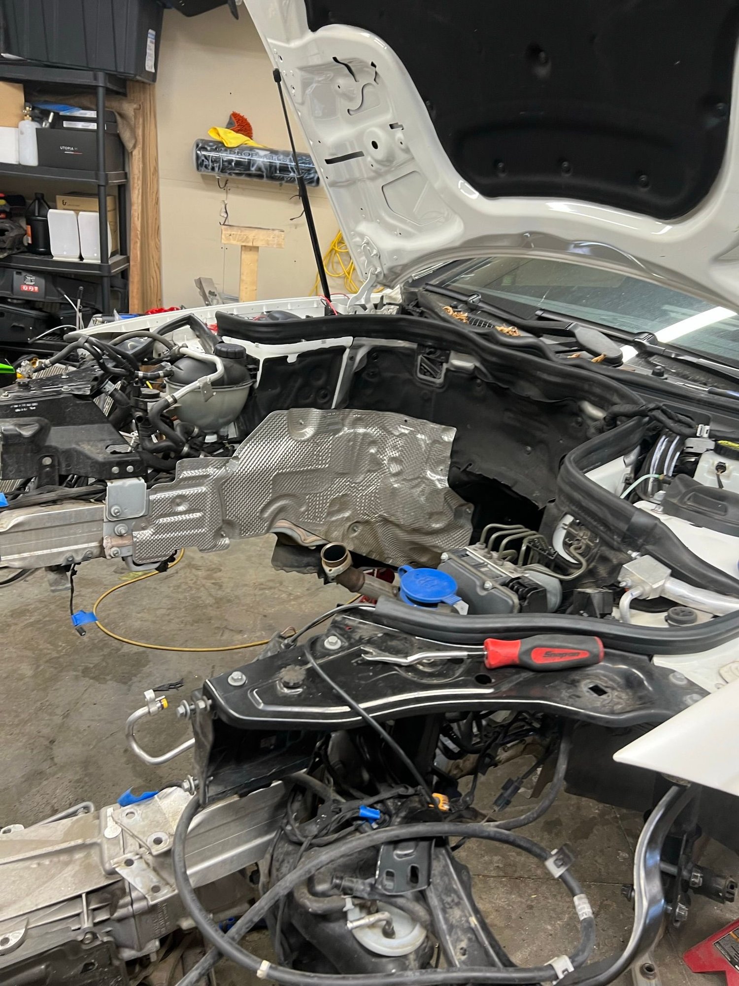

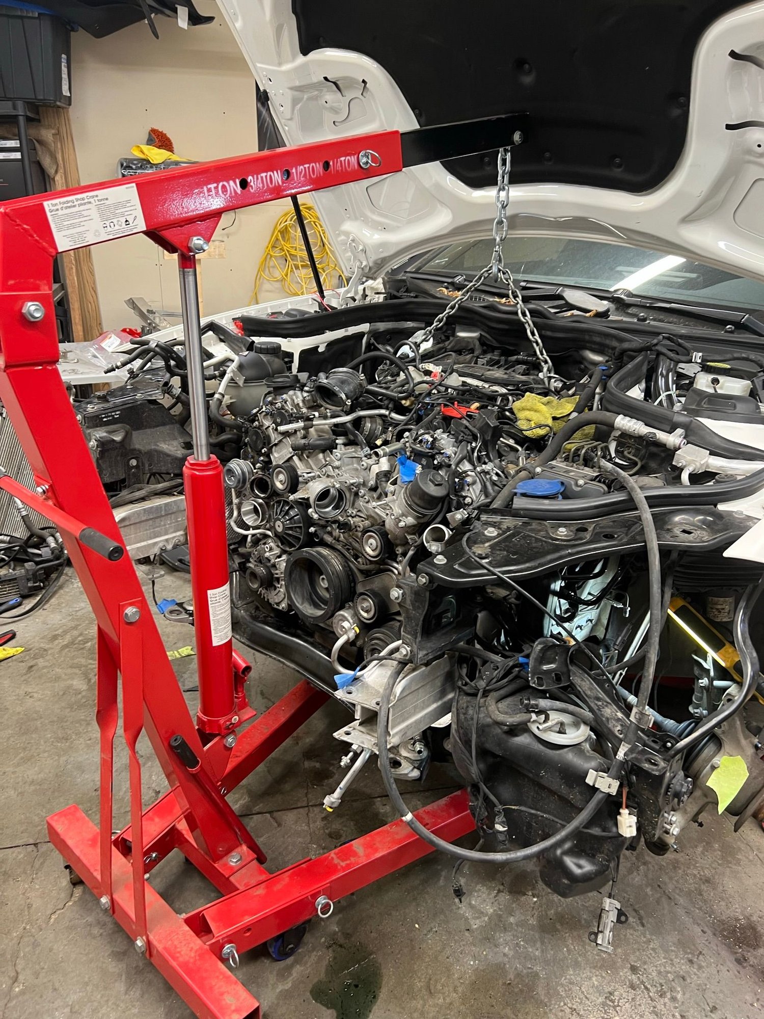

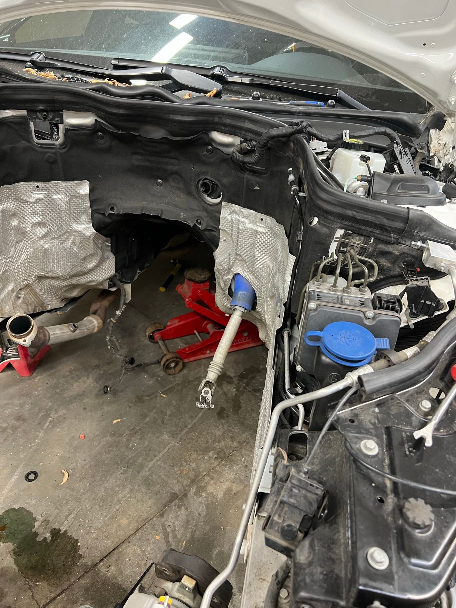

UPDATE!!!!!!!!!!!!!!!!!!!!!!!!!!!!!!!!!!!
Alright well we pulled the engine, once all the the front was apart it was actually relitiely simple for the pull, 6 bolts mount the sub frabe to the chassis, 8 bolts for tranny cross member and 3 bolts for the drive shaft. SHE is a HUUUGE *****.

2012 Mercedes Benz CLS550
God bless you! Gives new meaning to "pulling the engine." The entire front of the vehicle is removed!!!!

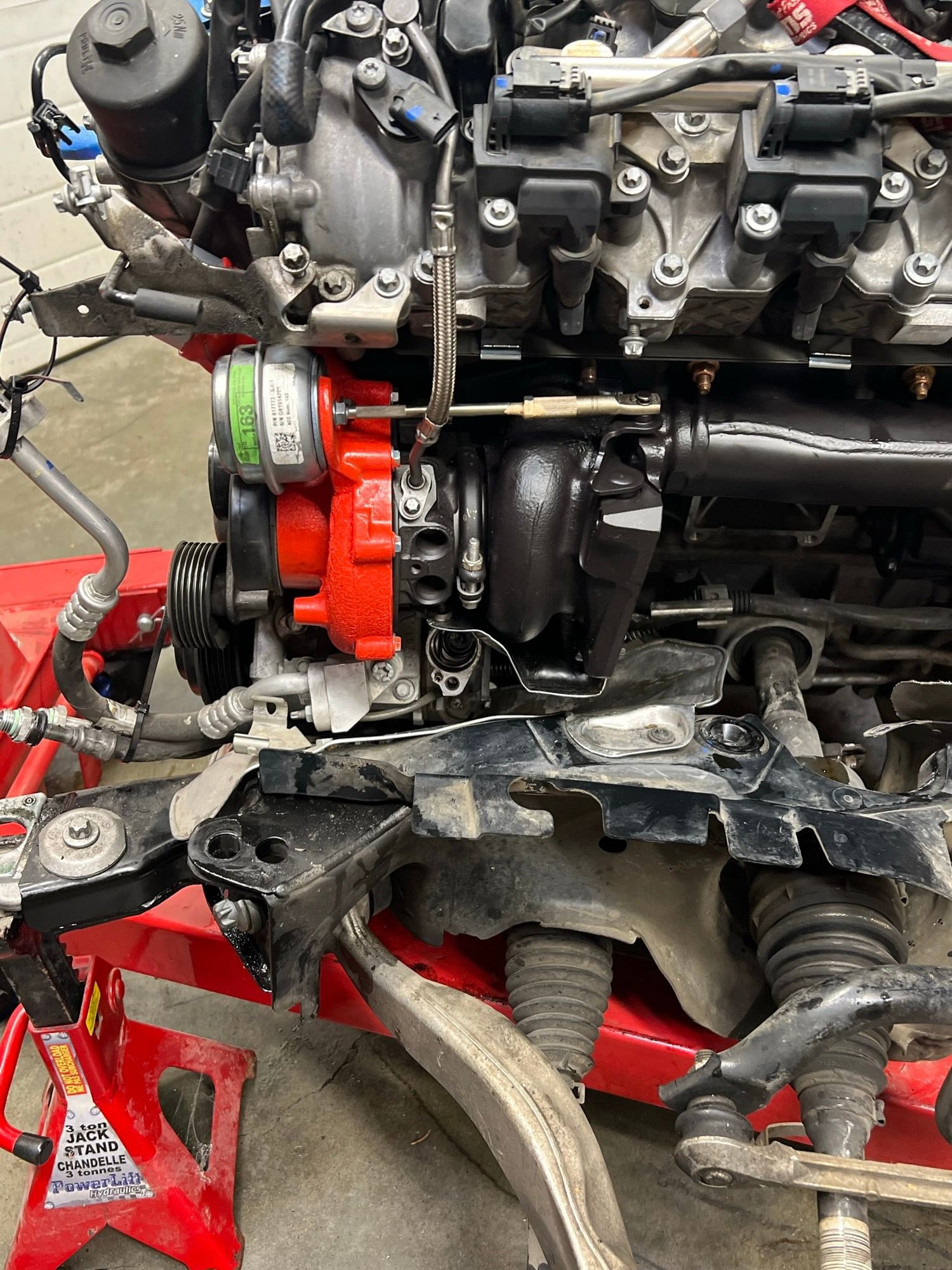

and here are the new motormounts installed:
now there for a M157 and since im a 278 the bolts didnt fit, the thread pitch was wrong, so i had to get different bolts i also had to cut the top of the additional heat shields as the mounts sit extremely tight to the motor itself and would not allow for the increased height of the heat shields

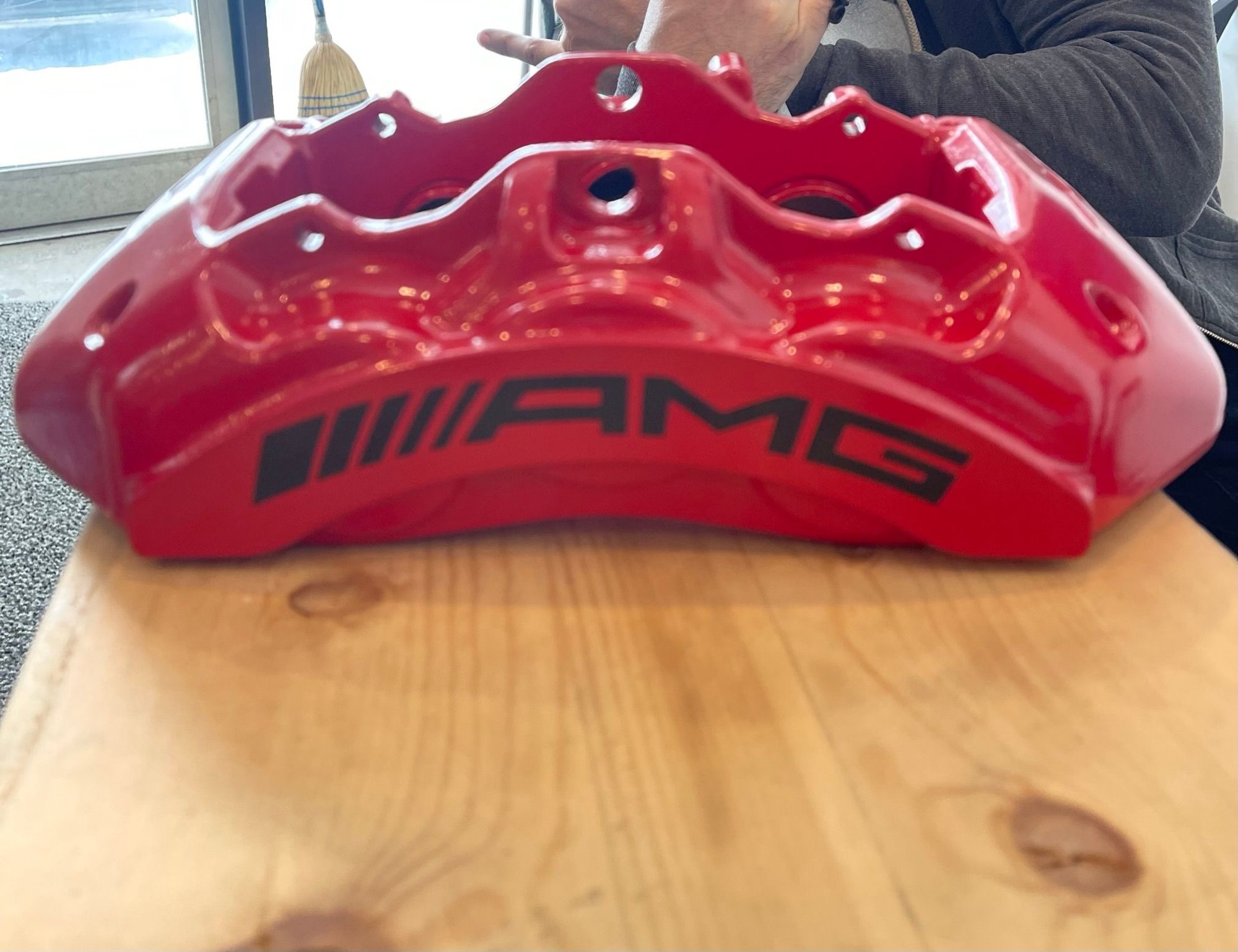

OH and i got the amg front calipers back from powder coating, they turned out great
