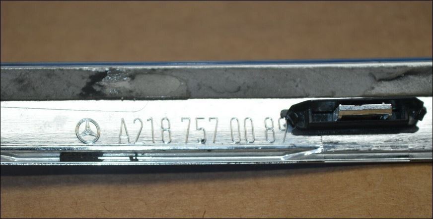

Hey Benzers,
I am looking for the instructions for removing the chrome trim that runs across the trunk lid.
The piece the red line is touching in this photo.
I don't want to assume removing it is similar to other models and videos available on youtube.
Anybody have this?

Part # 2187570089 mounted with double sided tape, tape surrounding area and carefully pry off using plastic wedge.

Thank you!
This is very different than any youtube video.
And thanks for confirming the trim part number. I might break it!
