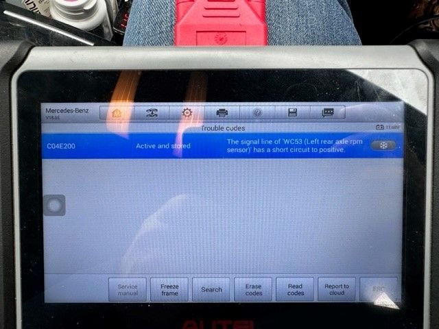

My 2016 CLS 220D has thrown up an error for the rear left wheel speed sensor (from the diagnostic check) also knocking out cruise control anti collision and my ABDS brakes.
I got a sensor off the shelf as the main dealers had no stock.
this OTS sensor put the can into limp mode
any one of you kind people suffer this on you MB and if so am i best going to the main dealer and buying an MB sensor
