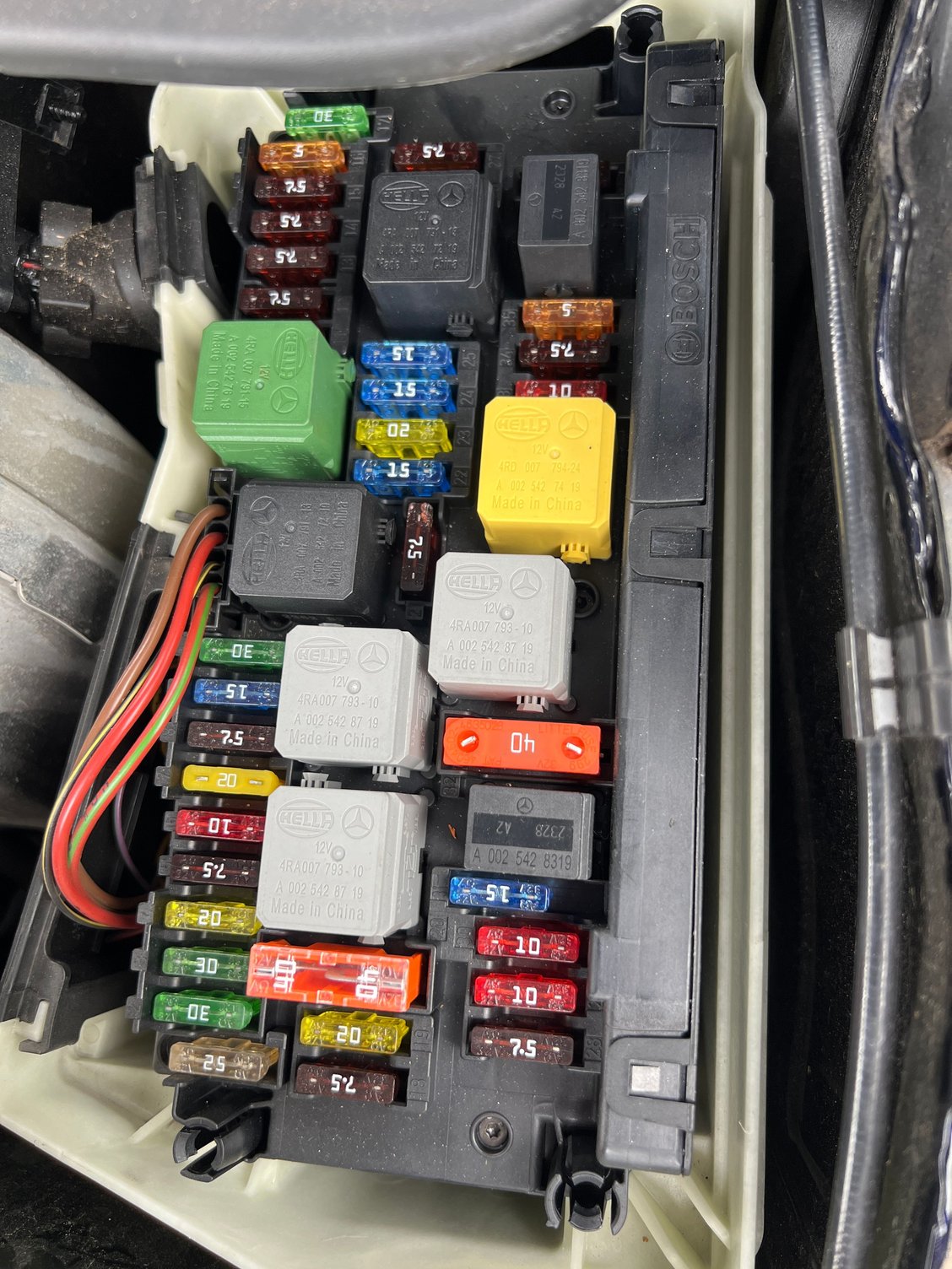

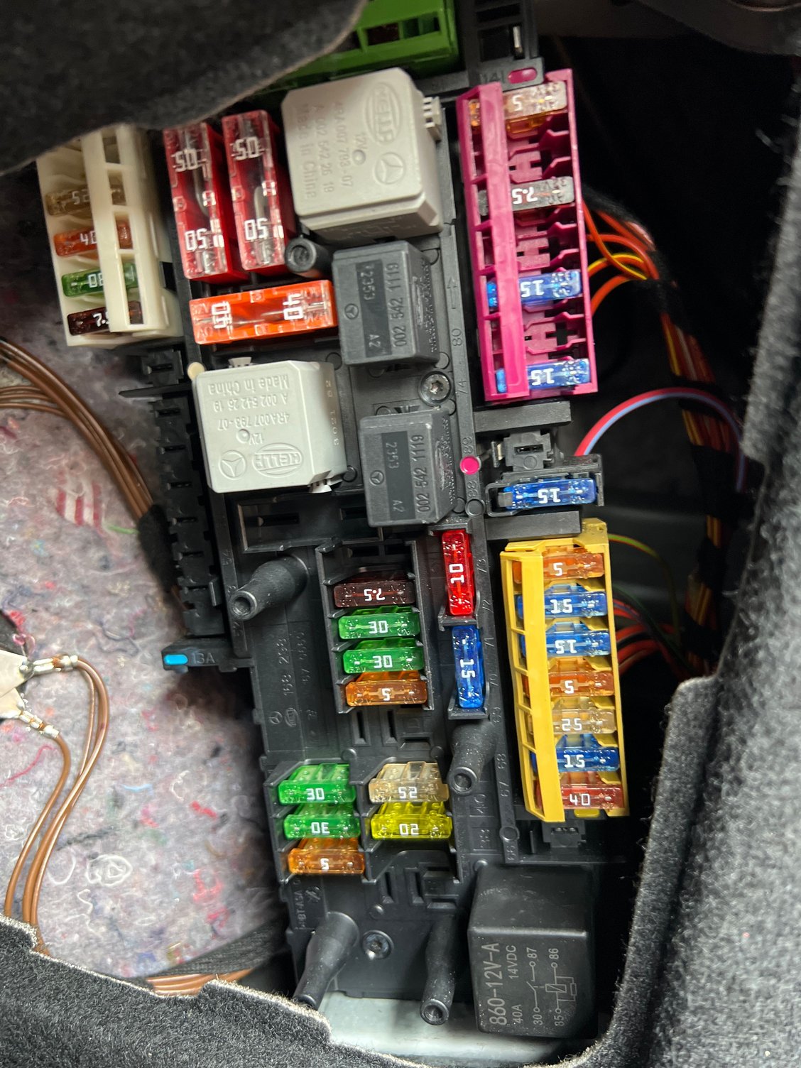

Ok I have scoured forums, google and to absolutely no avail. My rear end on my 2014 cls550 base is bottomed out and thus far I have replaced my air springs, my compressor and a level sensor (I could only get one here quickly).
the issue is I can not find my relay anywhere. I’ve checked the fuse box diagram on google and it doesn’t show one outside of a 15 amp fuse in the trunk, which is fine. I’ve looked all over the front fuse block, the trunk fuse block and even taken apart the prefuse box hoping to find it. Please help! I’m going insane!!!
Front fuse block
Rear fuse block

Front pre-fuse box. Relay # 160 is the Airmatic relay.
There is also a relay (K67) in the trunk on the lefthand side.
