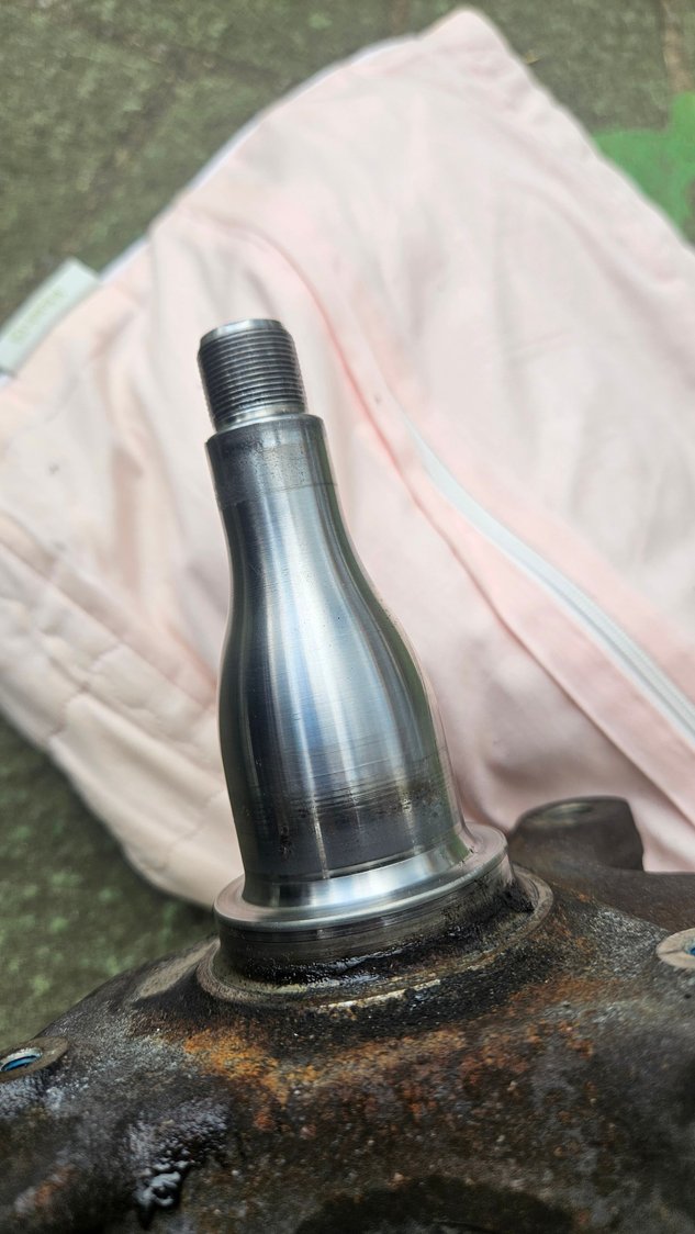

The car had a diagonal guardrail impact on the driver’s side some time ago.
After the impact, I developed a humming noise above ~40 km/h that increased with speed and became louder under load while cornering.
I replaced both front wheel bearings (hub assemblies).
The noise completely disappeared and the car drove normally for about 2 years.
Now, the humming has gradually returned with the same characteristics:
  • Starts above ~40 km/h
  • Increases with speed
  • Louder under load while cornering
I inspected the spindle surface on the knuckle.
There are minor cosmetic scoring marks but:
  • No deep grooves
  • No visible cracks
  • No blue heat discoloration
  • No obvious severe deformation
My questions:
  1. Could a slightly distorted steering knuckle from the original impact cause premature bearing wear even if preload was correct?
  2. Is it possible that minor spindle surface imperfections are enough to create alignment issues leading to recurring humming?
  3. In this case, would you replace the bearing again only, or replace the steering knuckle as well?
  4. Have you seen impact-related cases where bearings temporarily fix the noise, but underlying knuckle geometry causes recurrence?
Appreciate any insight before I decide whether to replace the knuckle.
Thanks.
Non Driver side steering knuckle
