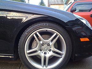

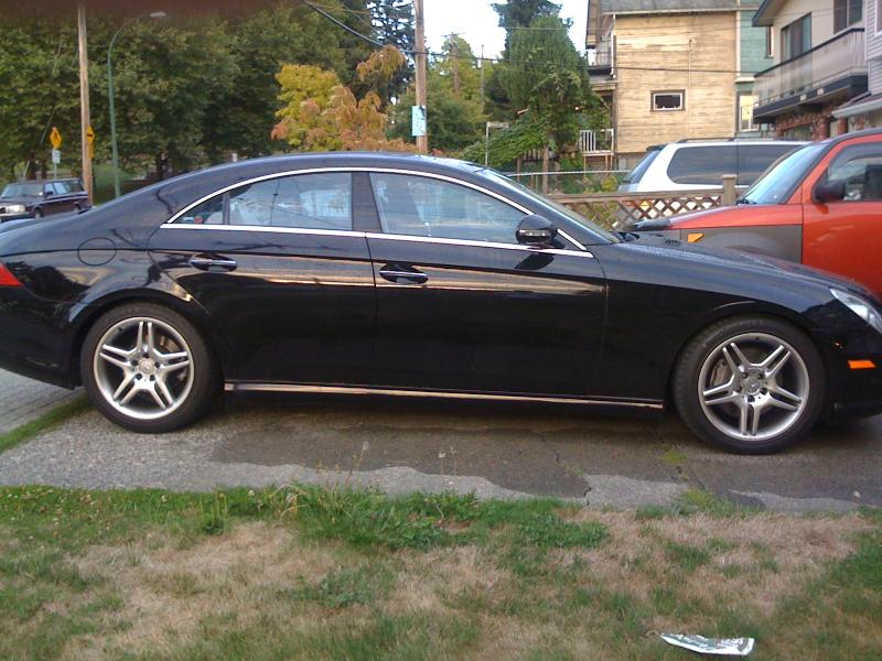

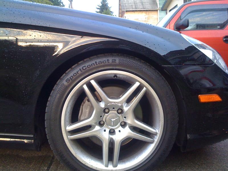

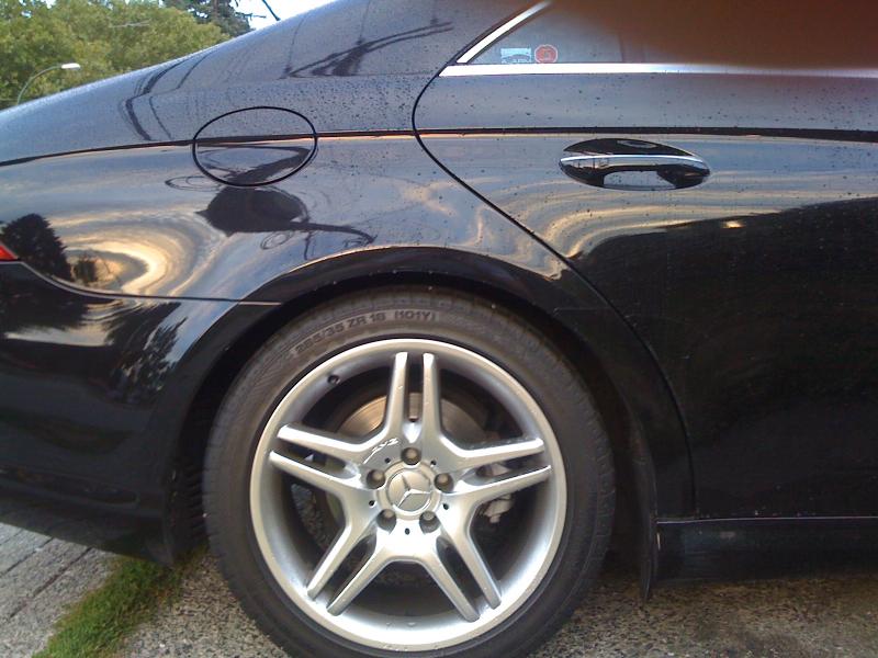

Pics
See the pics. This is ~ 1.5" drop. Haven't had a prob with speedbumps or going up and down steep driveways yet. When I press the raise button it almost goes back to the original height, maybe another 0.5" lower. Not as stiff as I thought, but great cornering. I wouldn't go with a 2" dorp because you'll really be pushing it.
Attached Thumbnails Finally... lowered!-img_0478.jpg   Finally... lowered!-img_0479.jpg   Finally... lowered!-img_0480.jpg
