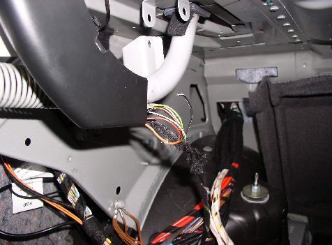

I have a second, less important problem but I'd like to address it too: the license plates lights are very unstable and show up as not working on my instrument cluster. It started with only the right one but now both work intermittently.

Have someone pull fault codes using MB diagnostics for ESP. Plate lights, check harness @ left trunk hinge (shown on 211, same for 219).

Thanks for your answer! I'll check this harness tomorrow.
