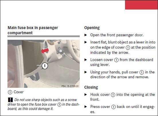

I believe for 07 easy entry only steering wheel is affected nevertheless, deactivate it then pull f34 (30A) @ interior fuse panel for at least several minutes in an attempt to reset driver seat CU. If this fails according to your scanner you will need to find someone with Xentry (MB diagnostics) to clear stored fault codes, pull new codes if no codes, normalize seat setting.
