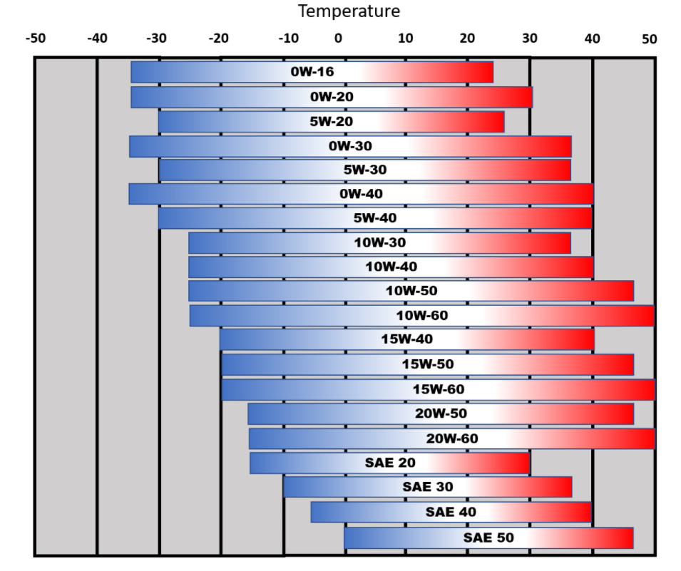

Thanks for e-mail. Where we live now, oil for 10-50 C would be appropriate. We have 34 C right now in the shade. Perfectly normal for this time of the year. We can order cars built to our spec here also, but the wait could be 3-4 months and there is always a risk for mistakes, I 'build' the car based on options and prices on the MBUSA website and then search the inventories for one. Found my (loaded) 2020 CLS450C at a dealer about 1000 km north and had it shipped to a dealer that gave me the best deal. My wife once ordered a BMW to be built to her spec. Several options were wrong and the car had the wrong tires. We did not take it and had to wait for a rebuild. A friend ordered a Volvo to be built, but it was painted in the wrong color so he had to wait for a rebuild.

I think it's going crazy, because it's 0W20 (I am sure in 90% it is). This oil is just too thin. I bet it should nominally burn this oil around 1L/8000-10000km - that's why oil sensor probably feels it and requires more often measuring (that's my theory don't spread it). Believe me this sensor is ULTRA sensitive on even 1 degree slopes. If you drive on a "slope" oil will be higher if you drive on an uphill oil will be lower. If you leave a car on a "slope" even if it is 1 degree for more than 15-30min, prepare to see lower amount of oil.
You don't have no-limit autobahns like in Germany and I remember when I landed in Miami took a car to get to Naples and I almost fell asleep and never in a history of my driving experience was so bored driving const 70mph for around 2 hours!!!!!!!!! My ability to crash in this case was higher than driving 270km/h (with AMG Drivers Package which I have) on German highways! Revving the car higher with higher speed requires much higher oil viscosity to save the engine and I'm less fatigued driving the car like this for 4h than driving 70mph for 2 hours seeing mostly same cars all the time! Driving in US is a nightmare...
Leave it as it is. When you'll be changing oil make sure you'll not get 0W20 oil with 229.71 norm. Share your experience here later about oil sensor. Go to 5W30 or better 5W40. I'm subscribing this topic so will be awaiting for your comments. My problems gone totally after much higher viscosity oil was poured.

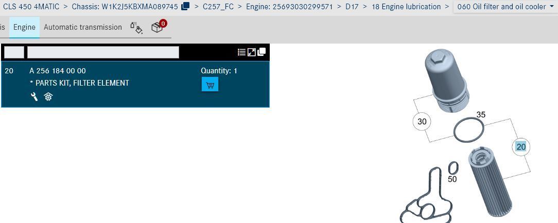

Question for F1le. By any chance do you know the part number for the oil filter? My 2021 CLS450 just finished 1200 miles and I want to change the oil and filter both.
File Type: pdf
File Type: pdf

I went to the local MB dealer and got the exact filter that is needed via VIN number.
