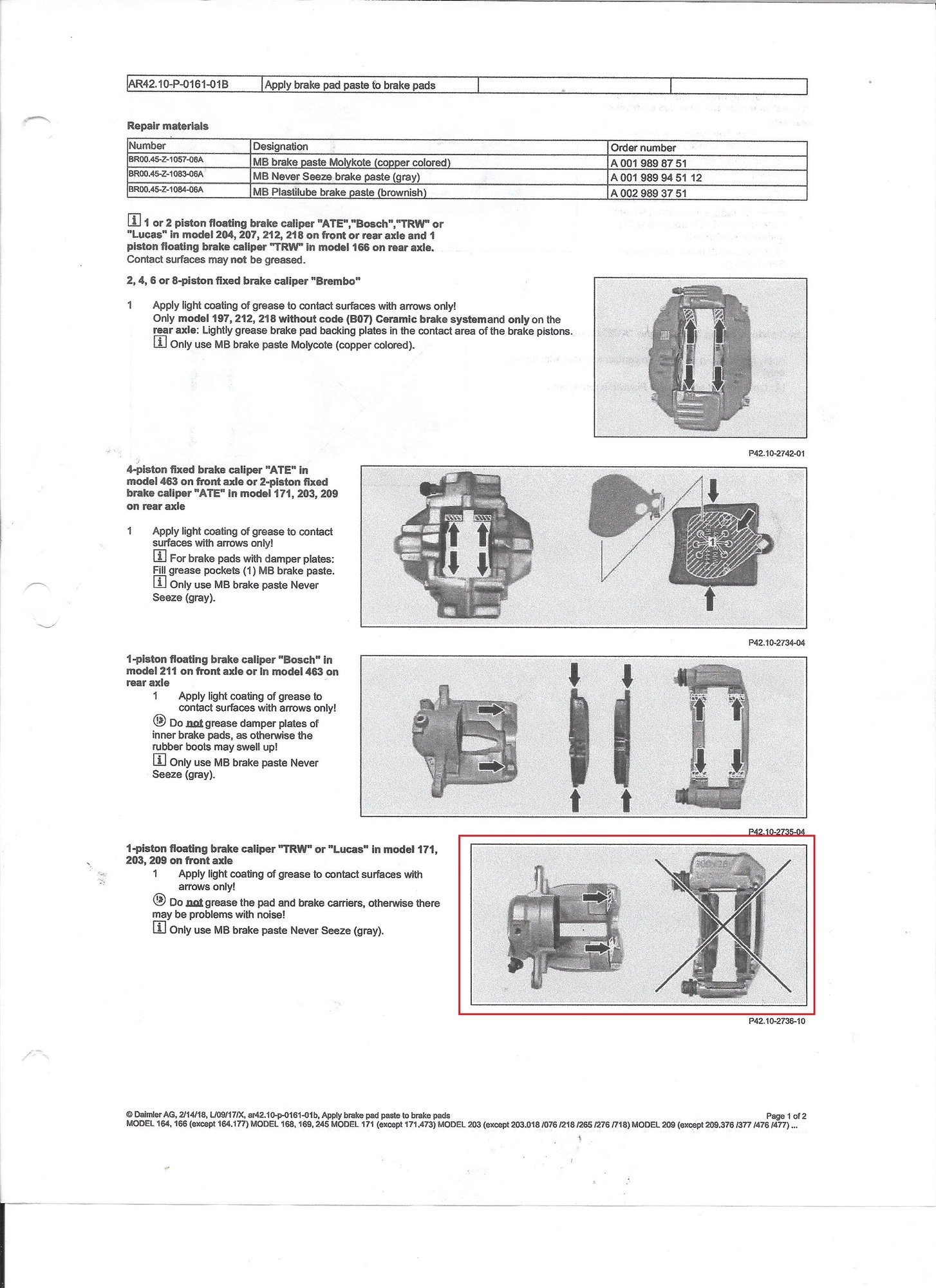

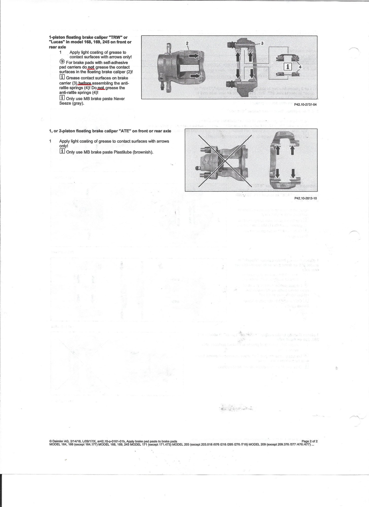

What did they do while the car was there, did they fix the noise?
I dont know what type of materials a CLS brake system has. I have just regular rotors and semi-metallic pads and I never hear any noise at all, installed them myself all around the car a few years ago, they are well worn in, maybe due for replacement in another year. I put around 7,000 miles/yr on it.
The maintenance guy may be right, in that the brakes should be serviced and greased. At least once a year I will remove and thoroughly clean everything, but I actually enjoy working on the car. The first time I worked on and replaced the rear pads and rotors I greased everything in there, but then was actually hearing noises like squeeks. I came across some info about where to only apply grease, went back and cleaned everything and started over. Since then they have been completely quiet.
In general I do not believe in just ignoring noises.
