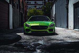

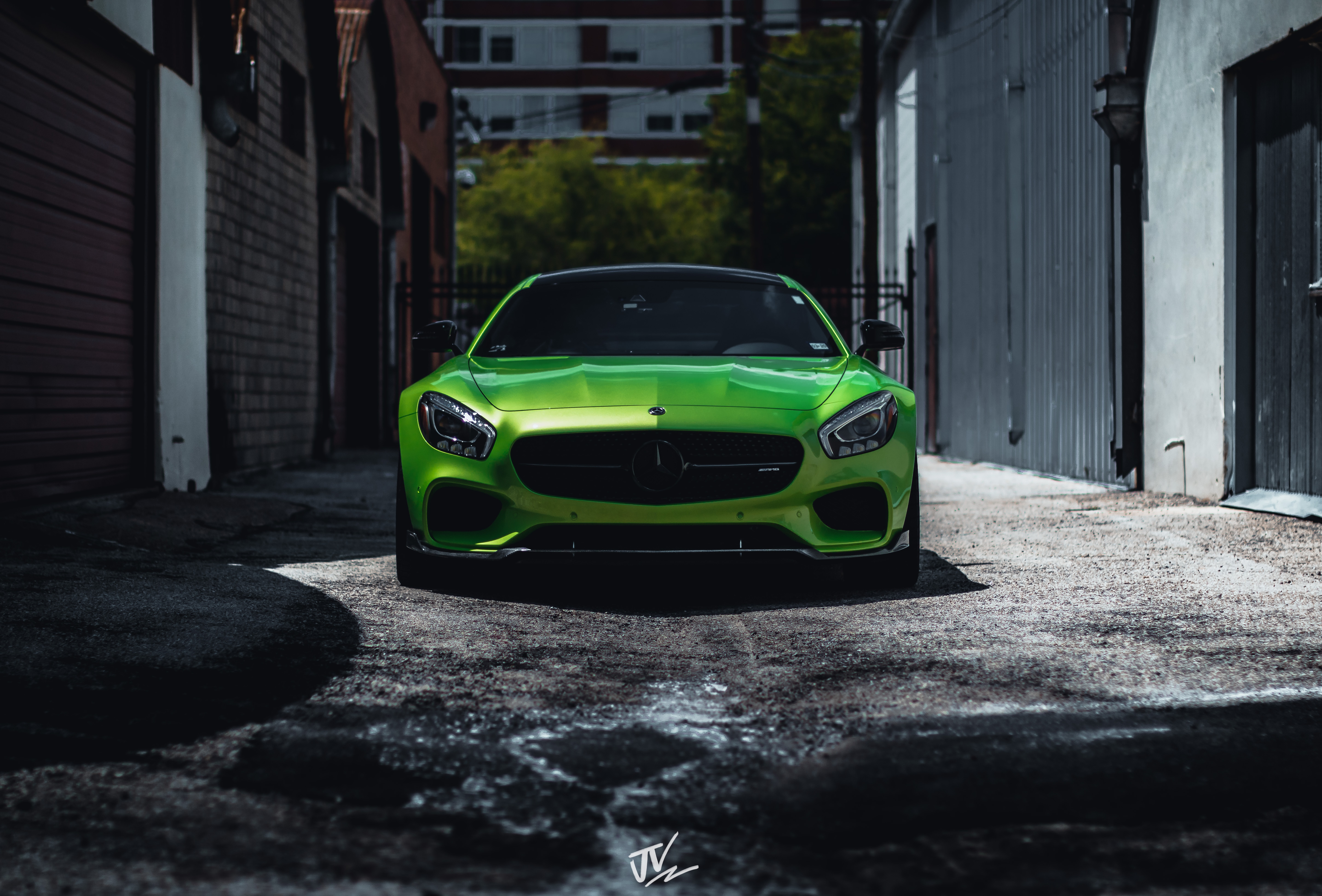

Originally Posted by garthbo
Here's how my GTS looked like when the wings were vinyl-wrapped. Easy to peel it off if you're not happy with it. But I do think it looks better with the wings blacked out and the star still in chrome.
Wow this is nice! Amazing job on that grill piece.
