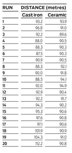

For those of you who are interested, here are the test results. The car tested was an F-Type Jaguar
Attached Thumbnails Second Batch-ceramic-ve-iron-brakes-evo-f-type-jaguar.png

I wish you tried the CCBs in the E63, I would bet that you would change your mind.
I have cars with steel and CCBs; and I would agree with that in a P car (which I own), CCBs are an over kill.
On the other hand for whatever reason in MB's CCBs are quite an improvement from steel. Maybe because the difference is curb weight?
It would be a good idea to drive a AMG GTs with and without then make your choice.
Breaks, suspension, clutches, tires and tire pressure are all about how they feel to you, kind of like a seat.
Before spending $200K test drive a comparable car, I would get a P car without CCBs any day, but no way I would buy an AMG without CCBs.

Curb weight of Jag is much closer to an E Class than a Porsche GT3 so I think the EVO comparison is valid unless of course you are implying that somehow Iron brakes on AMGs are inferior to Jags and Porsches.
Indeed, EVery imperical test I have seen clearly shows that any perceived advantage of ceramic over iron brakes inside of 10+ crash stops is purely in the mind. In fact tyres have more of an influence on braking distance than any difference between iron and ceramic brakes.
