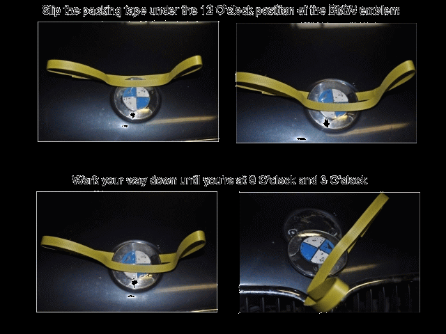

Quick note...we use this method on the regular. (package straps) laying down painters tape right near the edge helps with micro marring.

I, like some members above, had some difficulty with installation due to how flush the emblem was with the hood. I could not get a trim tool, a credit card, or even floss to get under the emblem in order to lift it out. As a last resort, I ended up using a 90 degree pick to stick in the side of the old emblem- once inserted, it lifted right out. Happy embleming!

Correct. Use an interior panel tool:
You can purchase a set on amazon for like $6 bucks. Here is a link.
Do NOT use a metal tool. These are a hard plastic that wont mess up the paint. Just put it under the edge, pry it up a mm or two, and then go 180 degrees, repeat, go 90 degrees repeat, 90 degrees repeat and it will pop straight up without damaging it - or the vehicle.
i would also place painters tape on top bottom and sides where you pry.

Thanks for this tip, just did mine with a nylon pry tool (I have a set since I'm often disassembling doors and dashboards on friends cars )
