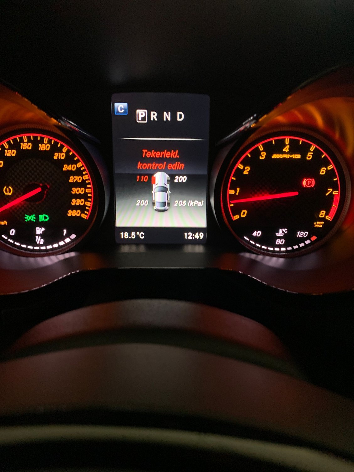

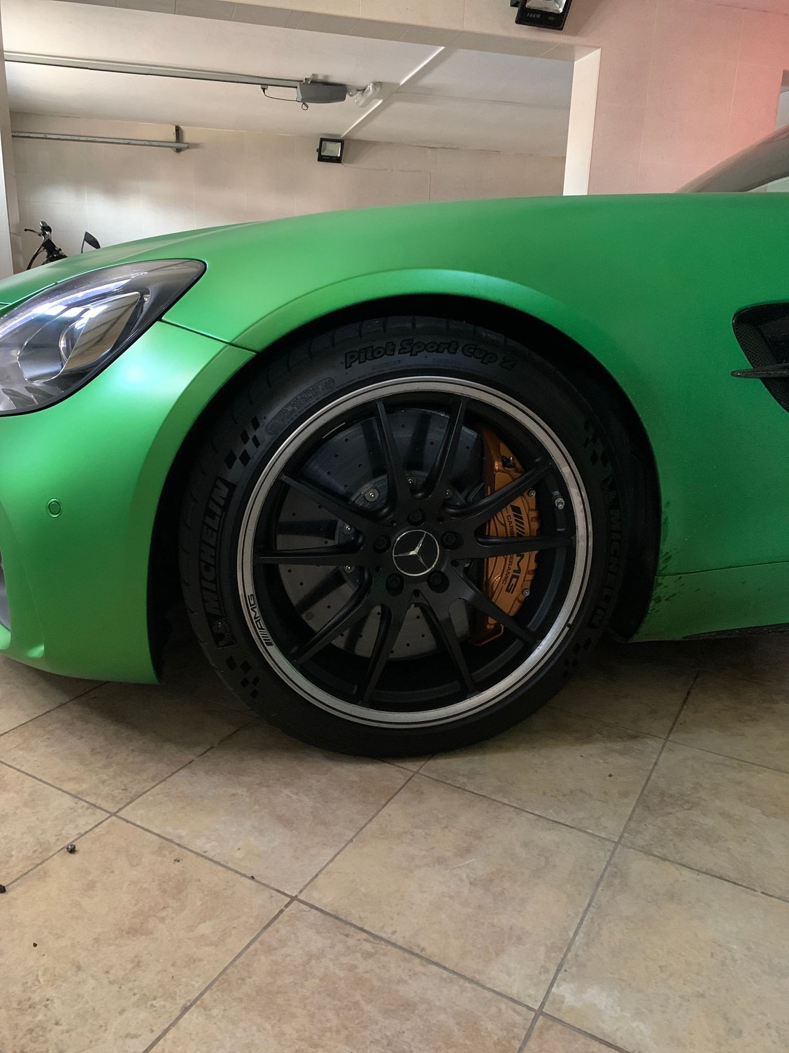

So i was cruising down the city and suddenly a notif popped out on the screen that says tire pressure was 175 which is low because normally its 210 or so. Then i went to gas station to inflate the tire took me some time but it was about 215 when i was finished So its been 2 days and this morning right before i go to the gym i see this probably a nail or something in the tire i called mercedes to see what they can do about it and there is my first flat tire

If it is just a screw/nail in the main tread area of the tyre, at least 1” away from the sidewall, you should easily be able to get a plug/patch to repair the tyre. Do not let the dealership tell you otherwise as they will no doubt want to replace the tyre.

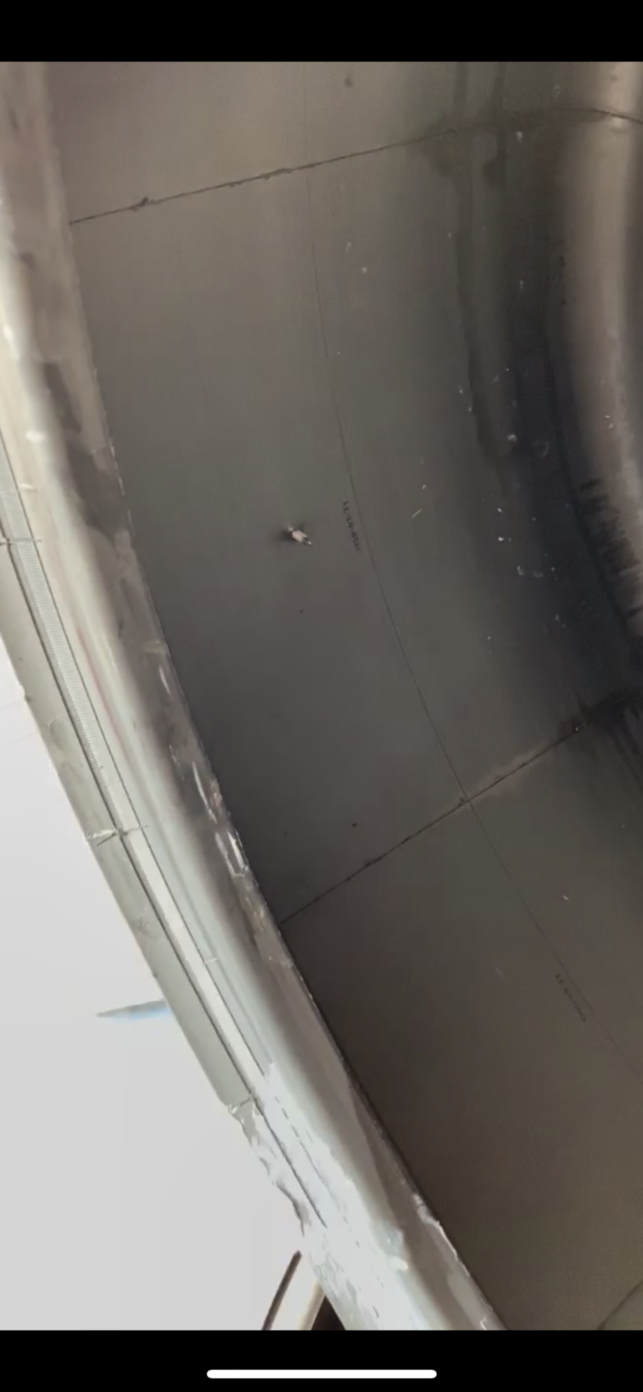

Here was mine. We match - lol. Almost the exact same spot.

Did you do a patch or did you just chance the tires instead
Old Nov 23, 2019 | 10:38 AM
benzbell's Avatar
Joined: Oct 2015
Posts: 1,511
Likes: 907
2023 Urus Performante 2018 Huracan Perf. - 2017 Ferrari 488 GTB
Dealer said that MB recommends replacing both tires. Of course it was just a recommendation. Car was almost brand new with less than a thousand miles and it irritated me to have to plug it. With the car being still so new. So I replaced both tires. Then it happened again in another 2k miles and I bought another pair. I guess the bright side is I don't ever have to worry about how soon my tires (tread) wear out. I don't seem to have that problem.
