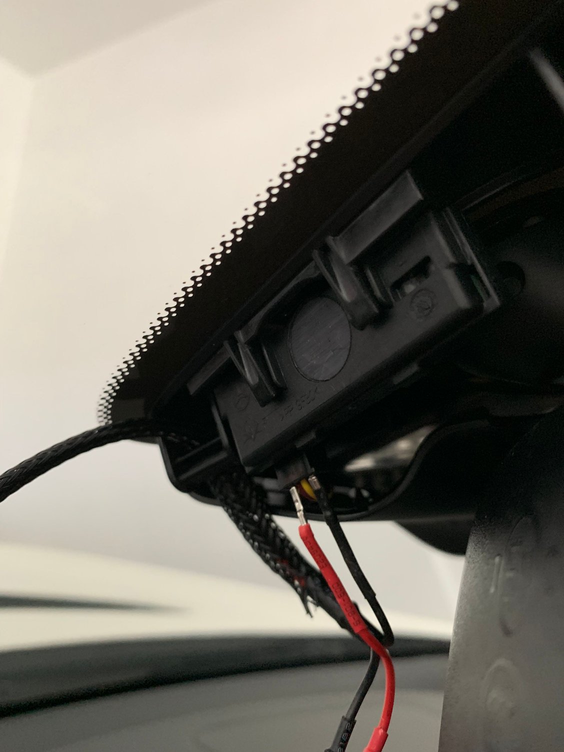

Mirror tap is the way to go. Just get the kit with the smaller leads as that’s what is needed get them in there snug.
Driver side of housing is where to tap after removing cover.
