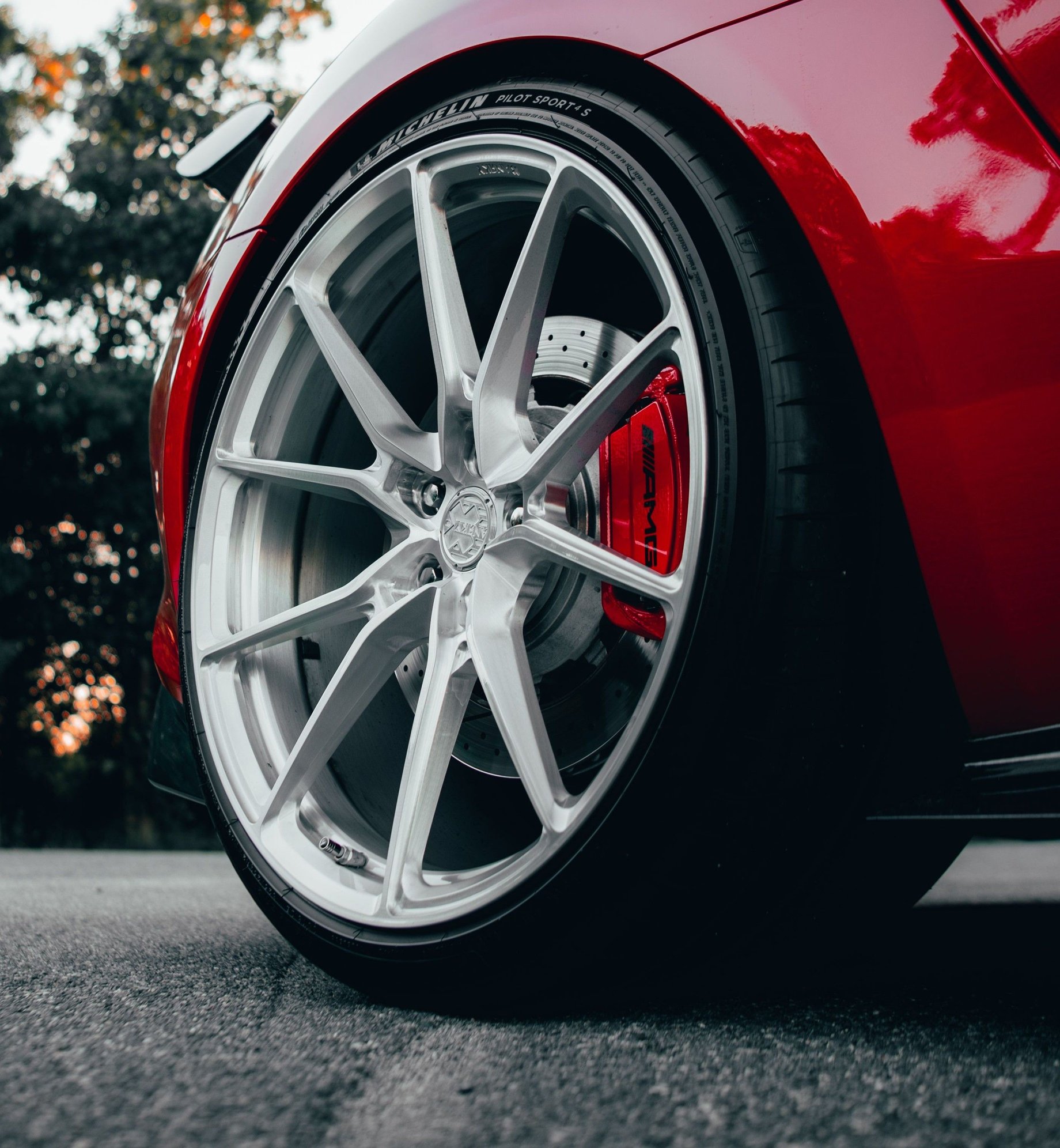

I tried and tire rubs with the fender liner on top and the front. My car is lowered, but even if yours isn't lowered, tire touches the fender liner in the front. 325 25 21 works perfectly.
Took this pic while it was on the jack , so not a good representation, but it literally is always touching the fender.
325 25 21 pic

Thanks a lot that helps. I was gonna buy toyos, Ill buy michelin now. Also thanks Skilly as usual for the help much appreciated.
