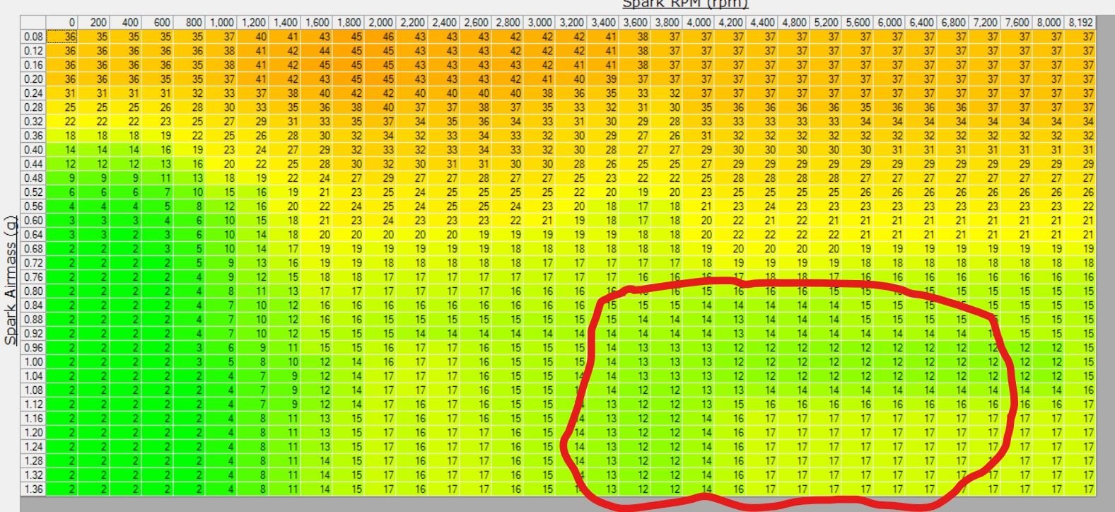

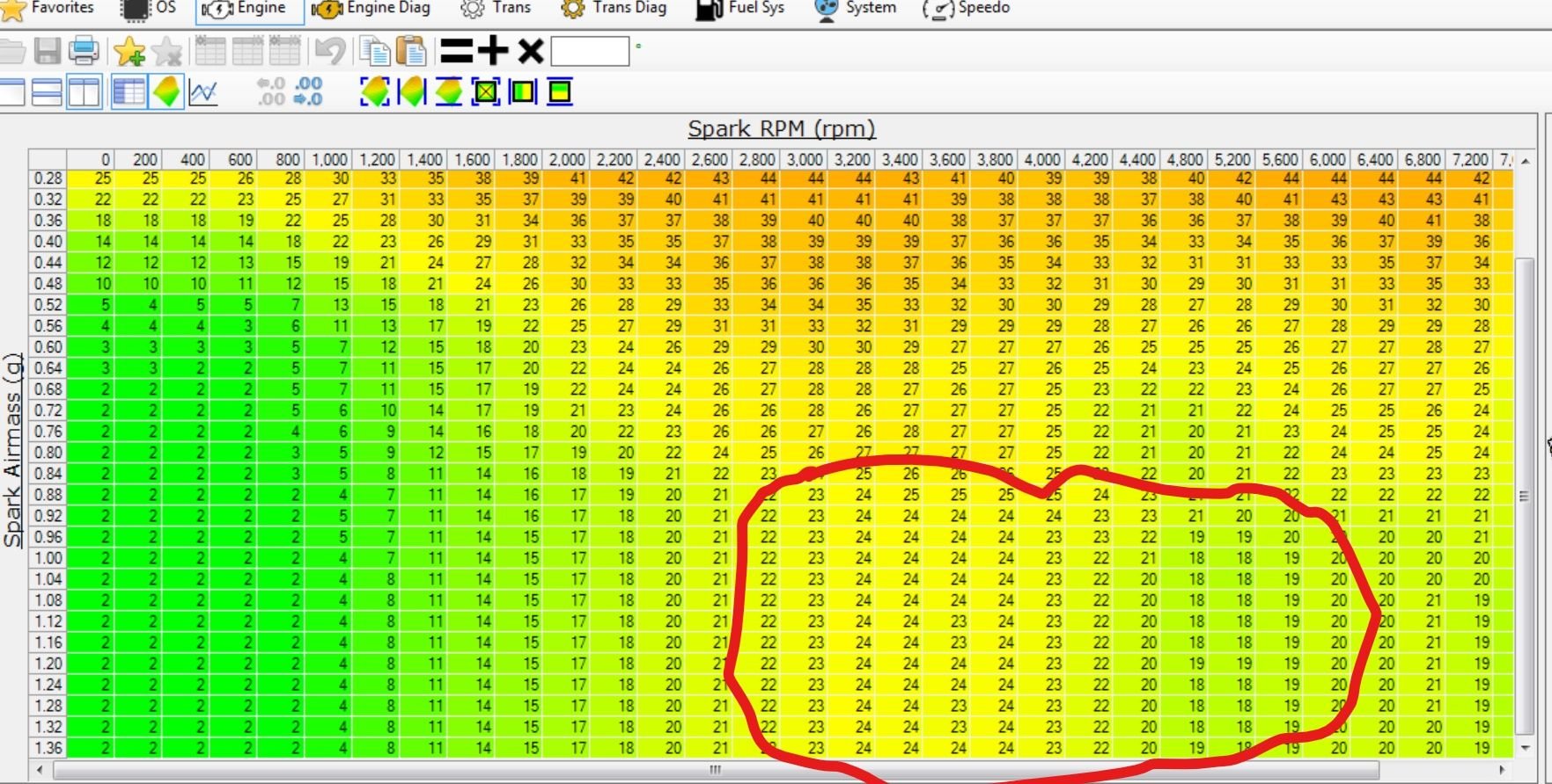

Ethanol is a tuner's dream fuel. E85 is about 105/108 octane depending on the accuracy of the blend. Once you start really boosting engines there is no pump fuel that is going to work well to take full advantage of the boost. Cylinder pressures and cylinder temperatures quickly fall out of an acceptable operating range when you try to make 93 octane fuel work with too healthy of a boost. I'll give a live example below and one that I tuned for E85. The engine was a V8 NA (not MB, but similar principle). This is a generic example as some engines based on the valve/cam design will extend the red circle to the right by a little more RPM.
This table is the high octane timing table with values pretty common on any NA V8. The region of the table highlighted is roughly the PE range after leaving closed loop.
The critical area for PE is in the range of 4K rpm to 6K rpm and with a spark air mass of approx, .80 to 1.00. The timing values in these cells optimize performance of 93 octane fuel in PE
Now if I seriously increase cylinder pressure under boost.
In PE, I am seriously reducing timing in the cells of the same range (but adding a spark air mass all the way out to 1.36) just to prevent spark knock. If I can increase octane past 93, in fact, all the way past 105 (with E85), I can come close to returning timing in the cells in the PE range to the original NA values. This makes for a whole bunch of performance. This comes with a warning - you cannot fill up especially with E85 if you're not tuned for it. A lot more to say here, but this would get unmanageably long.
