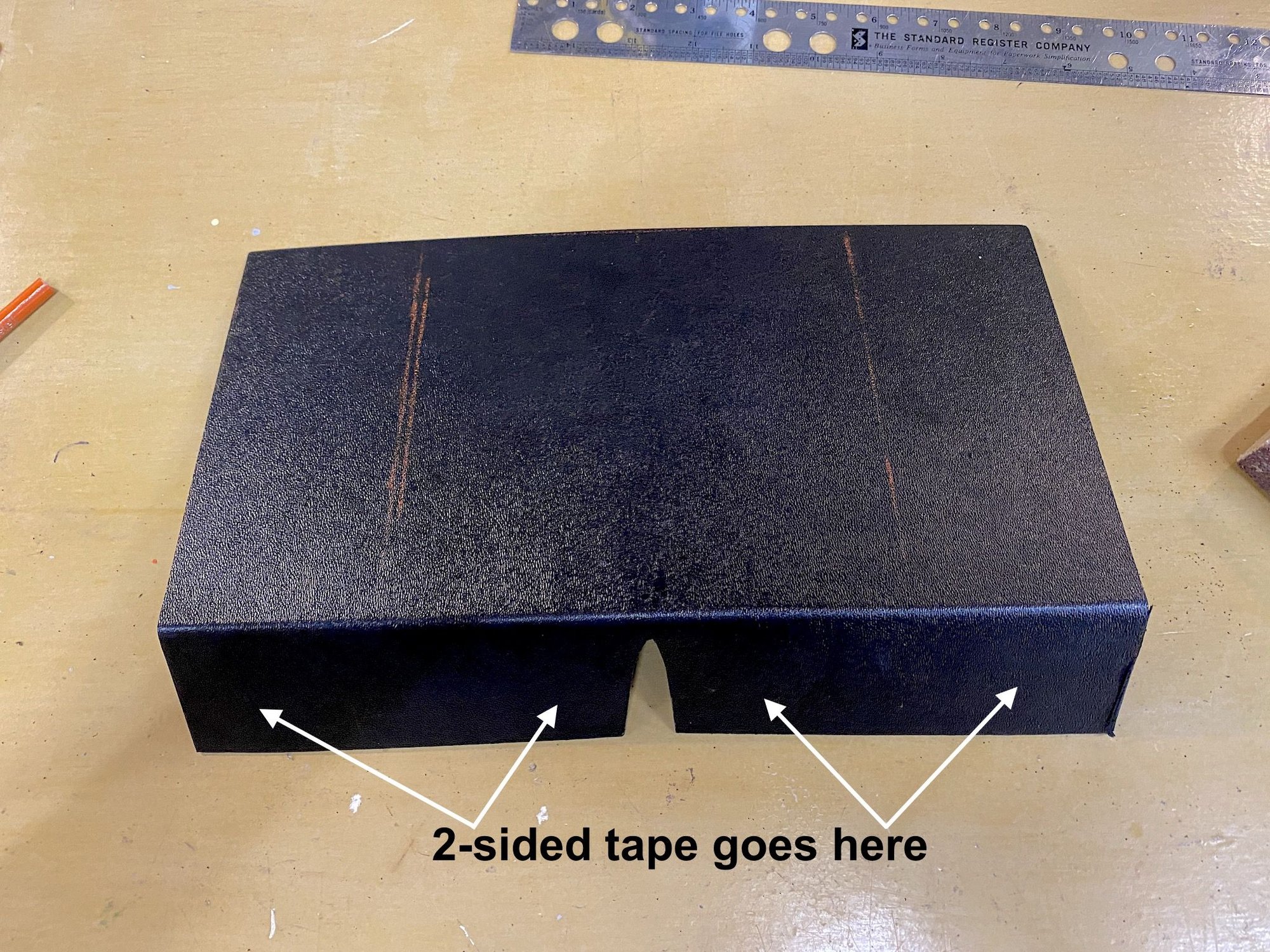

To close the loop, I ended up making a front license-plate bracket out of a piece of thermoplastic sheet I had in my garage (it's a plastic that can be heat-formed using a heat-gun and remains flexible at deep-freeze temperatures). In case anyone can benefit from my effort, here's what I did ...
I was hoping to do a bracket that would attach only via (Gorilla tape) 2-sided tape but, because any thickness at the top blocked part of the front/parking camera's view, I ended up having to remove the U-shaped flaps at the top and use screws. After a throw-away plastic prototype bracket and a cardboard pattern, I arrived at this (it's actually v2 of this, v1 had the top tape-mounting flaps that made it too thick):

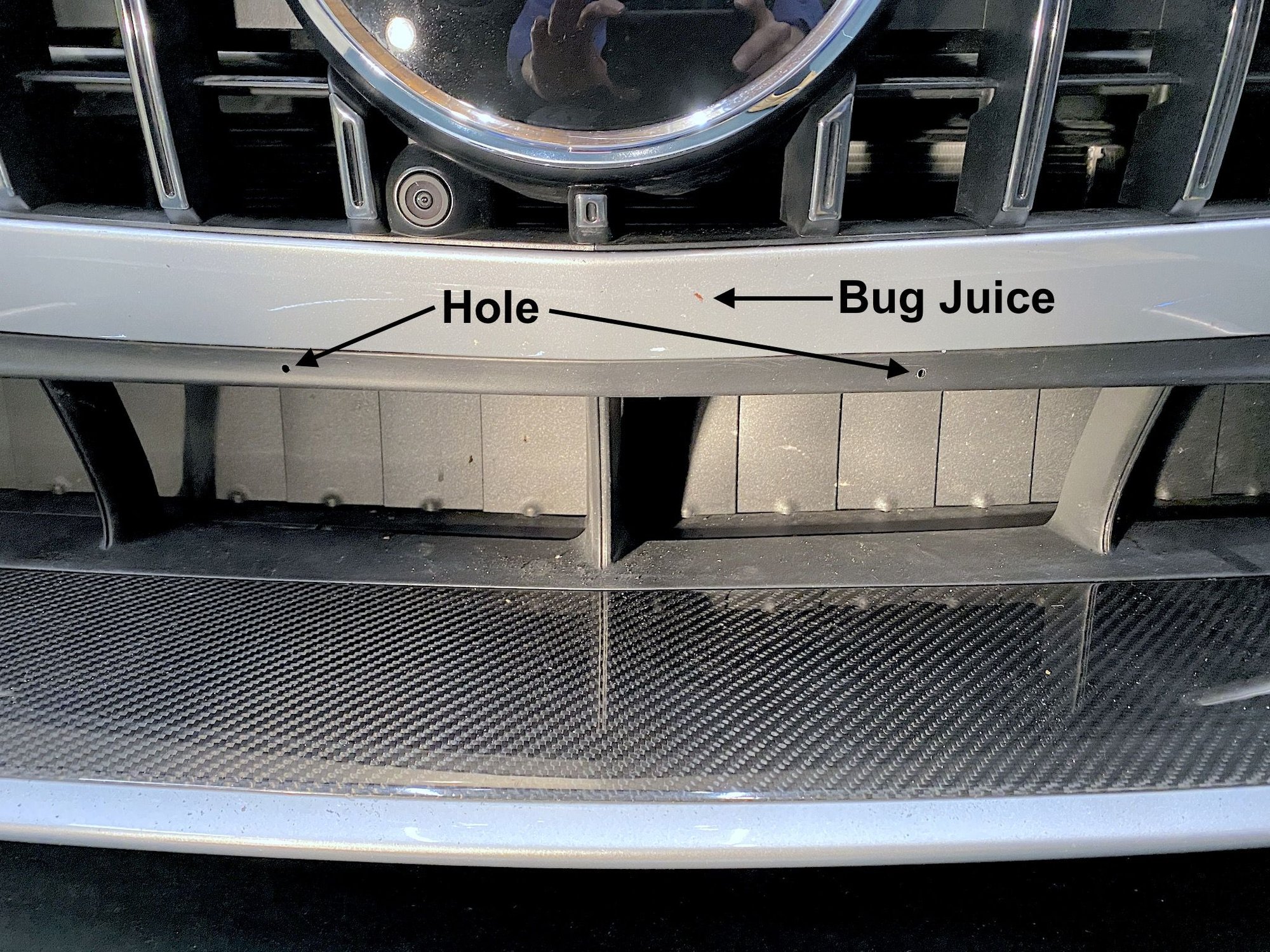

I drilled 2 holes:
The extra holes in the bracket fall under the category of ... check clearance _before_ drilling any holes. Wanted to put the screws there but, after feeling up 'n under behind I found a wiring harness and harness clamp in the way (plate-attachment is via nylon hardware I had in the garage ... nuts colored black using a black marker):
