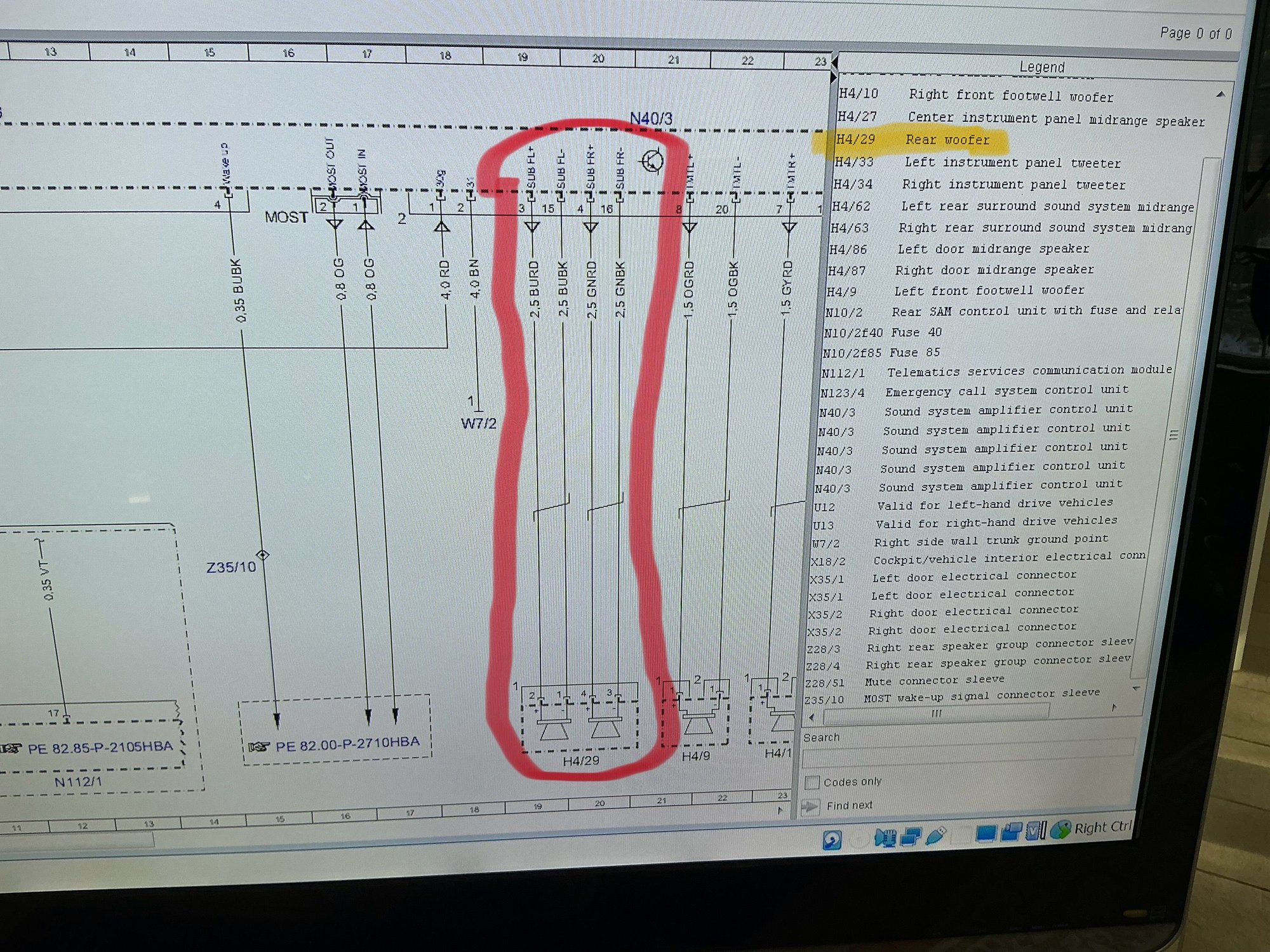

Hello Stengel,
Reviving an older thread. I have the 810 option and I believe the subwoofer is dead and may have been for a while. I am listening to the radio only so I never felt the lack of bass. According to WIS (attached) and to your post above the sub has 2 coils (4 wires) similar to 2 subs?. If so, how can I test both the amp output and the sub? And if I want to replace the sub with a normal sub do you have an advice on how to wire it to the original amp output?
Thank you,

Hi,
The answer is right in front of you. :-)
Remove the Subwoofer interior trim in the trunk.
Turn on the ignition. Turn your Radio on. Set the volume to 10%. Turn off the ignition.
Disconnect the plug from the Subwoofer.
Measure the output signal at the amplifier. (A 20V AC measuring range should be suitable.) Alternatively, connect a speaker between pins 2 (blue/red +) and 1 (blue/black -).
Then do the same again between pins 4 (green/red +) and 3 (green/red -).
You can test the Subwoofer in the same way, for example, by measuring its resistance. (I'd guess around 2 ohms.)
You can also apply a DC voltage of approximately 6 -12V (5A current limited); this will move the cone inwards or outwards.
or a 6 -12V AC 30 - 60 Hz Signal. You can hear it.
Be careful not to short-circuit anything.
Best regards,
Stenzel
