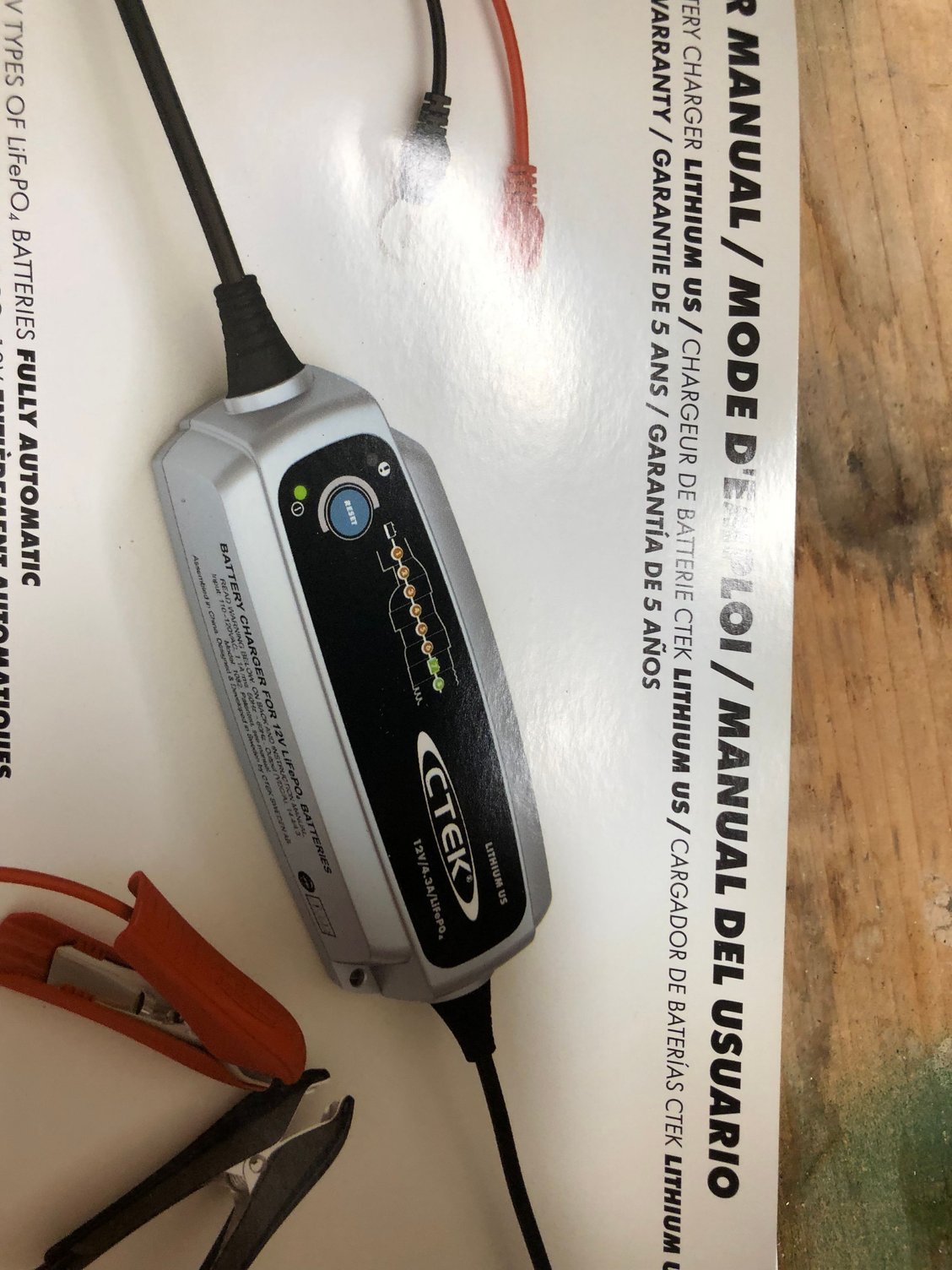

edit: hold that thought, battery may have been "asleep"? Car is dead, had to use key to open door. CTEK charger keep going into error mode, but after 4 resets it looks like it's charging. Jury still out...

Looks like the battery is dead. Now to figure out how to get it out of my garage. Can you jump start these cars? These lithium batteries really suck!

I think the battery is toast but not 100%. My charger made it to the testing point then went to error which says it's a bad battery. I have to get some new jumper cables tomorrow and see what happens.
