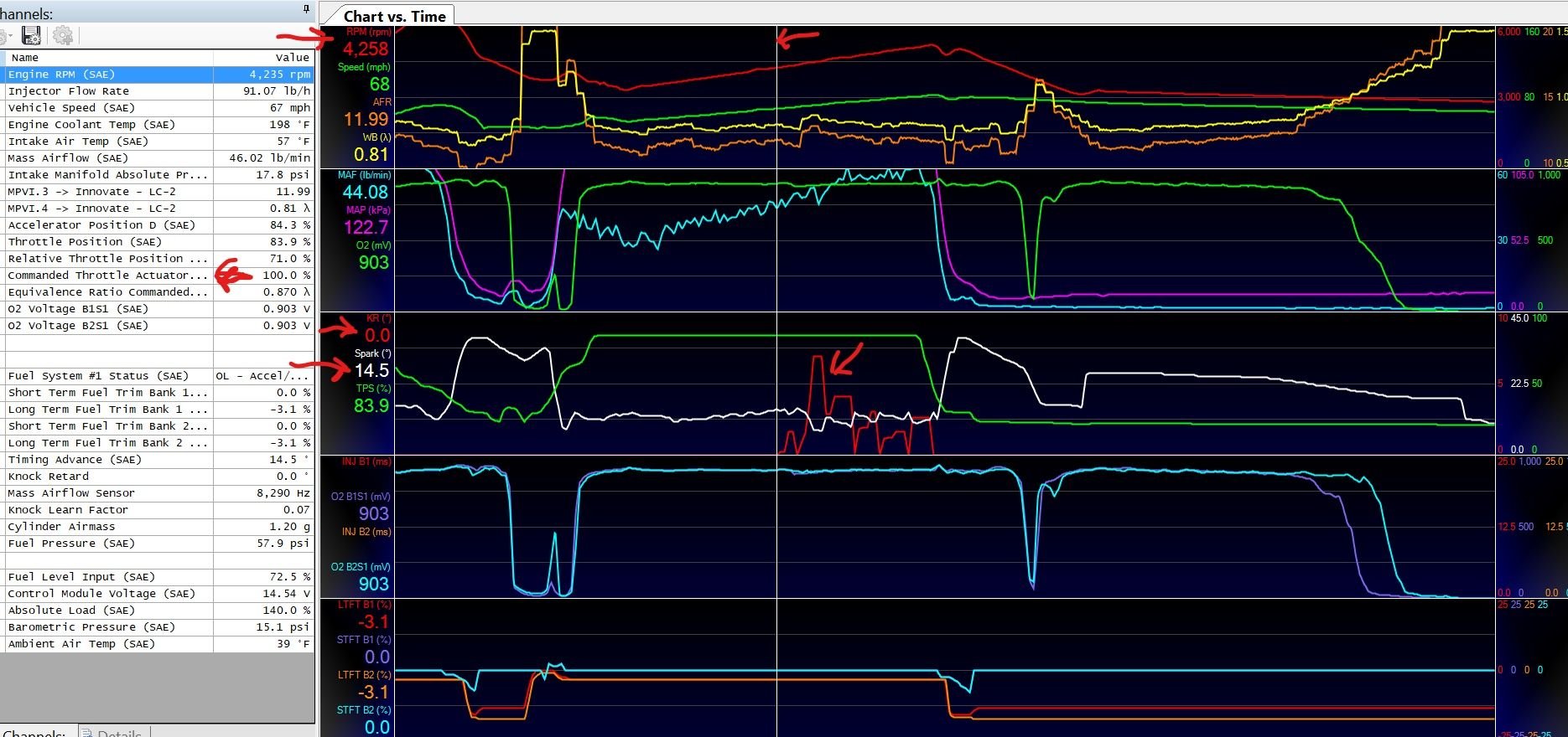

I pulled up a datalog I did some time ago as I thought it would be a good illustration of the tuning challenge and how knock appears and is resolved. This is a V8 engine with a supercharger (non MB, but same principle). It is a 91 octane tune as all that is available in the area. The illustrations below are still shots of a motion picture that I see in the DL, but BC of proprietary SW I am unable to post the log as a motion pic.
These 3 shots are a sequence of the same event. The first pic is a stillshot of all the parameters I watched leading up to a serious engine knock event (where timing in the individual cells were too high). The second and third pics progress through the knock event. I set up the arrow markers of importance to observe as you move through these three pics.
In the first ROW watch RPM and the vertical white cursor (which is constantly moving in the motion pic version).
Note in the white field to the left, commanded throttle is at 100%. Commanded throttle is me. I was doing a WOT pull.
Watch in the third ROW both timing (white line) and Knock retard (red line).
I am coming up to a pretty serious knock event under hard acceleration meaning in a region on the timing table that I showed in an earlier post, the timing is too advanced (or similar to what I would see if I could drain the tank and put in 89 or 85 octane instead of the 91 in the tank). Notice the timing at this moment is 14.5* advanced. KR is 0. Watch how the ECU reacts when the knock appears in the second pic.
One point of observation, but not germane to this discussion, I was using a wideband on this car and had already set fueling just the way I wanted it. It is reflected by the yellow and orange lines in the first row. Orange is the actual AFR, yellow is the Lambda.
Now the white vertical cursor is moved over to the peak of the knock. Here you see knock reported as 6.9 and the ECU has pulled timing down to 7.7*, a reduction of 6.8*. Also note the RPM in the first row continues to climb and I continue to command 100% throttle (WOT).
This last pic now takes us to the point immediately after the knock event, notice that RPM is still rising, but it is the moment I decelerated and commanded throttle now shows 35.7%, so I was in the very moment of letting off with RPM almost the highest point in this pull. Note that knock retard in the third row is back to 0 and timing has recovered to 16.0*.
So this illustrates what the ECU will do with fuel that starts to spontaneously combust. BUT, if I tune it to 93 and then put a tank of 89 in, the red Kryptonite spikes seen in the third row will be continuous throughout the RPM range, not as severe under lighter loads and cylinder pressures/temps, getting more and more serious under heavier loads and pressures/temps.
BTW, to finish up this tune the way a good tune is done, I made a regional adjustment (downward) in timing advance, then back to another WOT DL to be sure this red spiked area was gone.
