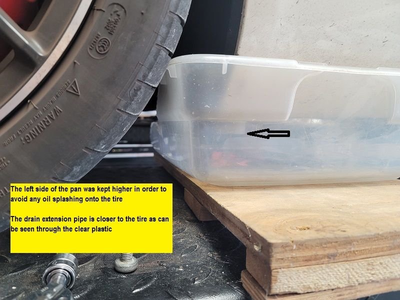

In order to be able to use my 4 poster lift to drain the engine oil of my GTS and it's of center located dry sump oil reservoir drain plug I had to customize my drain set up.
Hereby some pictures and notes of how it went, I'm pleased with the end results.
Merry Christmas to all!
Best H

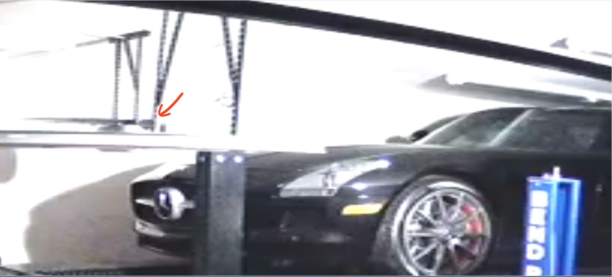

We have a 10 1/2 foot ceiling and that seems to work very well. Make sure that you have clearance from the garage door opener to the back of the garage in order to accommodate the car.
I always back the car onto the ramp so that it stays out of the way of the garage door when it's o
The opener just clears the front of the car.
pen..
