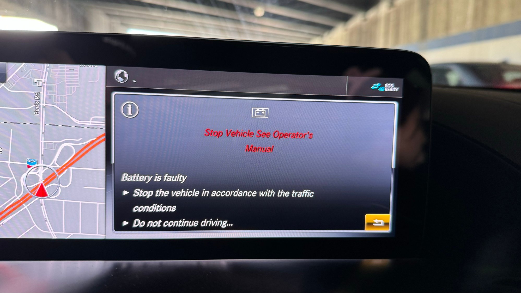

NEED HELP PLZ!! Battery Fault unresolved
so I've been getting this battery fault constantly, sometimes the car sputters, loses power, dealer says its a low voltage fault but is unable to find why/what... been at the dealer for a while as they're trying to figure it out, shop foreman is involved, so far they can't locate the issue and are communicating with tech support at MB corp for guidance. They checked everything in the system and nothing is found faulty or bad, including battery, voltage regulator, ground, loose cables, alternator voltage output is good. my car is a 2018 with 1500 miles. this is very frustrating and upsetting!

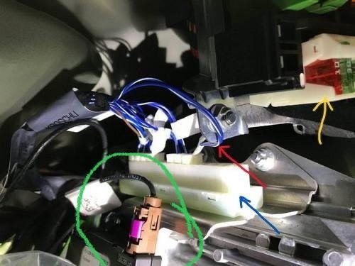

Hi Gil/Gils,
Any news on this issue?
Are you running or disabled?
Bish made a good point in post #6. If you need help with it I can direct you to the spot where a potential short might exist. I just inspected mine from a recent laundry list of U-codes that suddenly popped up. I have a thread here on that issue and how I disposed of it. Mercedes did (and does) a terrible job with their CANBUS harnesses and terminations...almost high school project like.
The potential for a shorted hi/low CAN bus pair could exist at the rear SAM control unit (but it's not a common issue either), specifically at the BUS terminal. There isn't much that needs to be done to expose the BUS terminal and the inspection, by eye, is easy enough to do.
I'll leave this pic if you decide to check it out. But, remember too, if a short like this is found, you'll have to repair the short, then do a deep scan to clear all U-Codes that resulted from the short.
Here's where to look - Rear storage area, leftside, by the storage for the tire inflater, etc. Just remove the trim cover, no tools.
Yellow arrow shows the lower left corner of the rear SAM fuse panel for reference. Blue arrow shows the CANBUS terminal. Red arrow shows a POTENTIAL example and location where a databus pair could get snagged and short out to a grounded chassis part.
One final comment about Controller Area Network - All the modules in the car are nodes on the CAN bus. The CAN has a gateway router that works similar to the way the router in your home might connect and manage all of the "nodes" connected to it. Just like the router in your home, data streams can get corrupted and cause "various stuff" to start malfunctioning. The battery management module (the one now showing a malfunction in your car) might be perfectly OK, but lost its path on the CAN bus. That is why you must clear all existing faults AFTER a repair attempt is done, so you can reestablish network integrity.
The dealer should know this, but in my experience with all dealers with all makes, the techs are typically weak on diagnosis (real diagnosis), always strong on parts replacement. So, they can see a fault like this, immediately replace the battery management module, then get lost when it doesn't fix the problem.
Hope you keep us posted!

Sorry to hijack the thread. Does anyone know what equipment that is circled in green? I’m my 18’ GTR it’s missing and unplugged
