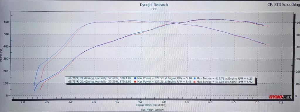

2020 GTC - ECC Stage 2 93 Octane Dyno numbers
I wanted to post up a 93 octane Stage 2 ECU/TCU combo tune from Slav @ ECCTuned in Toronto Canada.....
Why a ECU/TCU combo? If you don't modify the TCU stock torque limits, the ECU will not be able to get the most from the tune, as torque management will limit torque and hence horsepower on the street.
This car has an aftermarket downpipe, with all other hardware stock, including the intake. According to Slav @ ECC, the downpipe is good for ~10whp.
625 whp / 615 wtq at the wheels, with 12% drive train loss equates to 710 bhp / 700 btq.
Look at that torque curve and area under the graph! Smooth power delivery.
I plan on going back to Slav in the near future to look into a Race Gas tune.... I expect that will be very spicy.

Very impressive!
Do you know what kind of boost you are running to get to these numbers?
Another quick question: How does the torque limiter in the TCU limits the HP in 5th gear (which I assume is what's used during the dyno test)? I was always under the impression that the torque limit issues are on the 1st and 2nd gear and never get to intervene in higher gears.
Thanks

Sorry, I have to plead ignorance on how much boost the tune is running.
The dyno was performed in 5th gear.
From what I understand, Tq limiters are present in every gear and can be increased accordingly with a TCU tune.
Certainly the torque limits are lower in the first few gears, but they are active in all gears to varying degrees regardless.
This is the limit of my knowledge. Slav at www.ECCTuned.com can better answer your questions I imagine.
To fully take advantage of the potential performance gains, the ECU/TCU combo really needs to be considered.

What were the baseline numbers (before the ECU/TCU tunes)?
That would be helpful as dyno are unique and have a wide range of outputs and numbers.

so I I understand correctly its running 700lb/ft at the engine?
how is real world performance? Do you struggle with putting power down?

So I spoke with Slav today, very nice guy and very knowledgeable.
He said that the ECU tune for the GTC/GTR runs boost of 1.5 bars/ 22psi and provide a +70WHP over the baseline HP. I think this is very much in line with the added HP I have seen out there with 93 oct and original OEM turbos. I assume that downpipe and better coordination of torque info between the ECU and TCU may add few more HP to this.
