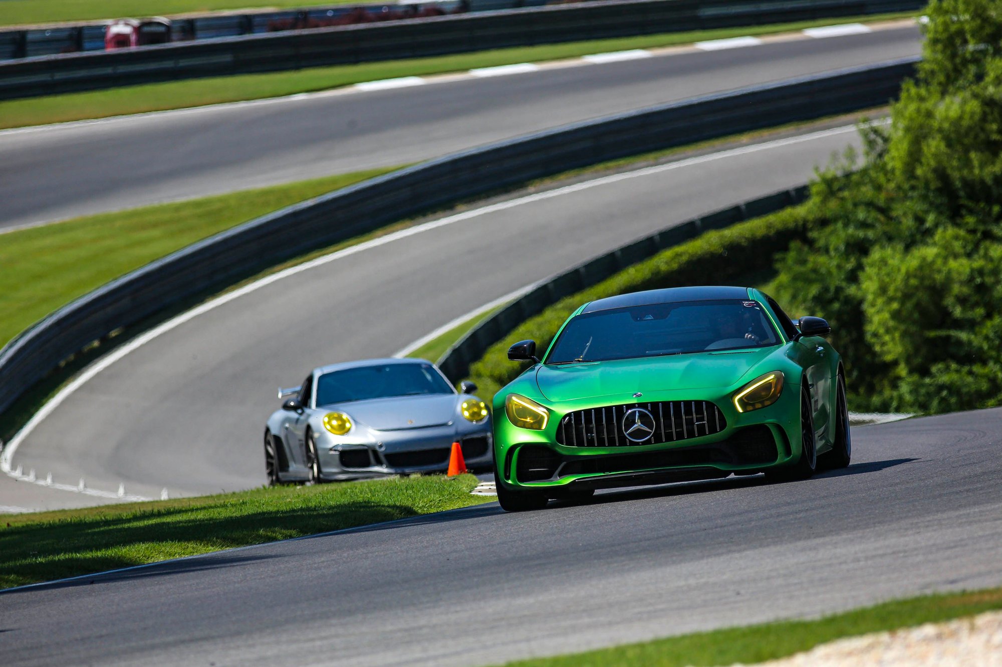

This thread got me thinking of taking the girls out again on a recent track day.
Wasn't that surprised the GT R received more curiosity and praise from fellow track folks than the GT3. It's still rather rare to see one at the track I reckon.
Brakes on the GT R held up quite well this time though I wonder if the cooler weather helped. Didn't have to bleed much tire psi either. Bishman's comment on "internet" understeer did resonate with me during a long sweeper with a late apex. The GT3 had none of that during the same stretch. The GT R does have a bit more body roll through some corners compared to the GT3 but I sense it as being intentionally playful from the team at Affalterbach.
My previous comments regarding the two still stand for as-is from factory. And I will add this. If I were to compete in time trials, I will take the GT3. If I want to have fun with a voluptuous growl under the hood, it will the GT R.
