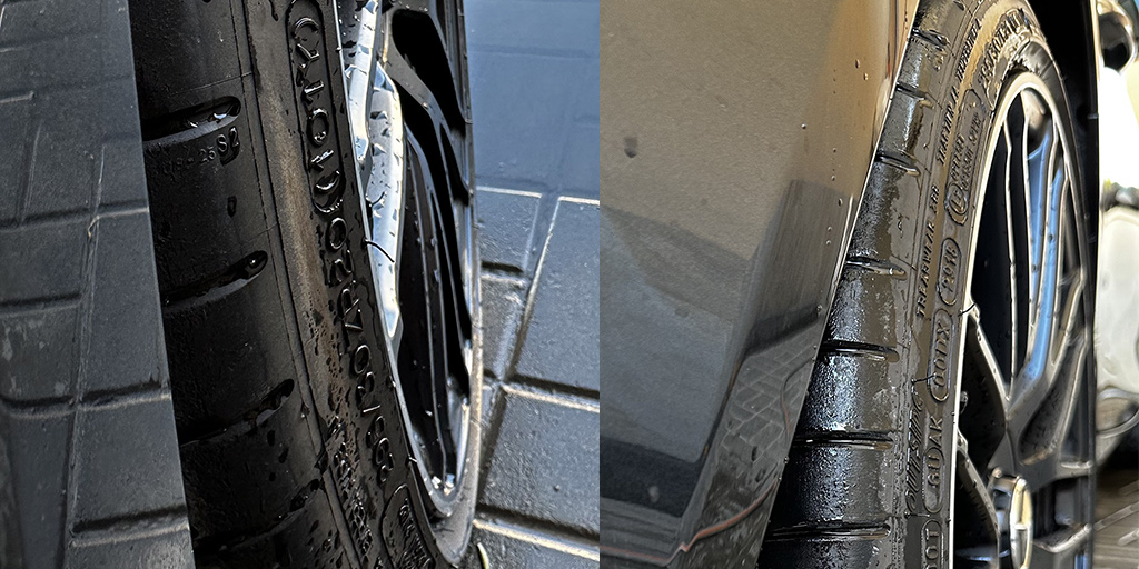

I won't pass MOT if I dont replace rear wheels on my car. Sadly, I don't have any more time (due in 3 weeks) to order matching tire in MO spec... and I have OCD and don't want * or N0 spec tyres on my Merc. However, getting one size larger set with of Super Sports 305/30/R20 with MO is possible where I live literally next day... stock is full. No wait.
Question: does this 1cm make a huge difference on a stock 9.5" rim?
295/30/R20 stock Pilot Sports look like this:

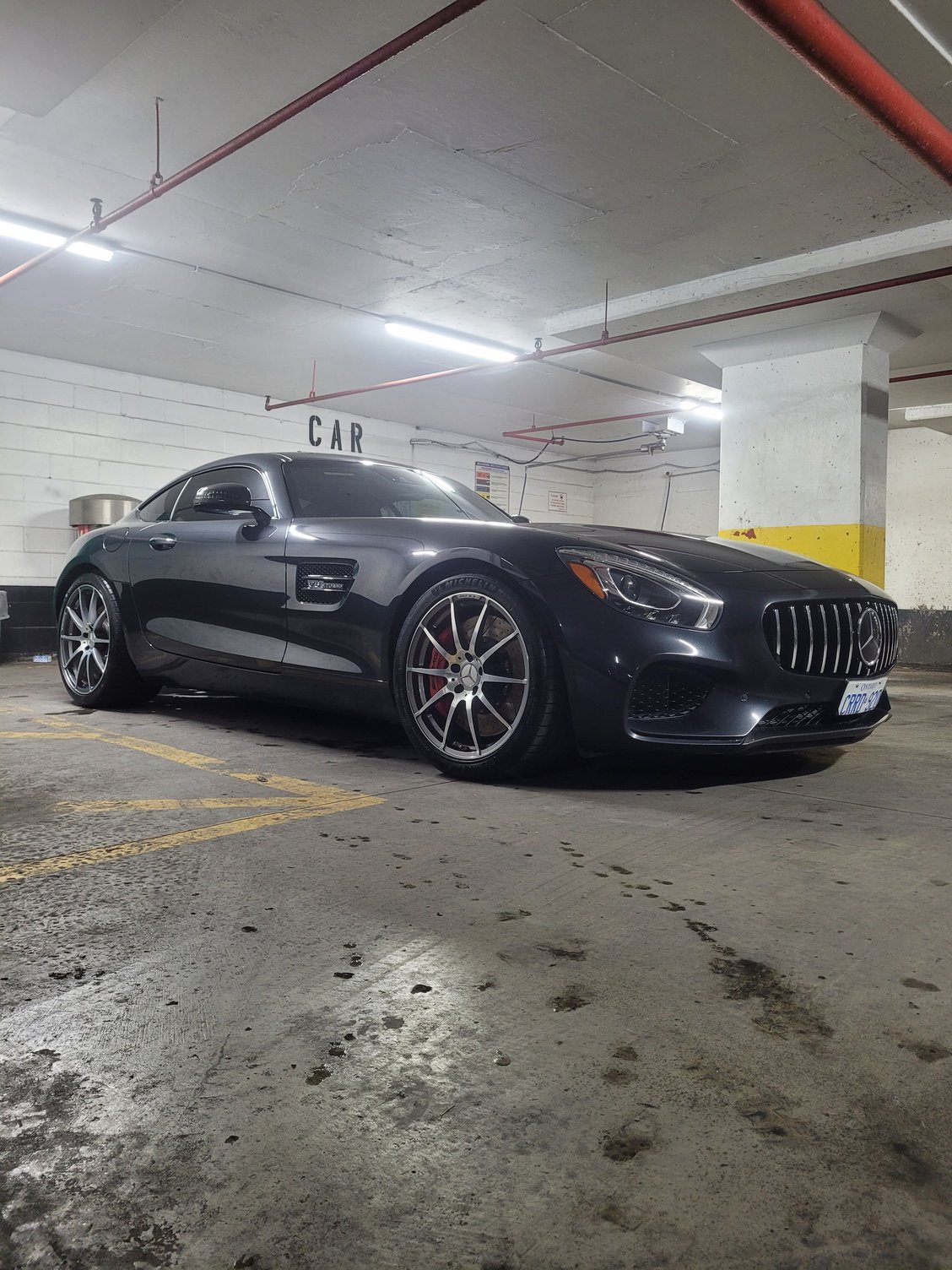

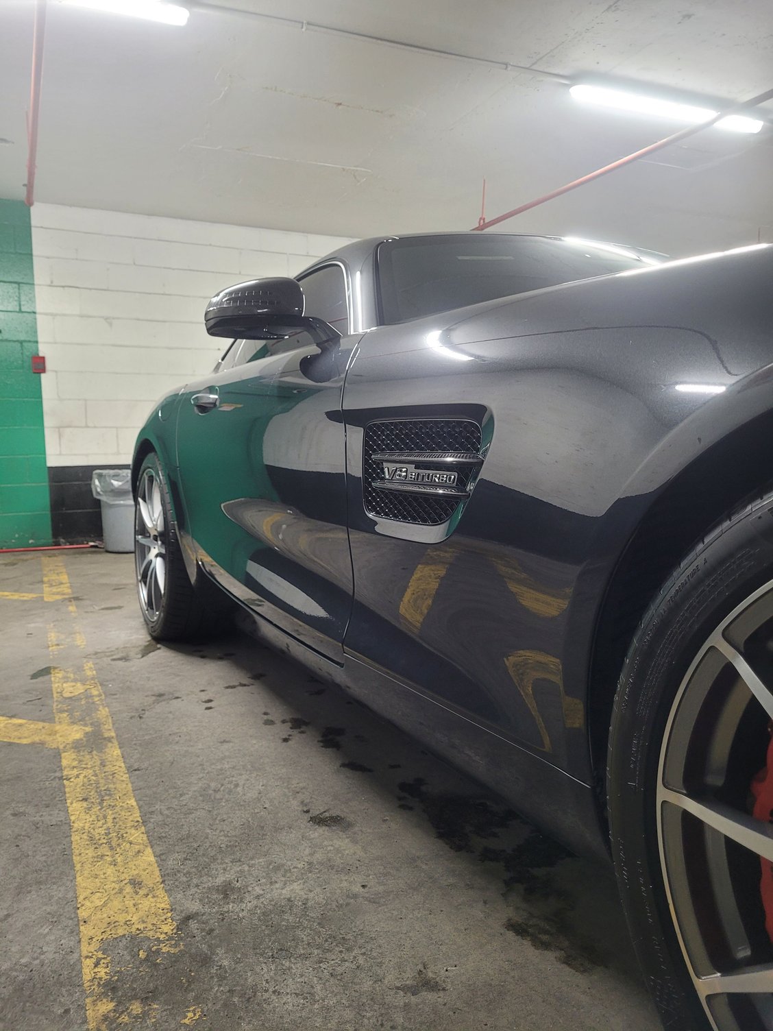

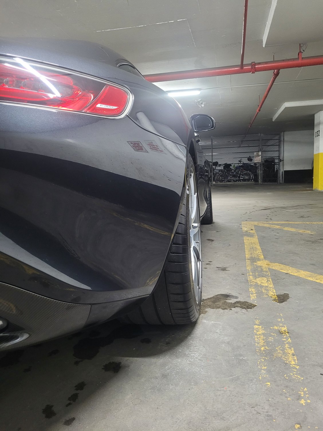

Sorry about the delay in getting back to you on this. Here are some pics of 315/30/20 on the rear and 275/35/19 on front PS4s.

BTW, I have not had any issues with rubbing or any thing else. The garage i bought the tires from mentioned the Michelin tires are very squared so they tend to sit on the wheel in a very centered position, don't know what he meant by this but also mentioned the side walls are also very stiff so there is no chance they would come off the rim. These are the max sizes. He would definitely not go bigger than 315/30/20 on rear and 275/35/19 on front.
