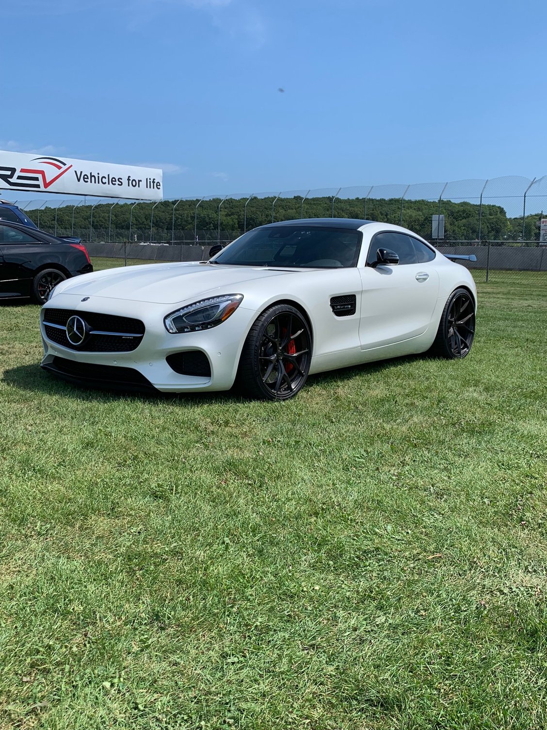

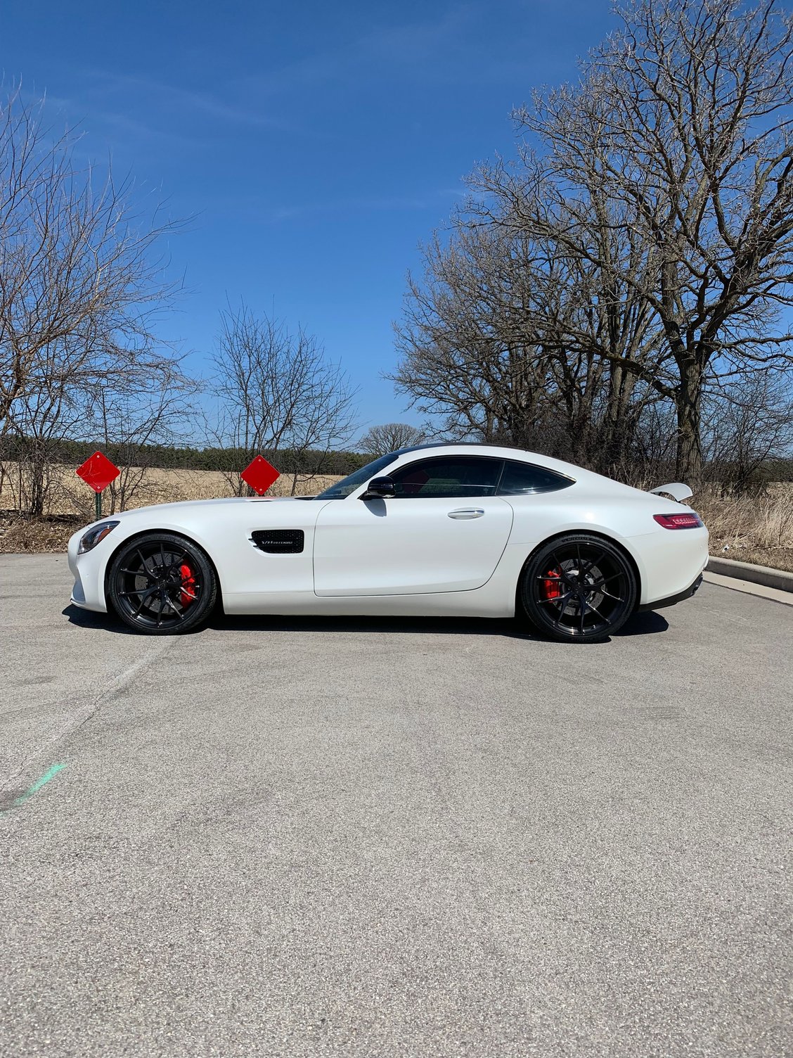

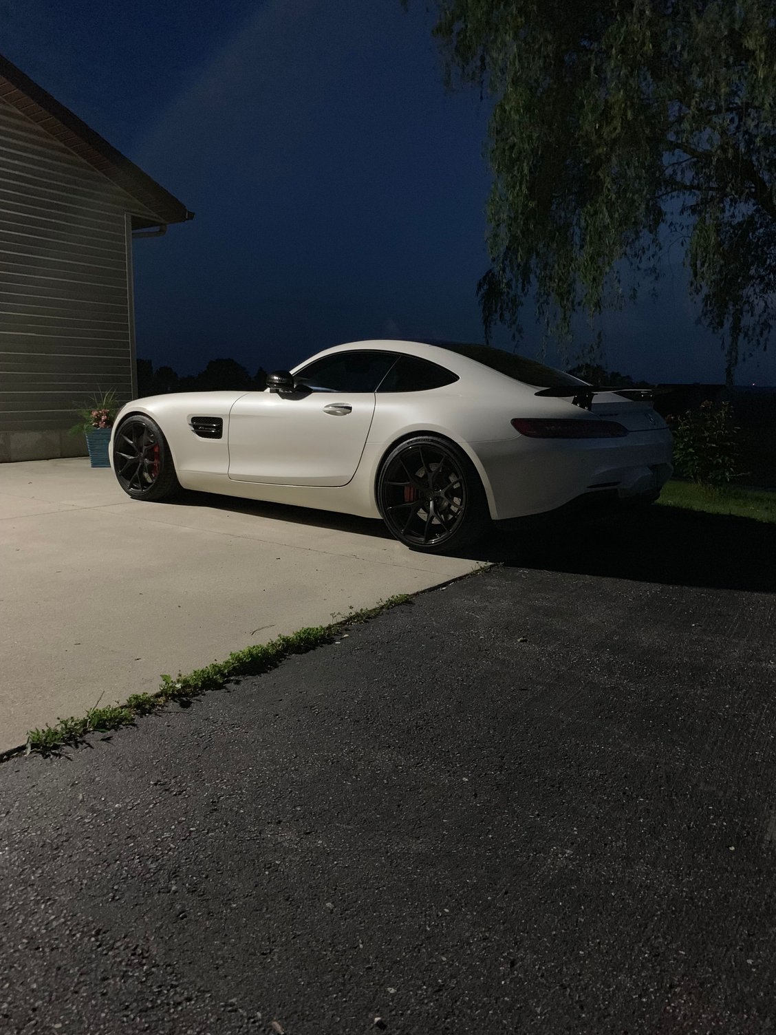

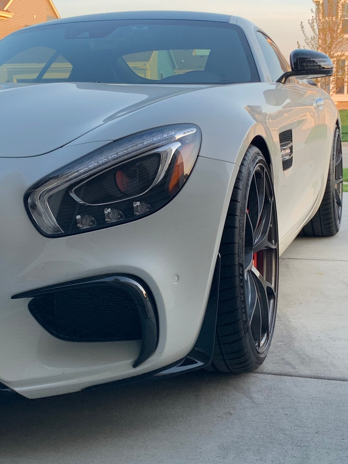

Here you go, my previous GTS that had Signature Wheel wheels for street use…..
20x9.5 with 265/30-20 et48 (if going 10” wide wheel up front you’d go to a et54)
21x12 with 325/25-21 et62
KW HAS, lowered 0.6” settled to a little over 0.75”and then properly aligned.

Yes, updated post above with offsets so all in one place.
I am all about sharing offsets!
