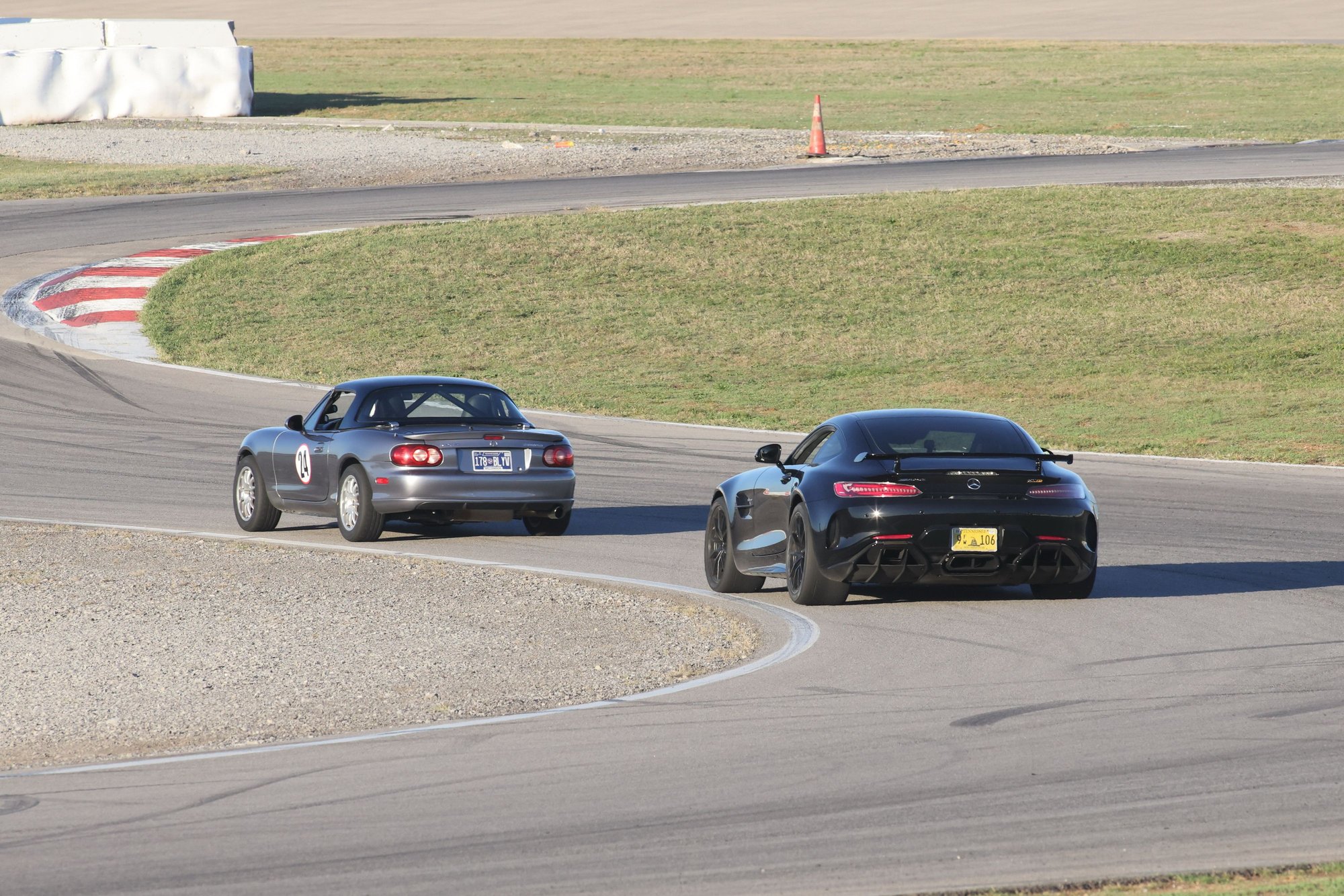

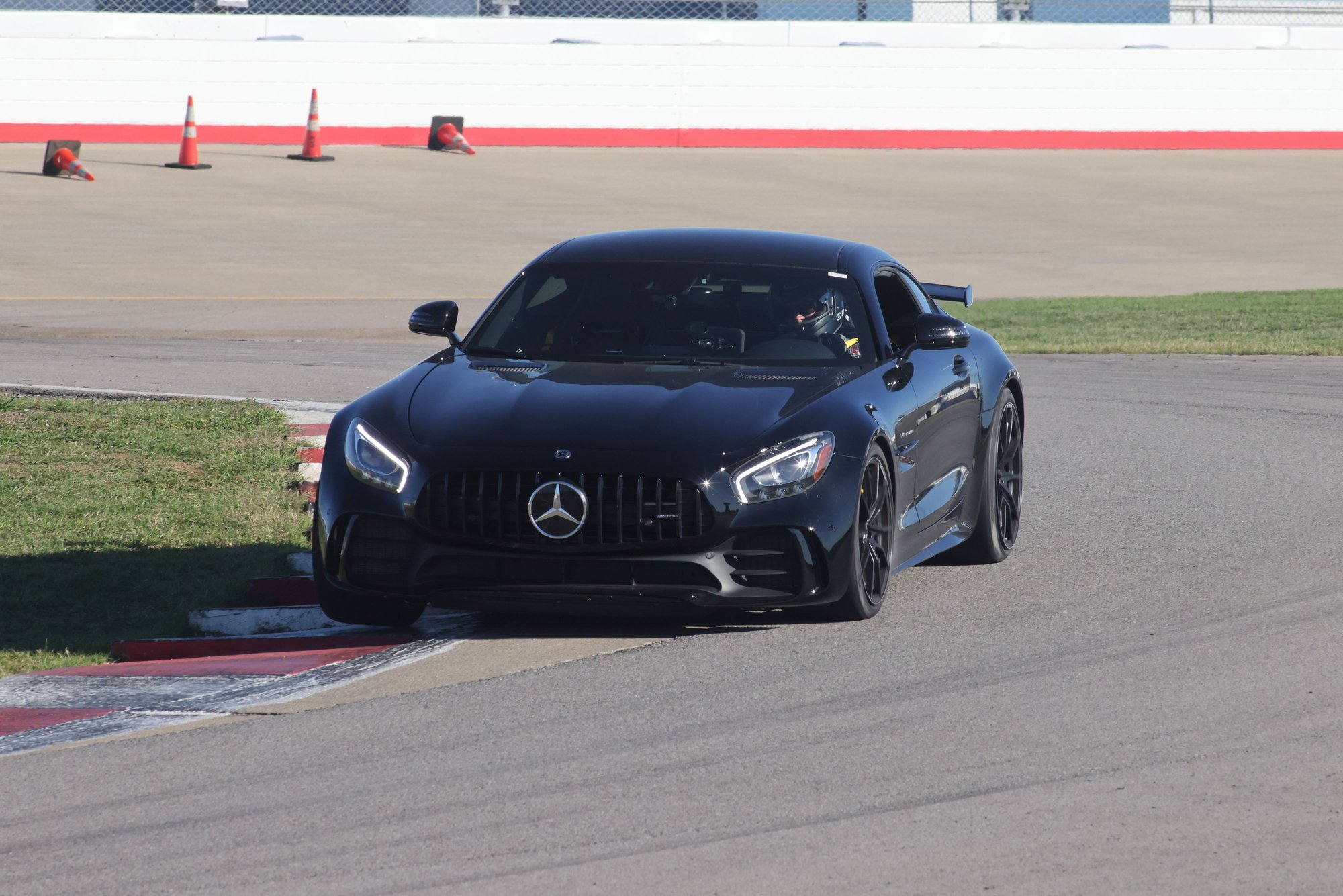

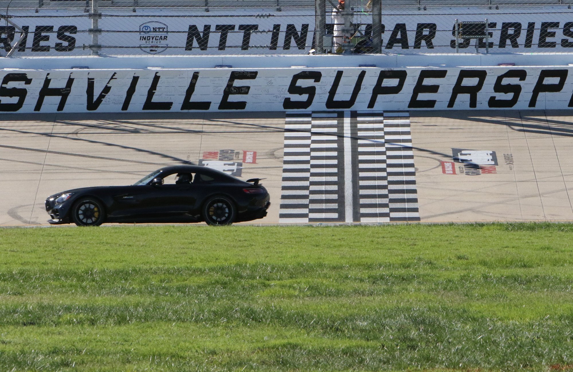

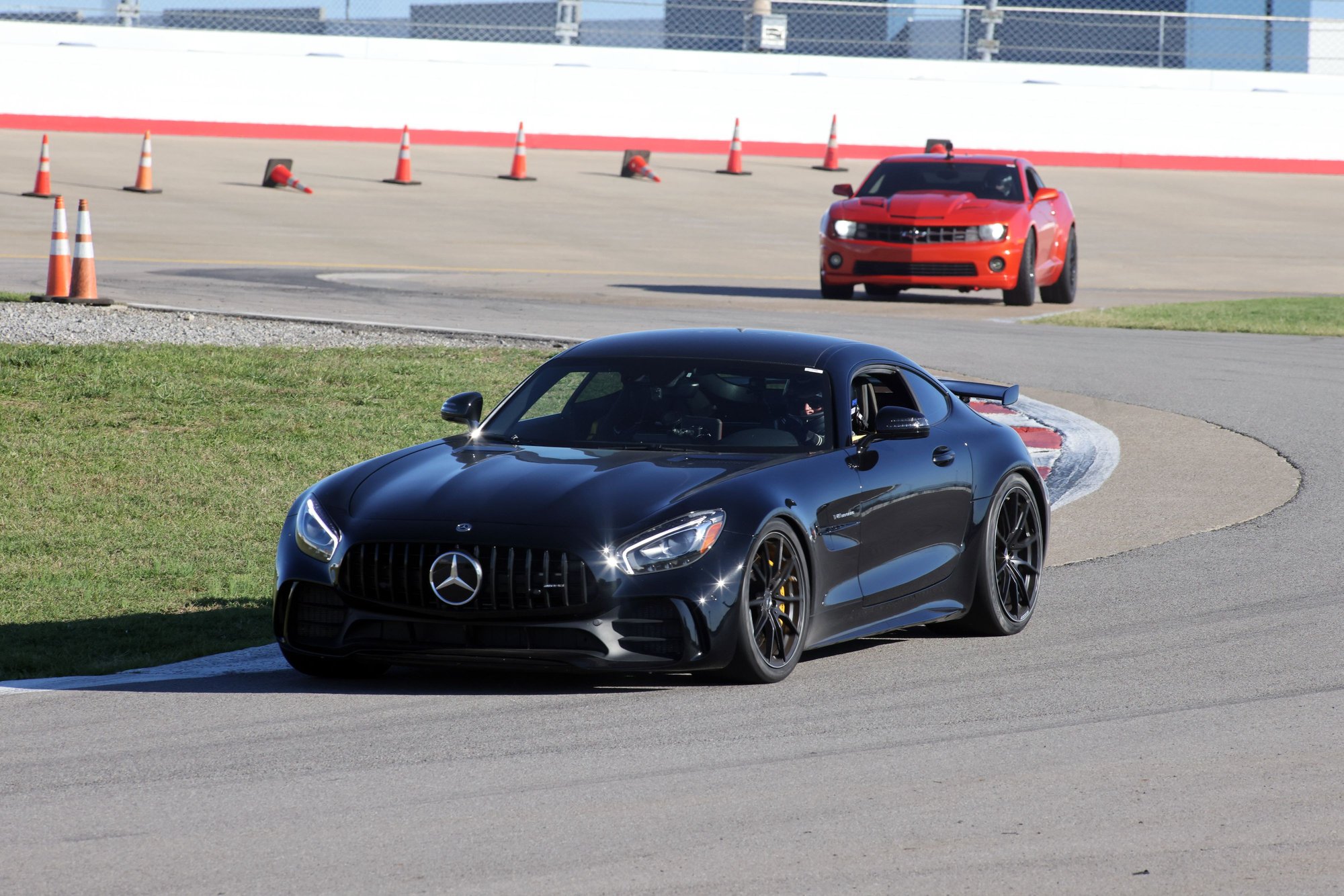

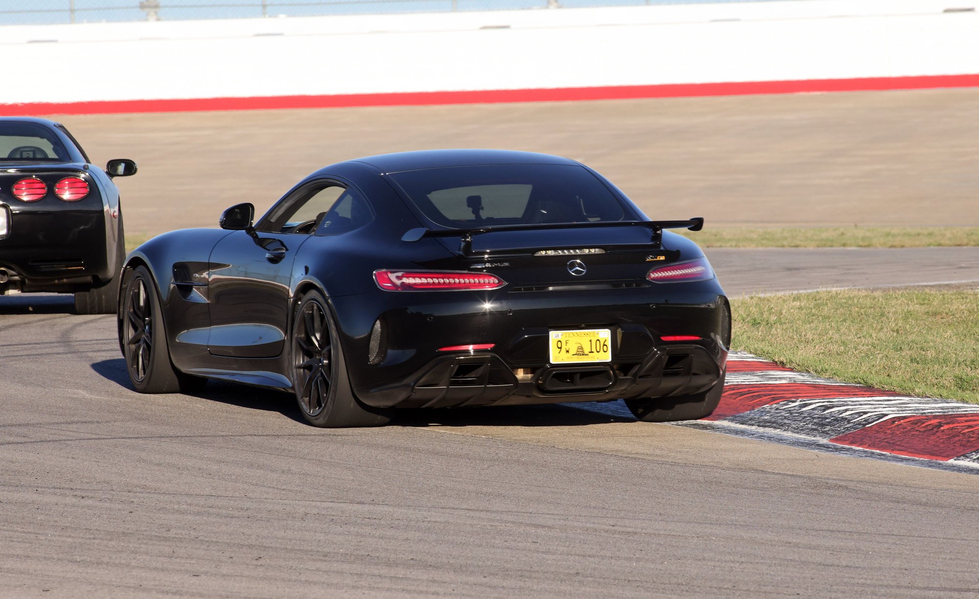

NSS Pics
600whp camaro, np.
Miata in the twisties, np.
On the menu, C5.
Glamour shots
