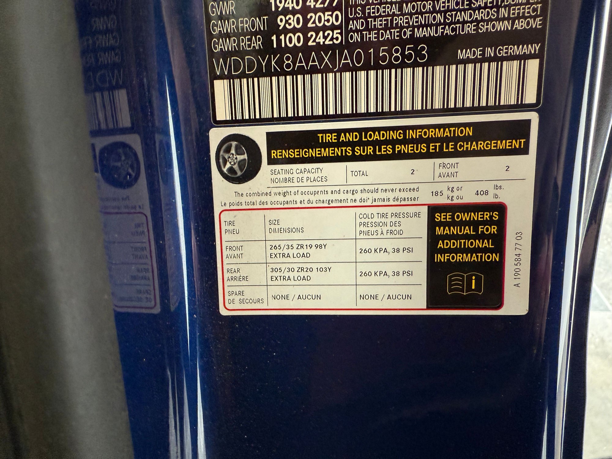

so reading this in the inside of Dohr jam of the car 38 psi all around. Any other thoughts or experience?
not the door jam. Open up the fuel cap as if you were pumping gas and follow the sticker there. Itll give you different options depending on load and speed.
https://cimg1.ibsrv.net/gimg/www.mbworld.org-vbulletin/1297x975/img_2805_e6b115b2da5d5d9e09492d939d4ed021d961f8ad. jpeg
As mentioned by another forum member, it is the pressures shown on the fuel door. I think only MB puts additional tire pressures on the fuel door? Minimal and Max load as well as autobahn speed pressures.

Old May 14, 2025 | 06:47 AM
pilota1's Avatar
Joined: Jun 2009
Posts: 32
Likes: 11
From: The FREE WORLD
1995 SL320- Good bye sweetheart, 2005 SL600 Hello gorgeous! 1995 Ferrari 355 GTS, 2006 BMW M6,
Thanks all
looks like 31 all around for sub 150 mph single occupant based on the fuel door sticker
tires were indeed over inflated. By the shop when replaced
