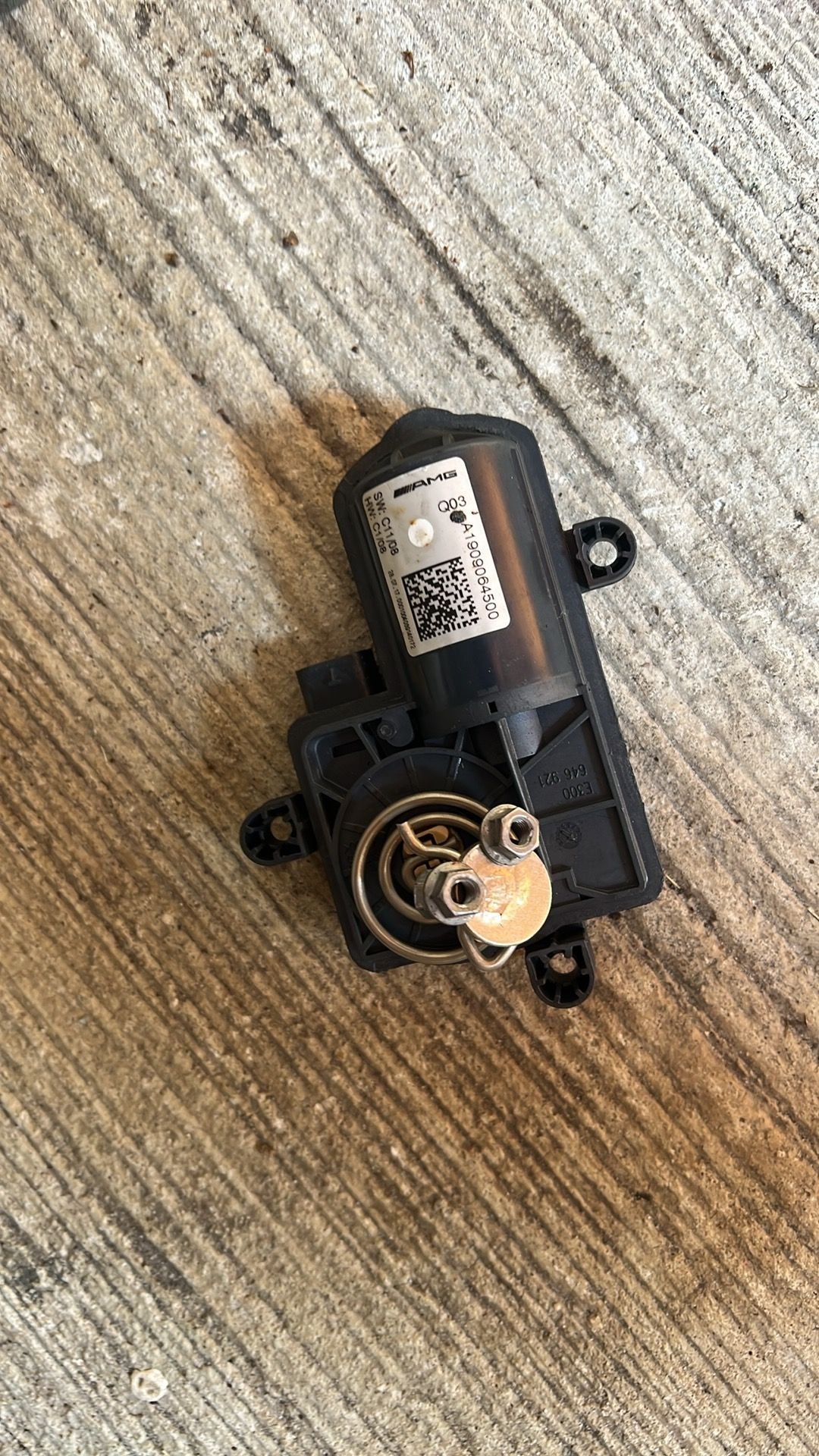

Time for exhaust actuator.
Got to he code and sure enough #2 actuator was barely moving. By hand valve is free, so ordered new actuator.
ps actuator has a magnet stuck to the spring with the nuts that hold on actuator.
you do have to remove rear bottom panel and loosen exhaust hangers so you can pull down system an inch to get access to nuts for actuator.

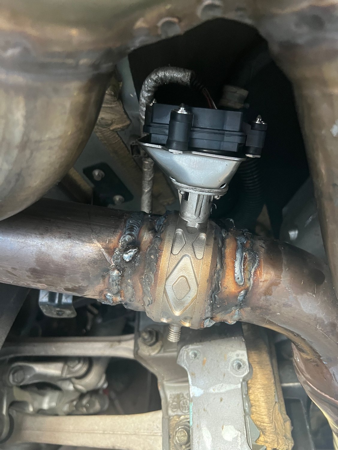

Old Feb 22, 2026 | 06:51 PM
silvergs's Avatar
Joined: Nov 2012
Posts: 38
Likes: 16
From: SoCal
AMG GTs
Originally Posted by knowbenz
got it, I found some 2.5" on EBay, I just have to verify size of pipe and mount for motor. The replacement muffler is almost $6k last I checked so welding in an aftermarket unit is fine with me
hey bro hope this helps.
I purchased beefy ones because I only want to do this once
https://thermalrd.com/search?q=helic...prefix%5D=last
cost 250 a pop and let me tell you, you can feel the smoothness, quality and beefiness
simple cut and weld
not the cleanest weld job but here
