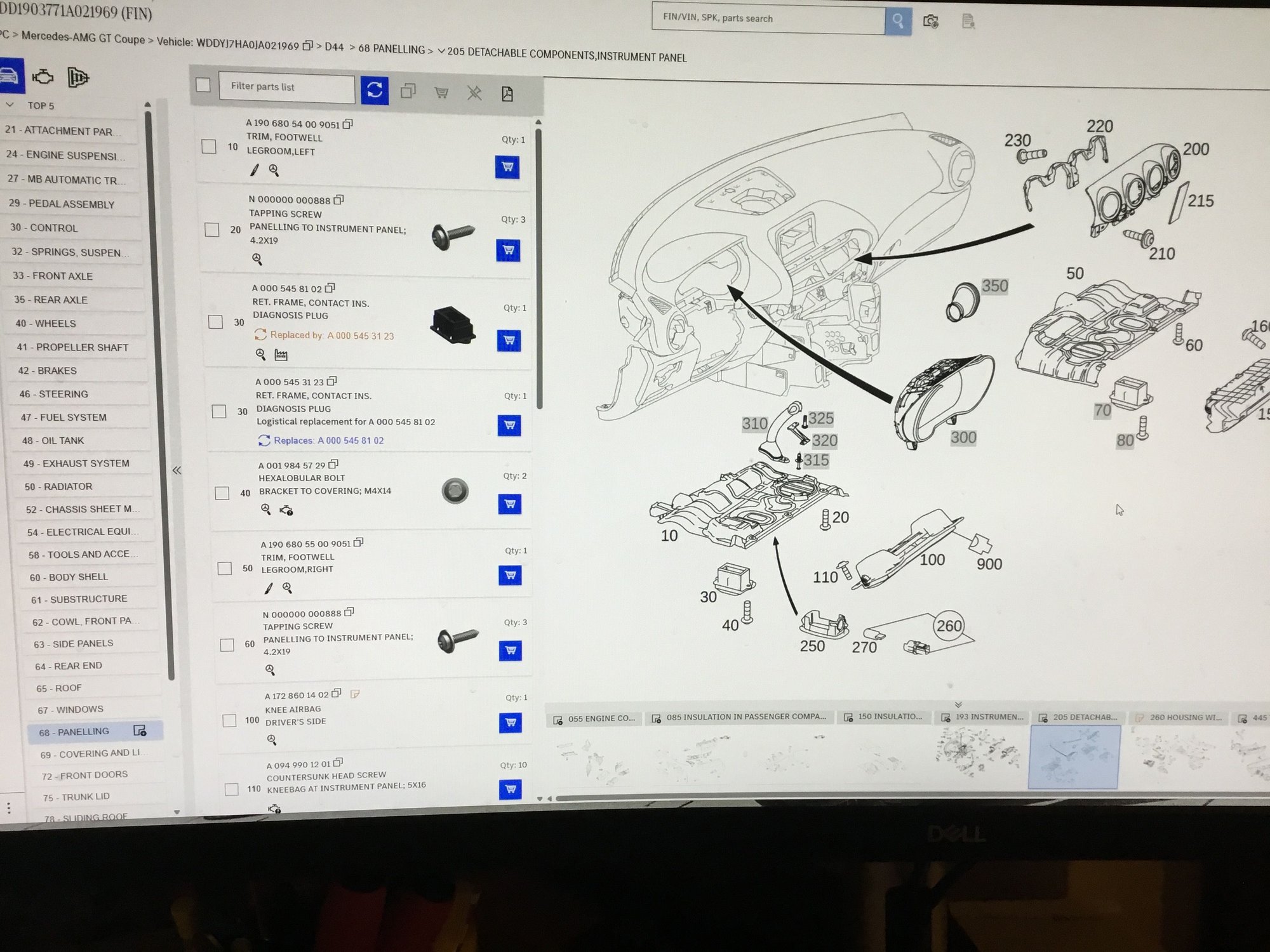

I think you’re looking for this one below. It’s a service offered by Daimler and it’s $98/year. It is very good because it’s MBs and you get all you had on the BMW. Now how to get to it is a different story. Like any German developed software it is counterintuitive and user unfriendly. Every year when I have to renew it takes a lot to get it. I’ll paste from their email maybe that will help.
Welcome to ISP Portal.
Below is your subscription information to the site: User ID: xxxxxxxxx Subscriptions:ISPPI / 1 - Year Access / $98.00
Email: You can log on to the site by visiting - www.startekinfo.com - and entering your user id and password. Send any inquiries using Contact Us under the About Site tab or e-mail startekinfo@mbusa.com

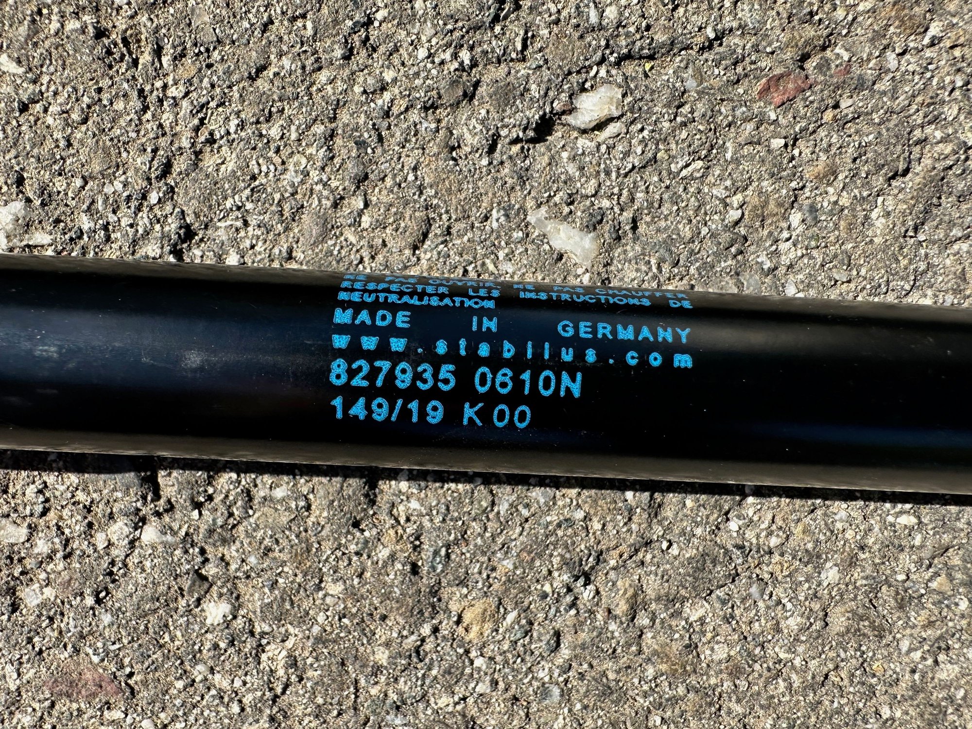

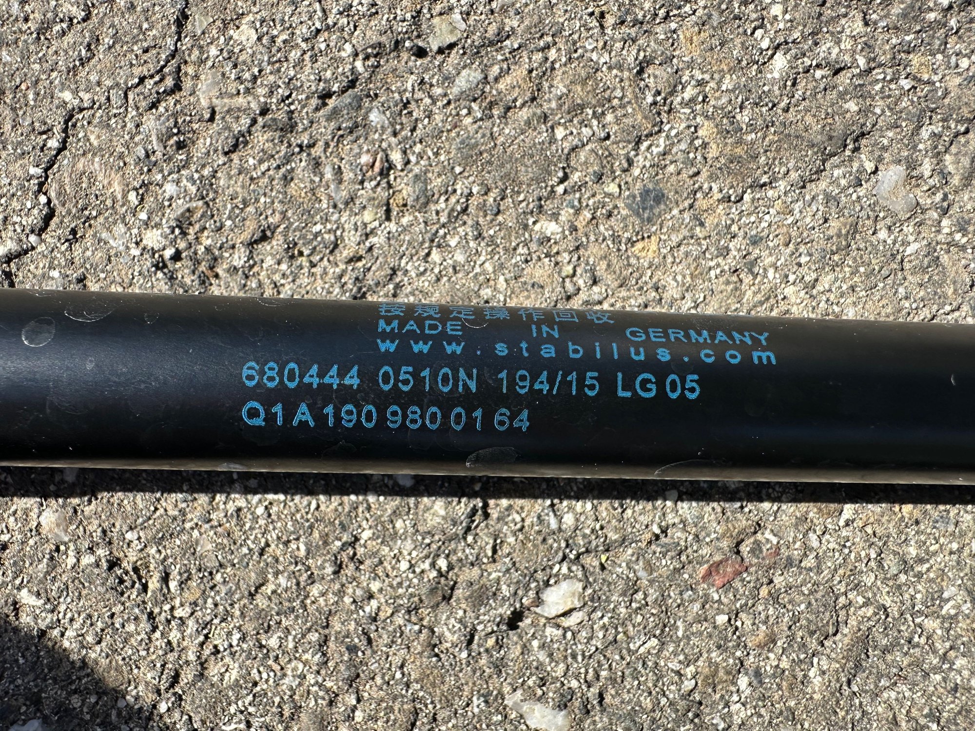

Curious - what was the force rating in "N" of the Original OEM struts, vs the Upgraded Replacements?
Old Aug 25, 2025 | 11:10 PM
mws's Avatar
mws
Joined: Sep 2023
Posts: 77
McLaren 720S Performance, 2016 Mercedes AMG GTS
Originally Posted by MBNRG
Good Job , OP
thanks for your responses and encouragement. Here is before (510) and after (610)
Old =510N
Old =510N
New = 610N
New = 610N
