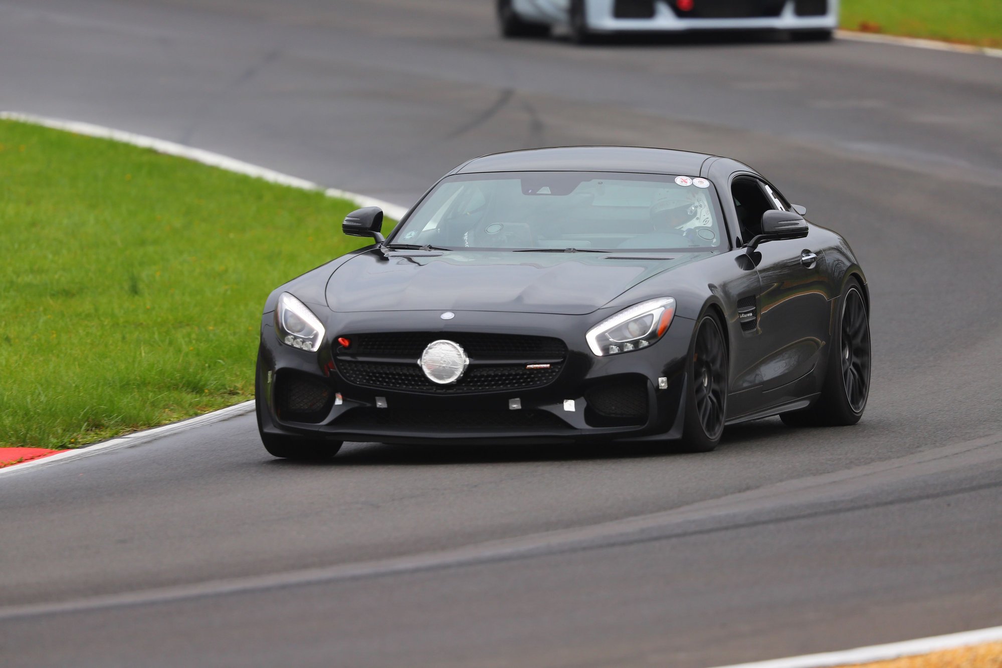

Like this……
Like this……

I'd definitely prefer coding it out than sticking that on the car every track day. Doesn't solve the seatbelt tightening and trying to choke me either

Actually it does. On a base GT you can’t fully defeat the accident avoidance system. Damn lawyers. The auto-braking and seatbelt grab are triggered together.
