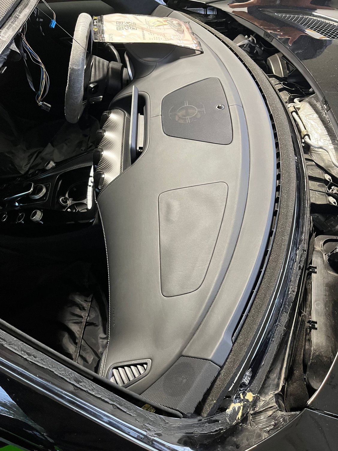

Dashboard Bubble Issue
I know that this is a known issue and was covered under Mercedes warranty, back in the day. Unfortunately with my car being a 2019 AMG GTR, the days of warranty coverage are long gone.
My car is at a shop for a windshield replacement and with the windshield removed, I got a good look at the dash. Breaks my heart to see the leather bubbling like this on a $180k+ MSRP car.
I spoke to two local upholstery shops and they both suggested replacement. I’m super attentive to detail and a repair job will never look perfect.
Has anyone gone through this? Anything that I should be mindful of? Seems like a pretty large effort and I’m wondering if it’s worth the hassle. I know that with some repairs, it is impossible to reassemble everything back as it was from factory. Hoping that it is not the case with a dash replacement.

Oh no thats a bummer! Mercedes should fix that out of embarrassment but knowing them, they will say this is regular wear and tear!!
out of curiosity, is your car parked in the sun a lot or is this just a case of the glue giving up?
anyway, try this: https://mbworld.org/forums/s-class-w...on-repair.html

While the windshield is out, penetrate the bubble from the windshield side with a hypodermic needle and the proper super glue. Plenty of upholstery videos online. There also a recent thread on a leather bubble being repaired but in something perforated. Hitting it with a heat gun can also help but I would not do that until after gluing. Tip: before removing the needle from the leather, pull back on the plunger of the syringe so no glue drips, and immediate clean the area if you get glue on the leather. 91% iso immediately...but be careful with that around plastic. And if you use acetone, test it out before using it, as it depends on the leather finish, Nappa or coated, or synthetic.

I always keep it in a garage, even when I go out I park in a garage when its an option. Not sure how this happened. Maybe my car got used to being in CA and didn't like the weather and/or humidity change when I brought it over to DC?
Thanks for sharing the article. I wonder if its possible to do without perforations to insert the needle. Seems scary

It has nothing to do with where the car is or anything youve done, but that the glue used is subpar. These cars and materials are supposed to be tested in extreme conditions representing the far north, to the desert. One would think that Mercedes understands leather shrinkage but perhaps thats why they continue to downgrade their materials is nearly every model to exclude high end finishes and quality leather. It's not as though we are talking about a car that is 30 years old so any excuses or comparisons to other brands that do this is really a moot point as it only exemplifies the current poor choices of other brands as well.

Alas, it has Nothing to do with Mercedes brand - this problem of Dash dehiscence/delamination and bubbling occurs in several other high end Vehicles/Makes, from Audi R8 (notorious), to certain Porsches, to Lambos, and even some Ferraris, etc etc
The common denominators appear to be smooth leather and adhesive failure over time, +/- accelerated failure from exposure to elements, etc
OP: If the localized repair via syringe needle + glue is unsatisfactory, another feasible and aesthetic solution is to cover dash instead with Alcantara, as previously and successfully done by other forum members here or on the Facebook group

I am able to find the dash for $4k ($2k discount off its $6k MSRP), but the shop where my car is will only take on the dash replacement job if they order the part themselves. On top of that, they’re quoting 8–10 hours of labor, which feels hard to justify.
I came across this video on YouTube, where they removed the dash without removing the windshield:
So maybe I don’t necessarily have to get it done now while the windshield is off.

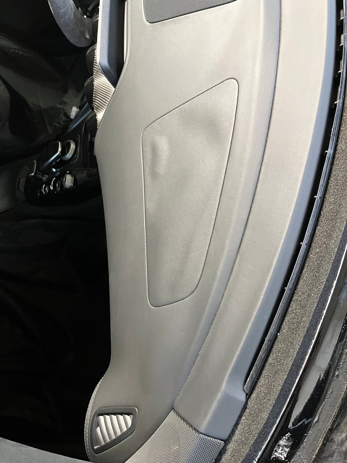

Just found this thread. I have a 2019 GTC that has a bubble by the gauge cluster area. Really hope it doesn’t spread. Maybe we write to Mercedes Benz - I’m down to start an email chain until they buckle lol

Is the bubbling only on the airbag? It’s difficult to see in the picture.
