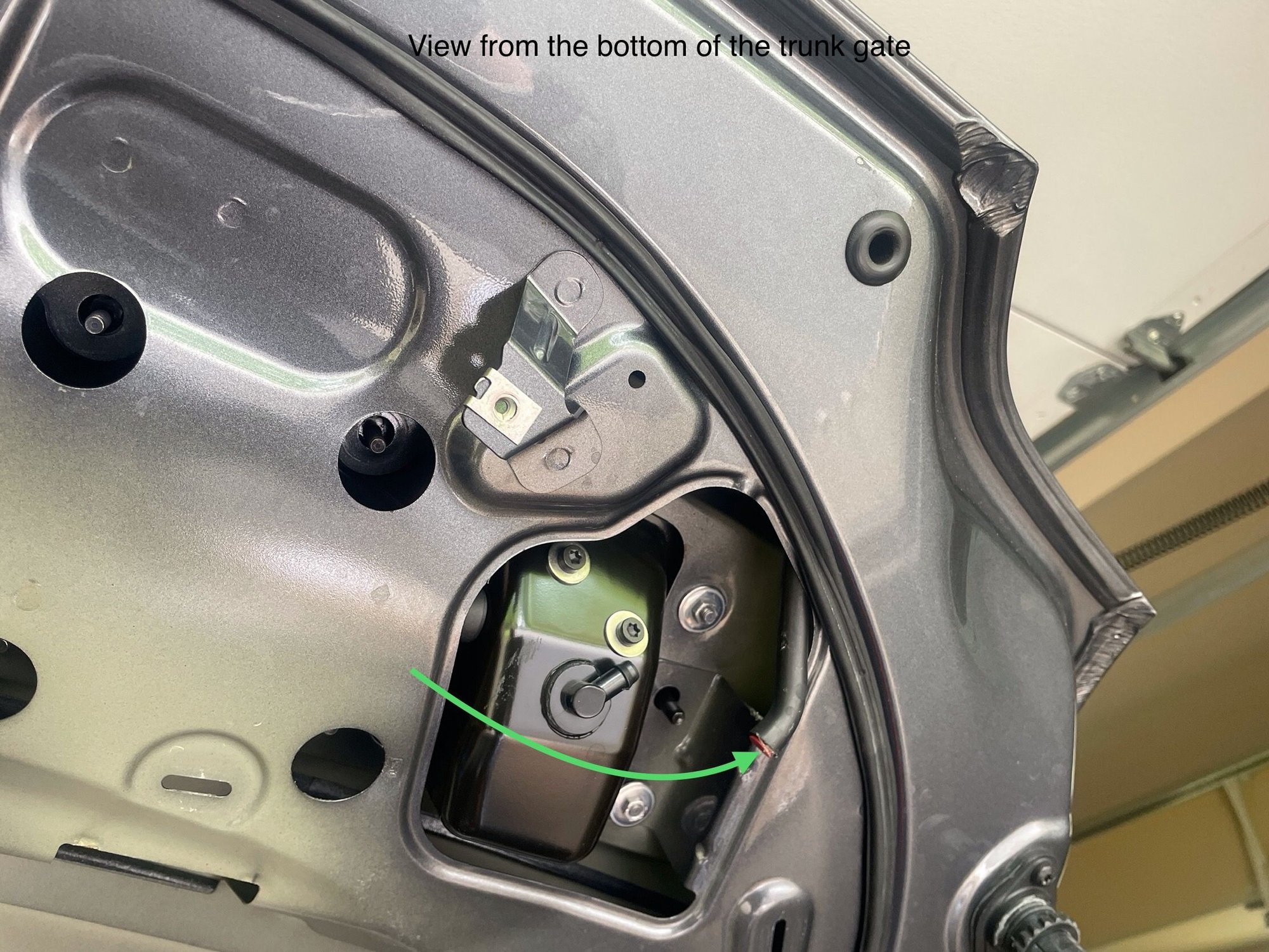

There are two black rubber drain hoses located at the base of the active rear wing. If the active wing assembly is removed and replaced with a fixed wing, these drain openings must be properly sealed.
Otherwise, rainwater flowing around the perimeter of the wing area can enter through these drains and leak into the trunk compartment.
The 2 pictures above show the 2 black drain pipes connected to the original active rear wing,
You will have to "plug" seal these drain pipes as shown in the pictures below:
