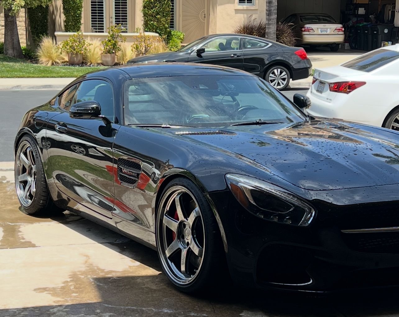

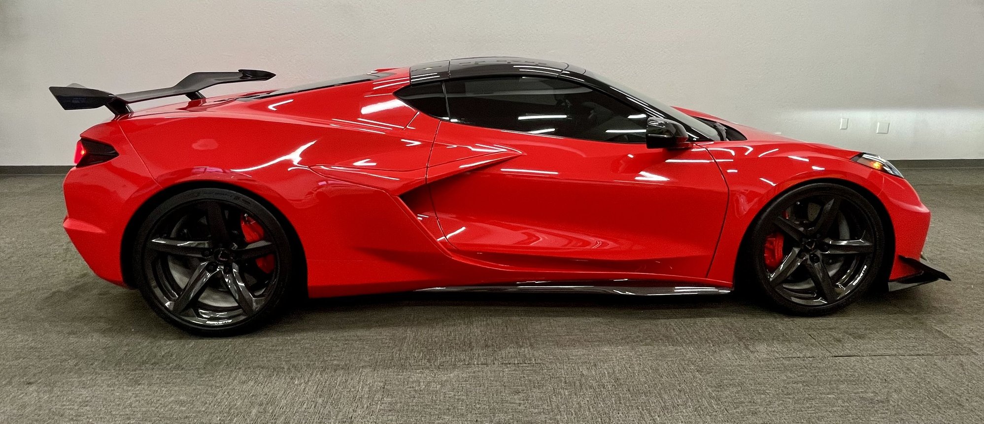

It seems the specs I found work well, according to several threads (and one guy who swears by fitment and included pics of multiple cars) but "flush" is also a bit subjective. To be safe, I'll just back it off a couple (or a few) ET's and call it a day. They will be flush enough.
My C8 Z06/Z07 car with carbon wheels are sunken in on the rear (no spacer solutions available at all) and after lowering, they don't bother me. A few ET's conservative on the GT-S won't likely bother me either.
Pic for effect.

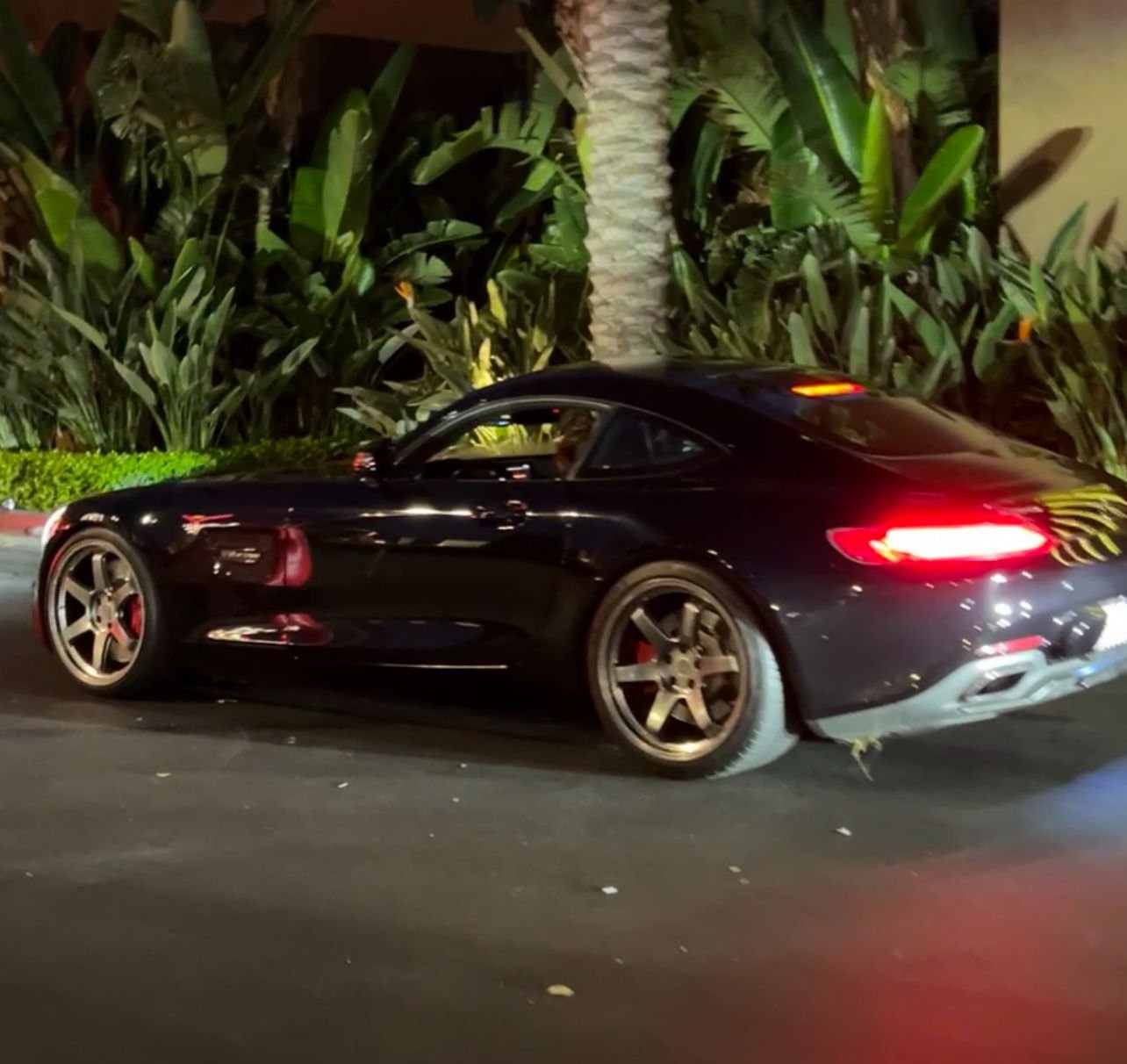

Nice car! Everyone has different definitions of “flush”
just wanted to share my specs so you have something to considered. Many will say I’m on the aggressive side. I had zero rubbing ( I say had bc I since have added 5mm all around).
im running
20x10 et 47
20x12 et 60
I have since then added 5mm all around and only experience running in the rear when i hit big dips. I hope this helps
