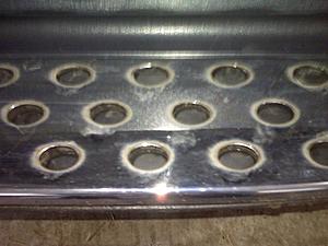

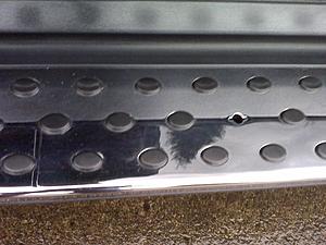

The boards are cleaned-- here's how I did it.
1) remove 5 screws at bottom of RB. This will separate (but cannot remove) the stainless from the board frame.
2) gently pull upward on the outside of the stainless plate and push the rubber knobs down through the stainless. The knobs are on a 3-4 pc molded 'grid' below the stainless.
3)after all the knobs are below the surface of the stainless you can easily clean and dirt away from around the knobs.
4) once cleaned, reverse the procedure.
The first pic shows 'before' with the knobs pushed below the plate surface. The second pic shows the cleaned plate and knobs pushed back up. Note the hole in second pic; that is where the replaceable knob that holds the screw.
